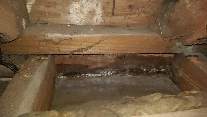

The water stained timber in the pics - can you probe it to see if its merely stained or actually rotting?
Thanks Ree.
I'll post a sketch in a bit, but basically that pick is taken in the loft where the floor of the loft meets the chimney, right down in the corner of the eaves. The joist isn't rotting, and as you can see from the pics the water appears to have risen through it from below.

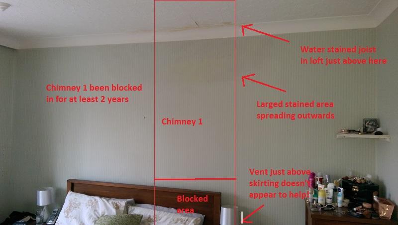

Annoted photo showing blocked chimney 1, the worst one that's been blocked for at least 2 years and getting worse despite being vented at bottom.
Has the chimney breast been removed or is it on the outside of the house, how big is the chimney and what type of brick.
No, chimney breasts haven't been removed. They're visible (jut out) on the side of the house. I think they serve the downstairs fireplaces (which are deeper) and the chimneys for the upstairs fireplaces are basically in the wall cavity?

Nothing is going to "stop the damp in its tracks" given that its soaked into brickwork and plaster. The first thing to do is find the cause(s) of the damp.
Roofers dont usually leave a "mish mash" of terminals on the stack. The next person to examine (or work on) the stack and its flashings should take before and after pics.
You suspect sulpherisation, & it might be happening due to nothing worse than bad ventilation but there might also be water entering the flues thro the stack areas.
As i said above, all flues must be swept. The flues can be opened for sweeping from outside, & the brickwork made good. Its also usually good practice to remove all contaminated plaster, and render back up in sand and cement.
External chimney breasts are notoriously exposed to damp and flue gas cooling. Perhaps examine the pointing on your c/b's?

Properly decommissioning the chimneys involves capping the stacks off or installing a top hat over the pot to prevent rainwater ingress. You must then ensure that a robust through flow of air is maintained from top to bottom by installing a double air brick at the external foot of the stack and another at the head of the stack, if you capped it of rather than installed a top hat. Chimney flues are lined with hygroscopic salts that will continue to draw moisture in to the masonry, which is why the ongoing air flow is required. When you say there is already a vent, where is it and what size is it? A common mistake is to vent the head of the chimney but not the foot.
I can't quite make up my mind where the gutter is. If the stack has been properly refurbished, then it should be watertight. So that leaves the external stack which could be letting water. Also if the stack is on the eaves side of the roof, the gutter should be kinked around the outstanding stack. There is not a leaking joint here, is there?, because there will be loads of joints! Or if the gutter is stopped/started here then the soakers/flashing must be made of properly into the gutter.
