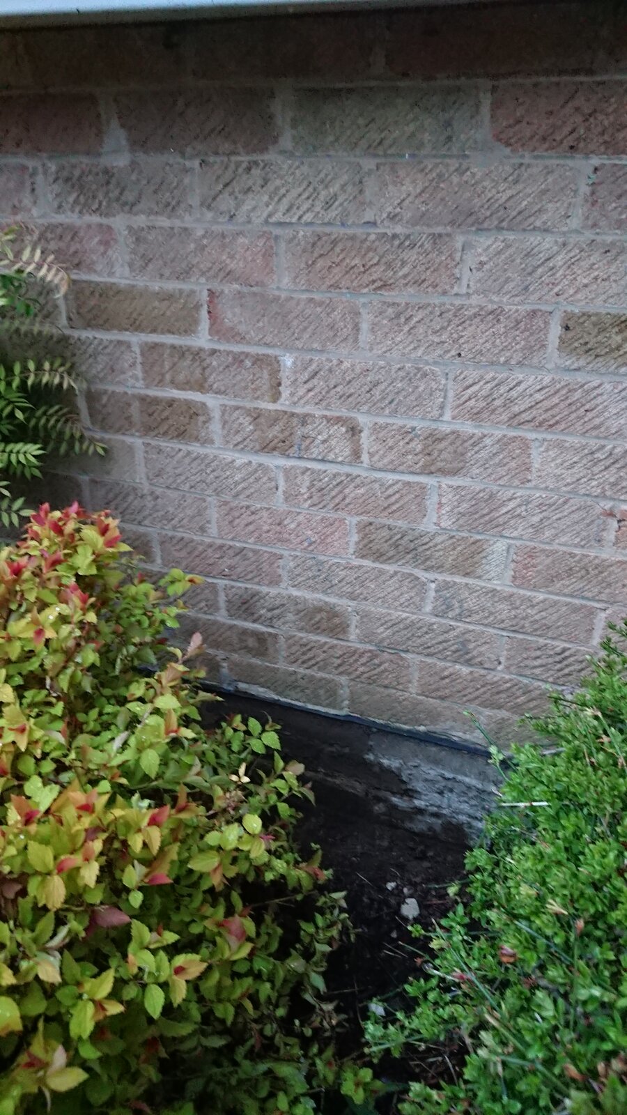

Please can anyone tell me why these bricks beside the airbrick always appear wet and whether I should be concerned and what I should do. Last year wasps nested in or behind the airbrick and there was no problem before that (not sure if this is coincidence). Thank you so much for any advice!
The wet bricks are subject to rising damp because they are below the DPC.
Your DPC is just above the air brick.
In good practice the air brick should be above the DPC.
A pic showing more of the wall elevation would help?
Do you have any damp issues on the inside of that wall?
All air bricks should be clear to provide ventilation - the wasps are irrelevant.
I have taken a picture of the wall, I'm not sure if it's what you meant, sorry! It is below the level of the inside floorboards so no damp in the rooms. Should I ask a builder to put airbricks a bit higher? I think the house was built in the 70s? Why do you think it has started doing this after all these years.

Thanks for the pic.
I needed a reference point for your FFL and the position of the joists.
google pics esp section views of air bricks and DPC's in a cavity wall to get a rough idea.
You have a cavity wall which, unless the cavity is blocked and bridged with debris, will protect your inside flooring and joists.
But a clean cavity will only protect the interior from damp if the inner wall has its DPC in the correct position - which, given your "no damp in the rooms", should be fine.
Essentially, it appears that you are good to go & forget about DPC's & damp.
No need to move the air bricks
