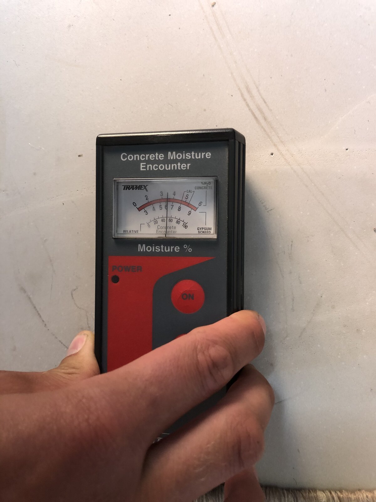

Hi all, we’ve recently moved into a new build. The developer latexed the floor about 4 weeks ago just before we moved in.
No here’s the problem, we had someone come today to measure up for LTV that we want fitted throughout the hallway and kitchen. He done a damp test which was reading between 2-4 all over. The guy said it’s very likely that the developer didn’t put any damp proof on the screws before laying the latex. He’s said we can’t have LVT as it’s very likely the latex will eventually pop due to the damp and will wreck the LVT.
We’re left with 2 options. 1, have sheet vinyl fitted instead or 2, pay to have all the latex removed and start again.
Does anyone know of any other ways we can fix this? For example, can we put damp proof onto the latex and then more latex down?
Thanks in advance.

What latex was used ? Was it a bag & bottle or bag and water mix
what date was the screed laid ?
If you Put vinyl down over a damp floor it will fail just like LVT would.

I’m not sure what latex was used tbh. The screed was laid around September last year.
The screed should be dry then.
That moisture meter is just a guide. You need to put a hydro box down for 48 hours.

The sand and cement screed will take approx 6 months to a year to dry enough for LVT. So most floorimg company’s put a moisture suppressant on top of the screed before the latex goes down. By putting it on top of the latex it could fail.
so either take risk , do ceramics, or grind off latex and start again.

It should be below 75%RH if laid September.
you need a proper moisture test doing With this
https://www.f-ball.com/f-talk/article/testing-testing-digital-hygrometer/
A way we used to do a test in the old days was get some visqueen sheet , plastic see through sheet will do.
tape it in the middle of your floor will duck tape and leave down for 24 hours.
Lift it up and if no droplets under it then the screed should be dry.

Will this method work above latex as well?
I’d say yes but it’s not 100% mate.
