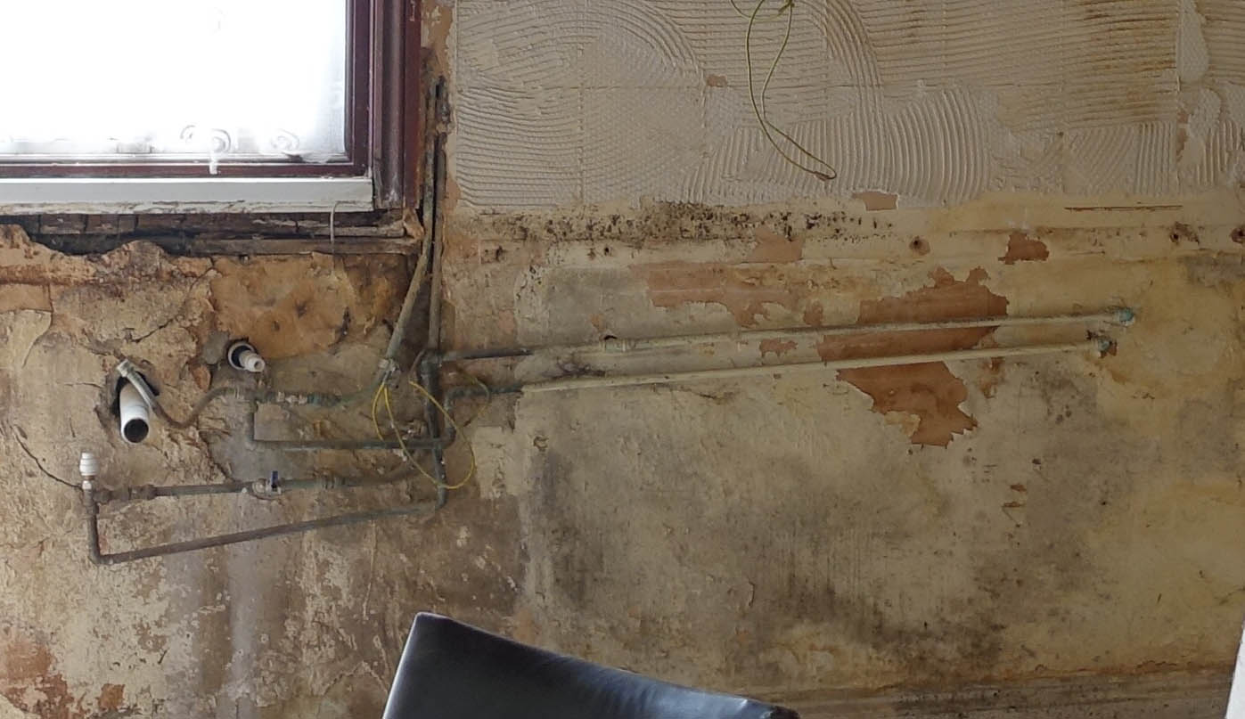

If there are any live water pipes to be found under that part of the floor/wall what would they be supplying - the supplies for the sink and the appliance(s) are drops from above.
You must pull out the W/M and examine the supplies & skirting and wall/floor near the W/M waste but I doubt that a waste leak is the problem?
Take pics and a pic of the outside gulley.
On the face of it, it seems more likely to be rising damp?

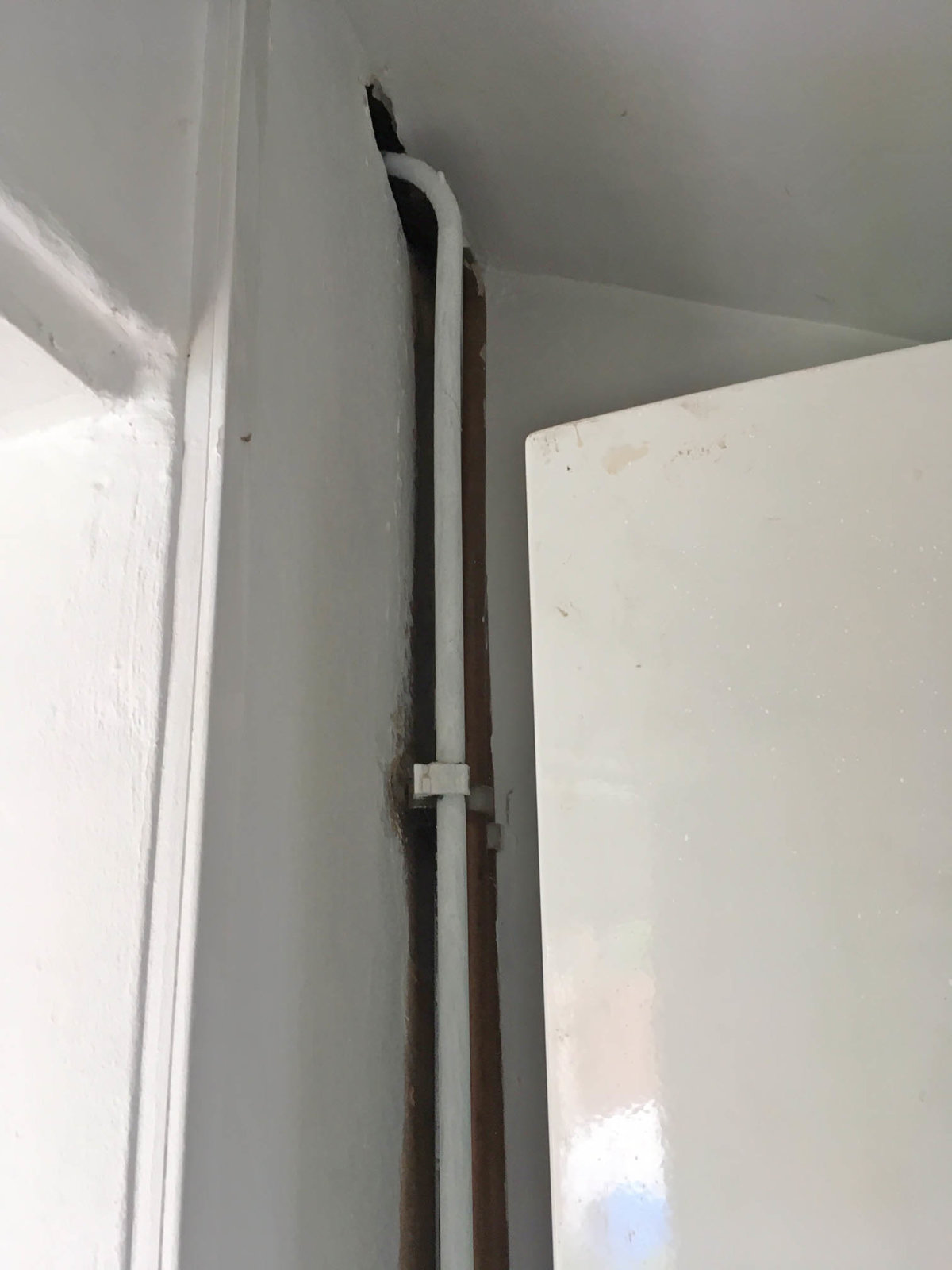

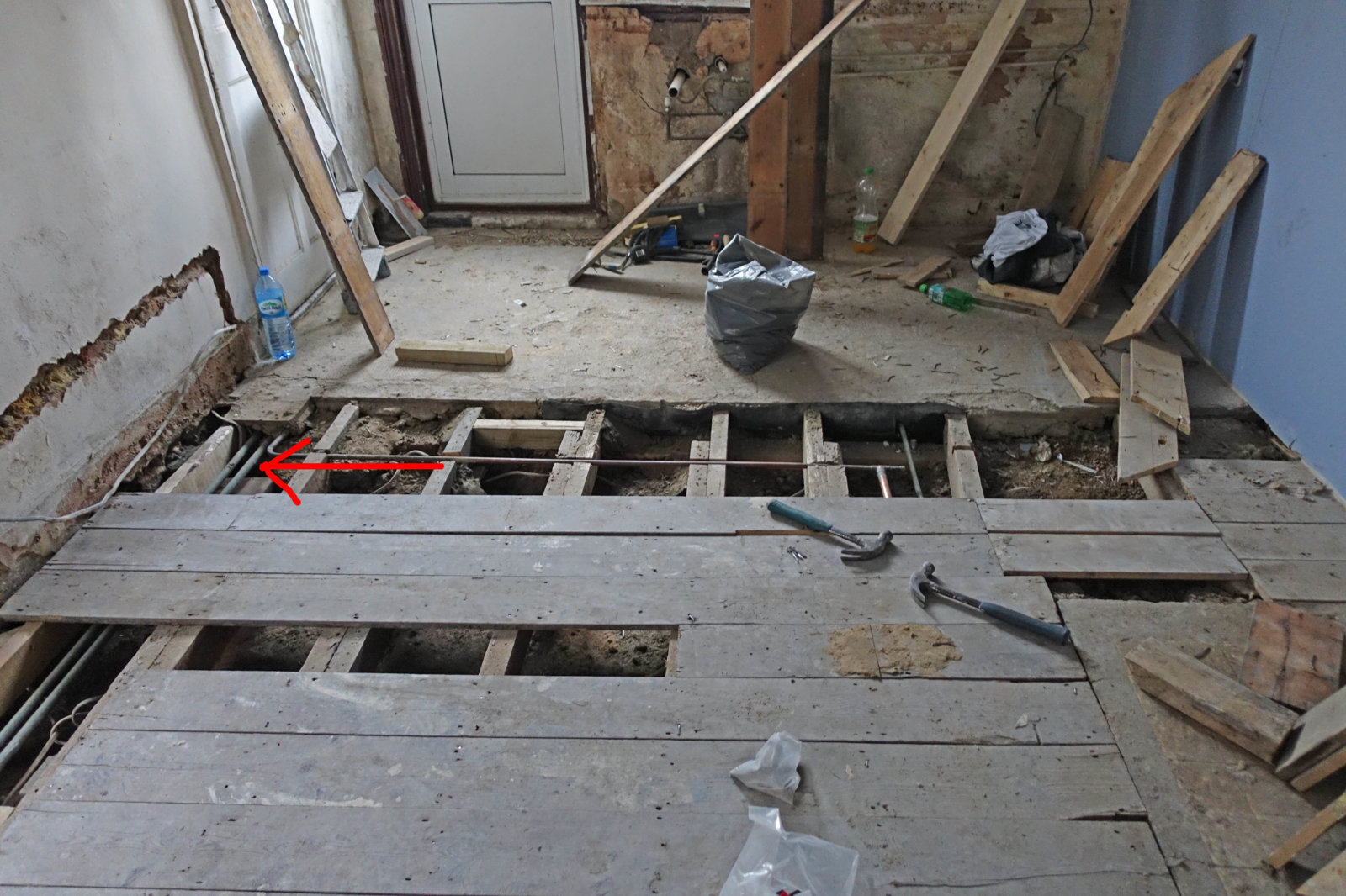

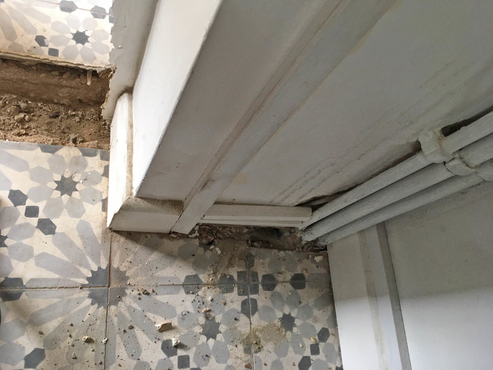

The main water supply comes in from the front, but then travels upwards in the wall between the lounge and the kitchen (in the middle of the house), supplying the upstairs bathroom. it runs above the kitchen ceiling and comes down in the corner of the little cupboard that I'm working on, to feed the boiler, which is housed in the cupboard.
It then goes directly into the floor, so you're right, it must be going underground from there to get to the kitchen area.

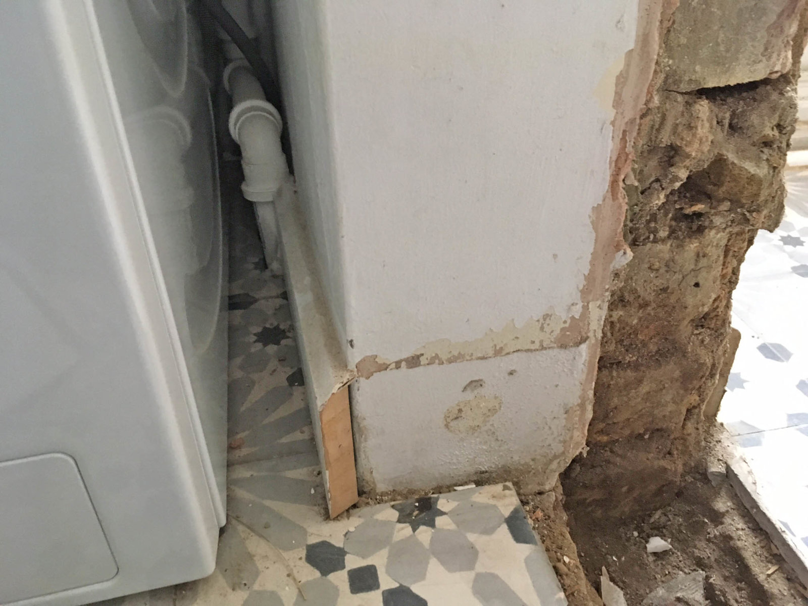

And the waste pipe in the floor is pushfit not solvent weld. ?
pipes going into the floor...
img_3728-jpg.124574

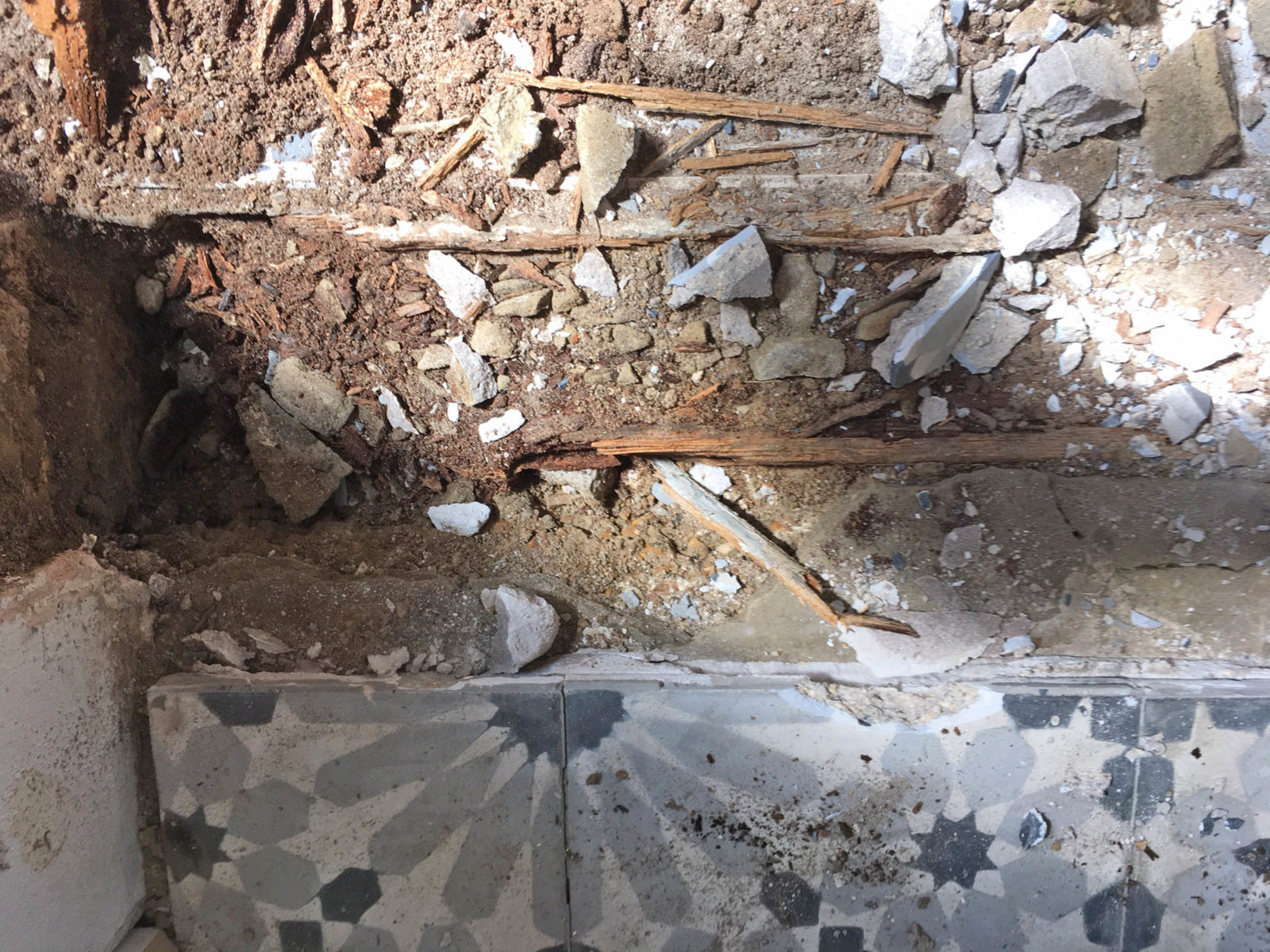

And on the left hand side, the lower brick is relatively dry at 21. A section of plasterboard is very wet here. but just round the corner, inside the cupboard, it is completely dry. Could this be moist because it was in contact with the wet piece of wood that I removed?
So, I do seem to have identified a wet area, which doesn't quite correspond to the washing machine waste, but could be from either a buried water supply pipe, or reasonably localised rising damp. Does this sound right?

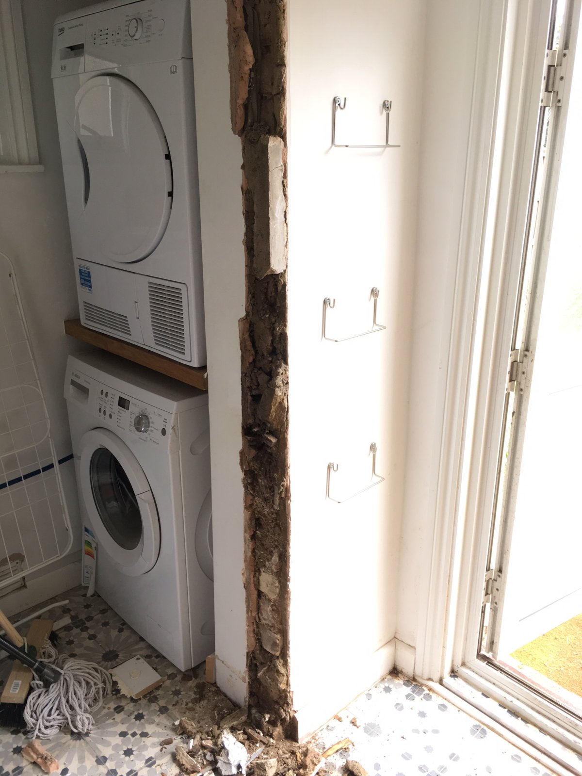

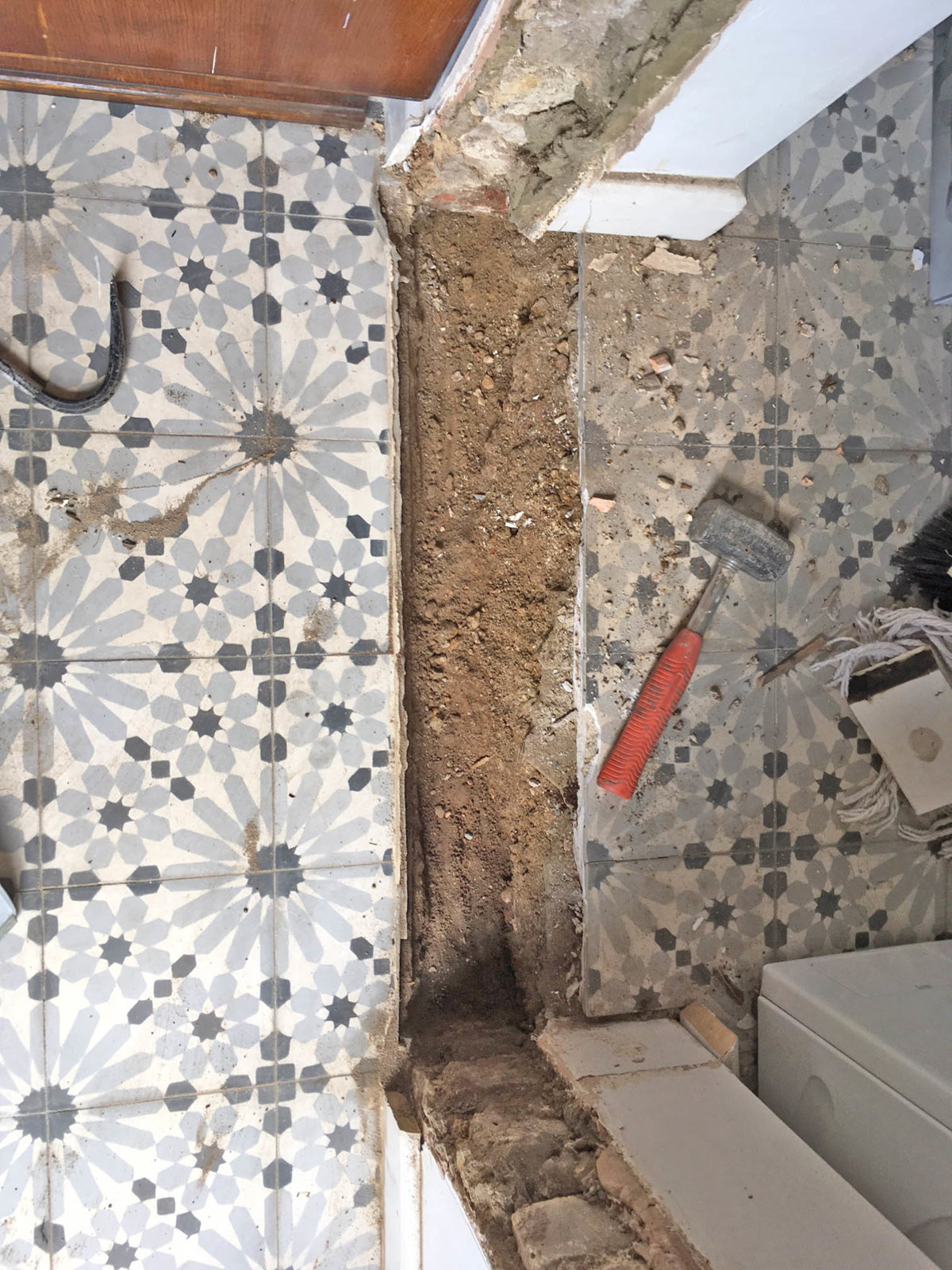

Hold on! I just did some more damp testing around the kitchen. The wall to the left of the cupboard is quite saturated. From my excavations I can see that this wall (which is mostly internal), on either side of the doorway, is sitting on brick foundations, with no damp course.
I think I might have to do an injection damp course as the first stage of treatment?

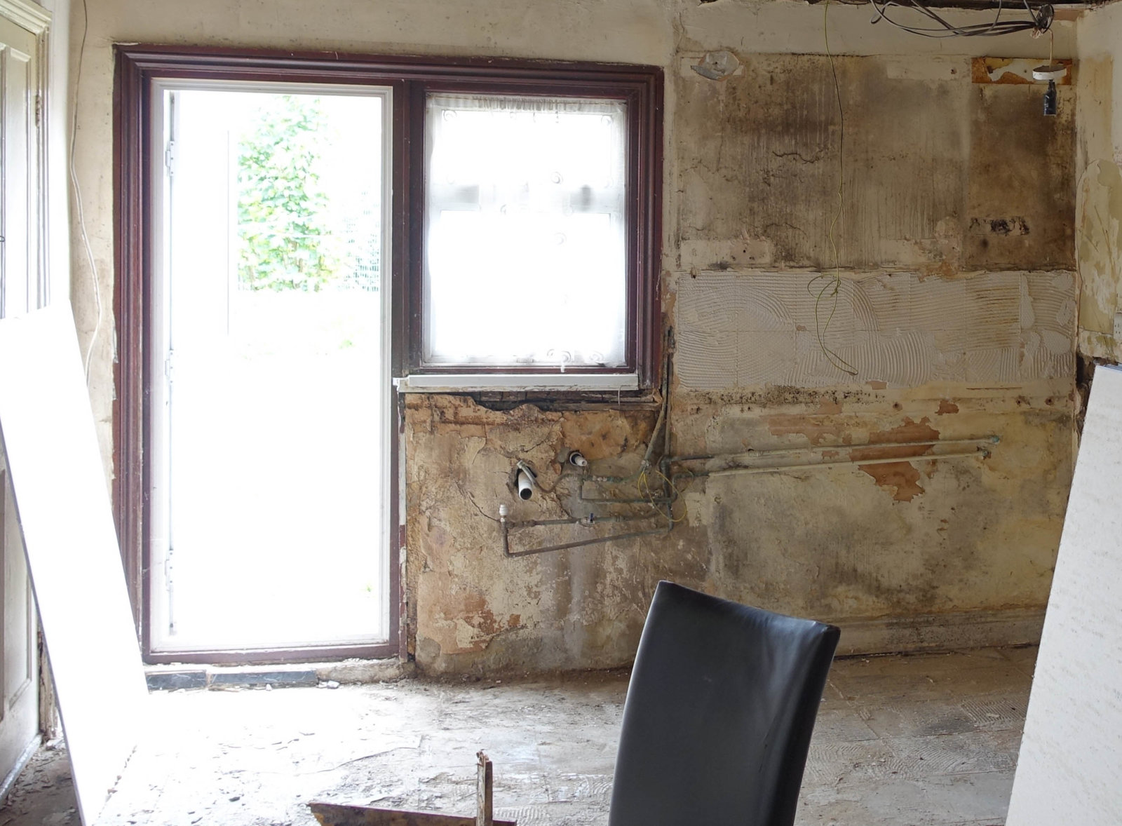

Don't get carried away with the damp meter. Especially With it being in a kitchen it's possible the damp is actually condensation due to the cold from the ground conducting through the bricks.
I found in our house we had damp on the walls in the lounge, internal masonry wall. When I took up the floor it was actually drier under the dpc.
In the end I got an ir thermometer and found that all the dark/damp areas were slightly cooler than the rest.
I had a plumber round who said its very unlikely to be from a leaking pipe , and recommends getting someone to put a membrane down. This is something I could probably do myself, before retiling and making a new door frame

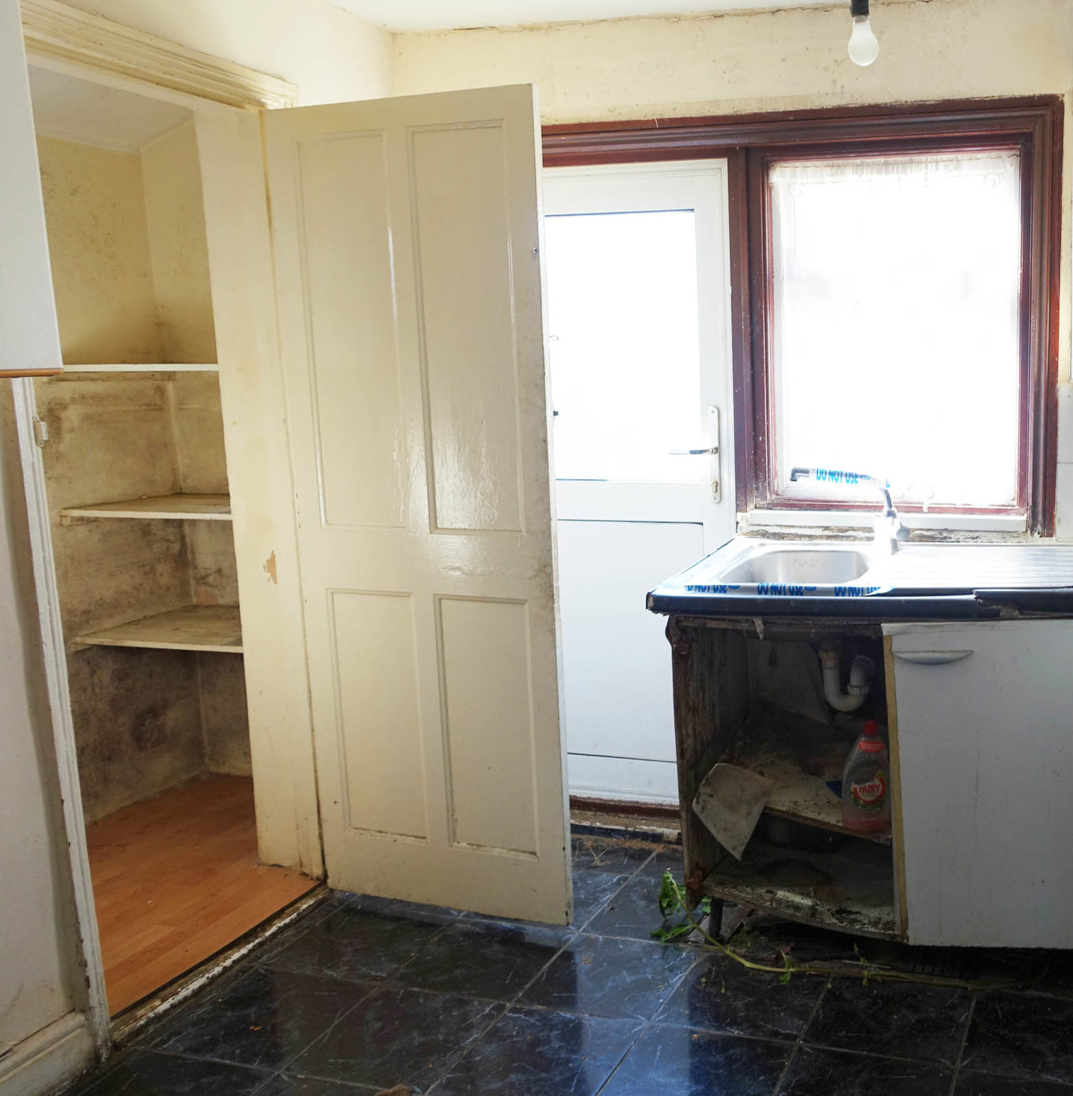

a wet patch in one corner of a kitchen.
close to some old pipes
what's the most likely cause?
