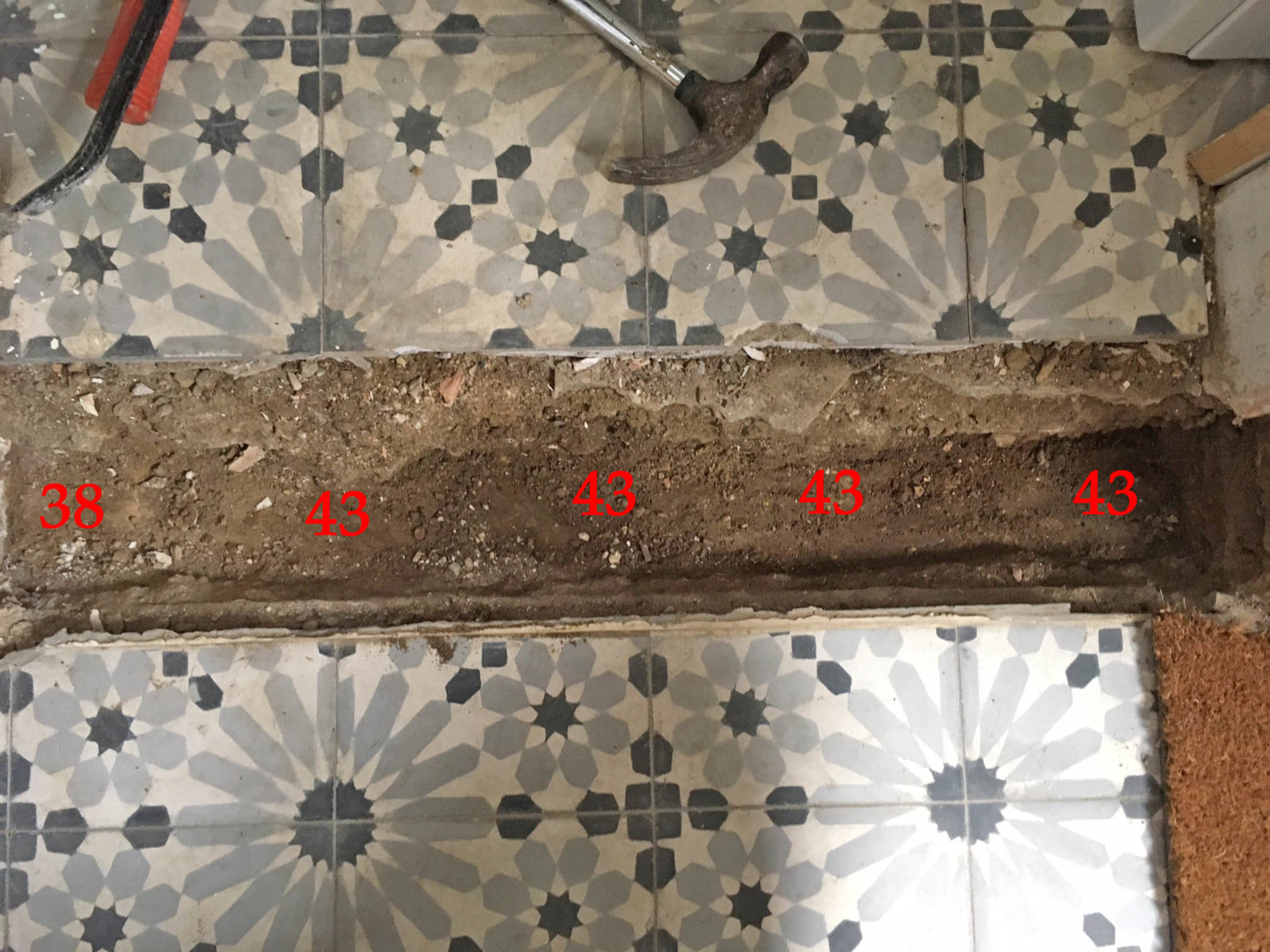

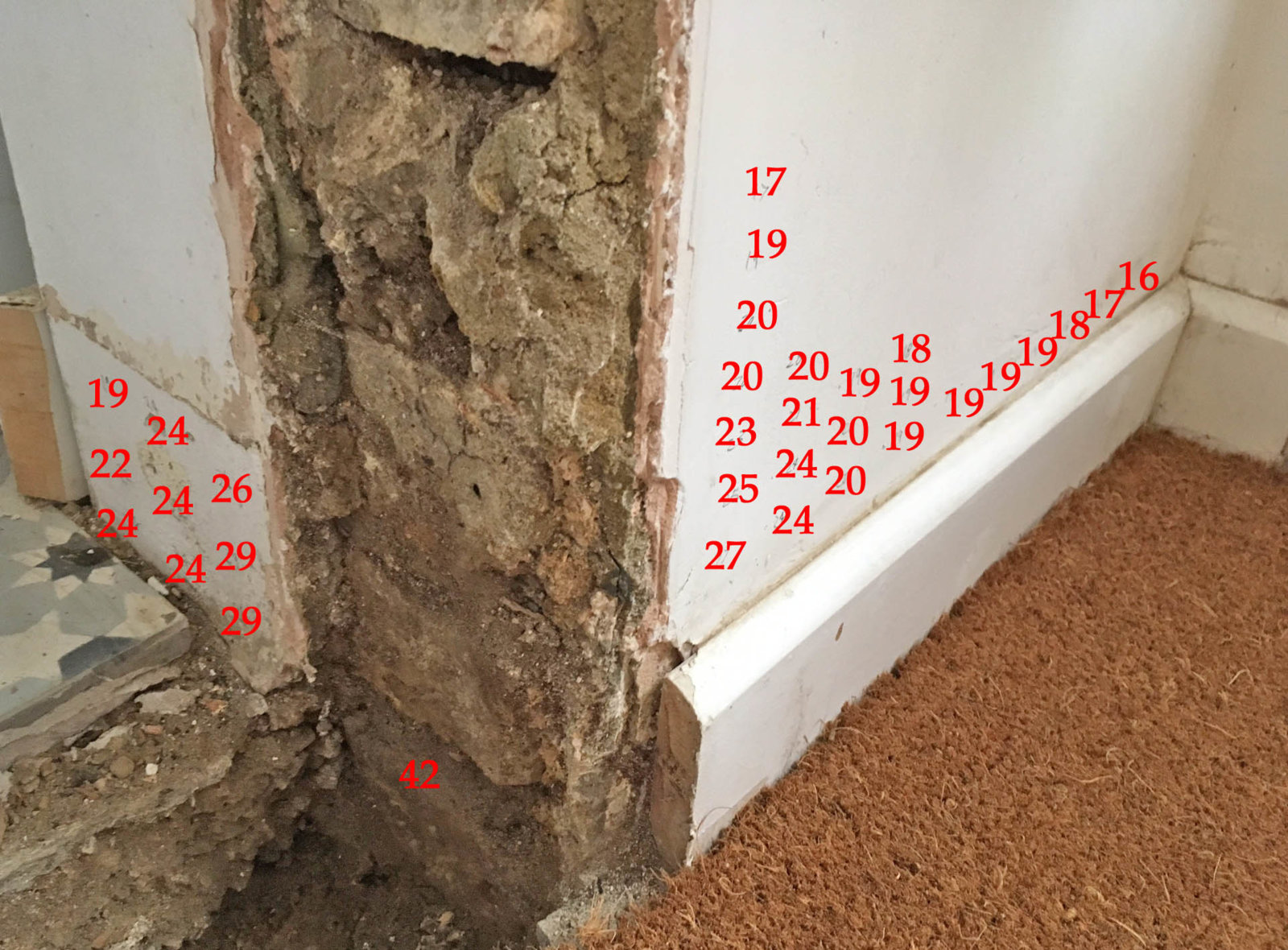

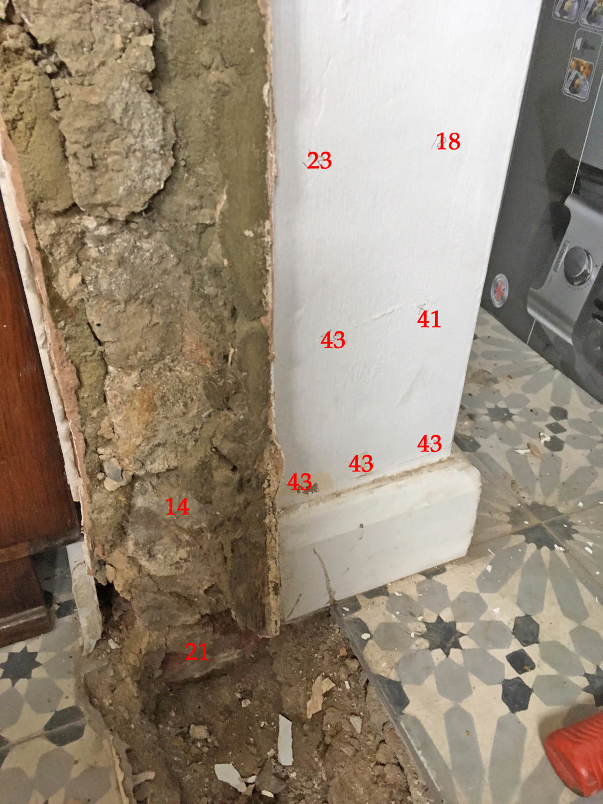

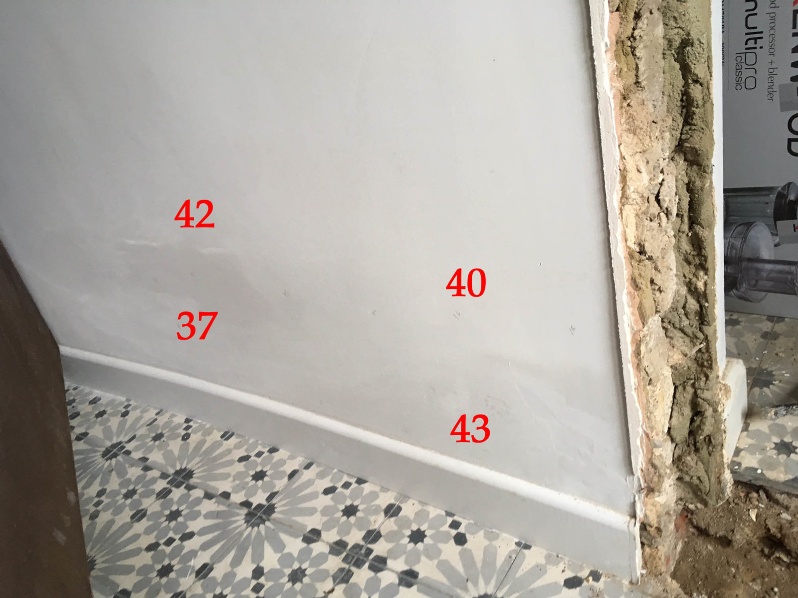

If there are any live water pipes to be found under that part of the floor/wall what would they be supplying - the supplies for the sink and the appliance(s) are drops from above.
You must pull out the W/M and examine the supplies & skirting and wall/floor near the W/M waste but I doubt that a waste leak is the problem?
Take pics and a pic of the outside gulley.
On the face of it, it seems more likely to be rising damp?
