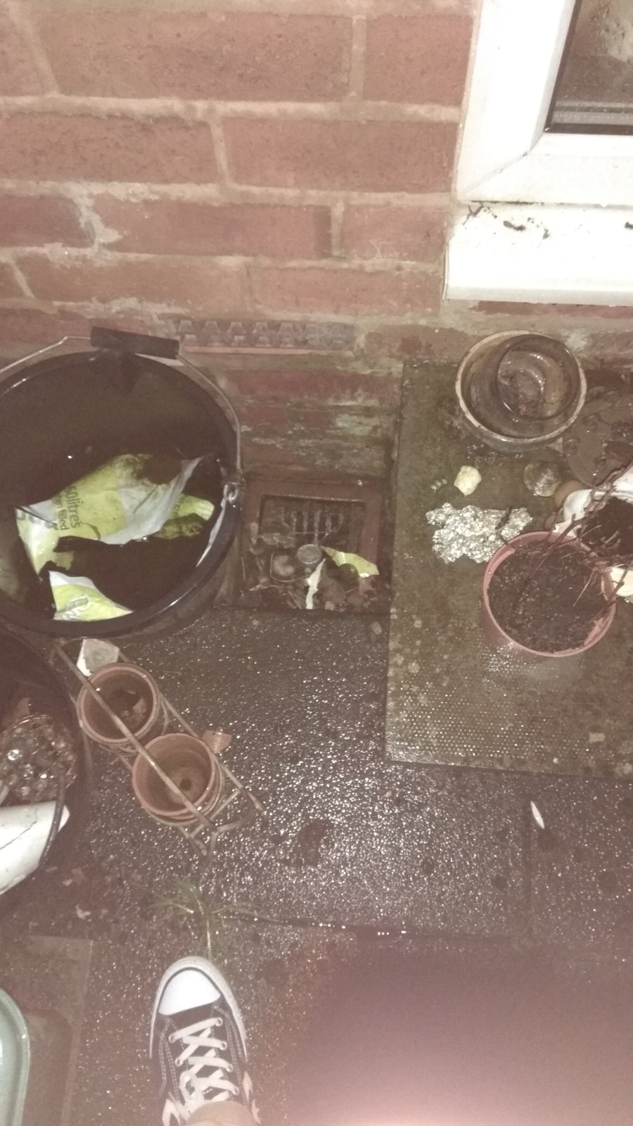

I have lifted the boards and there is signs of moisture on the ground but no leak. The source seems to be the far right corner. And there is a drain on the other side.
SALL2009, Hi.
There is what appears to be an air brick on the external wall above the external drain, which "possibly" ??? indicates that at one time the entire internal floor was of a suspended timber construction??
Also of "interest" is the apparent dampness externally on the bricks above the area of the drain.
Has or does this drain overflow?
As an aside, if indeed the drain is leaking, it would take a CCTV survey to determine that, it will be an Insurance claim to undertake a repair on the underground external drain.
Ken.

If the "second" air brick runs into what could be considered as a "duct" that will make sense, why? because that air brick will be allowing a flow of air, which the suspended timber floor needs, and allowing this flow of air to "get past" the concreted area of the rooms floor.
Are there any areas externally that are soggy / wet / damp? this could indicate that the external drain is indeed not performing as intended?
Are there "ducts" attached to both air bricks?
Ken
I need to check the air brick above the drain but I have a feeling it probably runs into duct to the front lounge.
Hopefully so, why because these ducts, if there are indeed 2 are in effect preventing the build up of dampness in the under floor area of the suspended timber floor and joists in the room.
If so someone historically has at least attempted to ventilate the void under the floor and gat past the obstruction of the concrete.
Could it just be that the drain is blocked and not actually cracked / damaged?
If it was just blocked you would see it flooded, pour a bucket of water down it, it will clear in around 30sec if its clear.
Lift the floorboards where the radiator pipes are and check they are dry.
And the plot twists again. The drain doesn't go into the manhole at all. There is no branch coming into the manhole from that direction.
So it would seem that it's a soakaway. Or just a gully top with no pipe attached to it.

3. I have thrown water into the drain and none of it appeared in the manhole that I suspected it was connected to. (can't see any other manholes at the rear of the house)
Does this issue seem quite bad? Part of me thinks what is stopping me from filling in the drain with concrete and directing the water towards the garden (by raising the level slightly on the wall side. )
