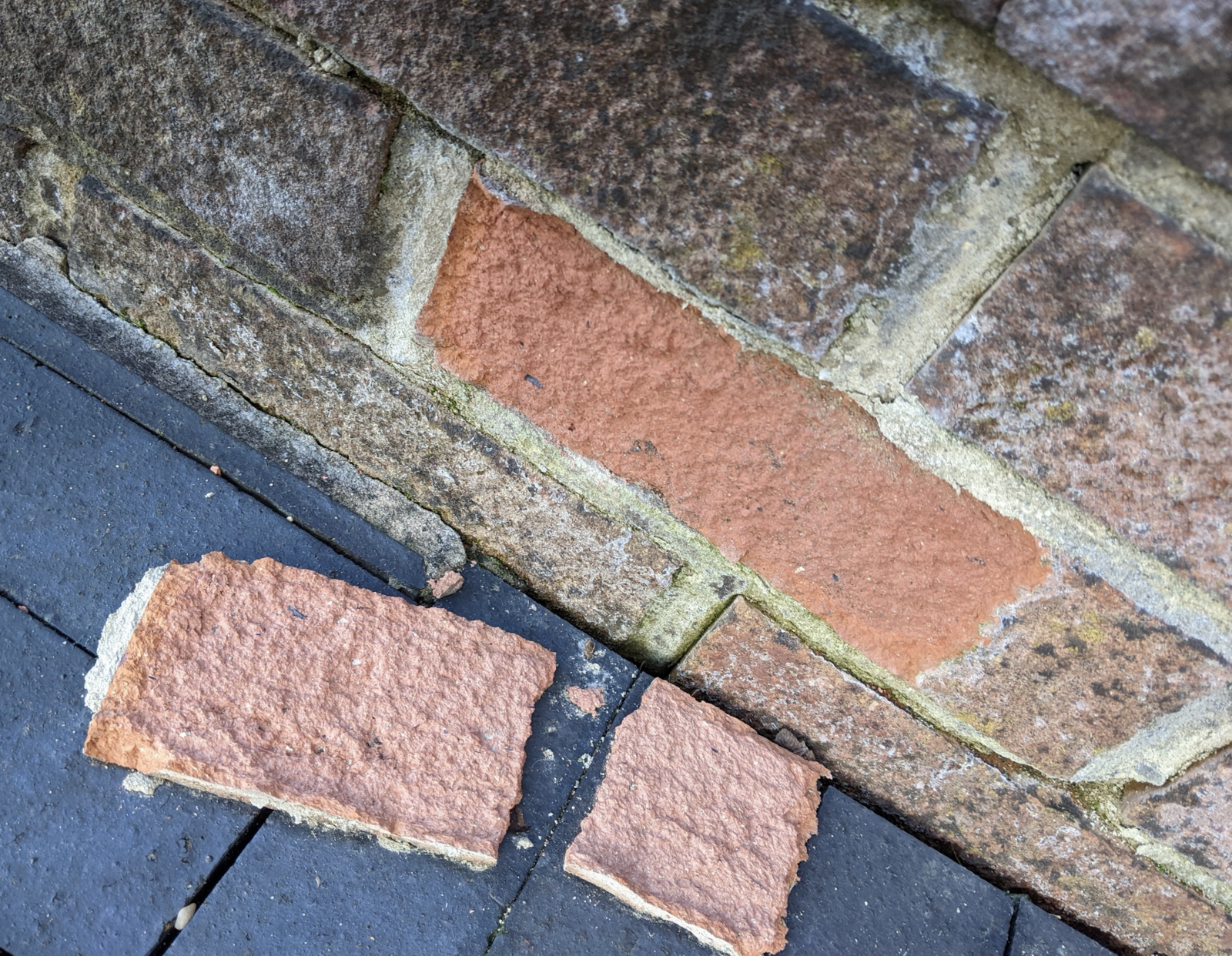

External wall damage on sloped drive. Likely caused by water? Effervescence on another wall too. Advice? Repoint? Other?

Frost damage from water ingress ( rain and/or surface water) because dpc too low (should be minimum 150mm above ground level). Might have pre dated block paving though.
