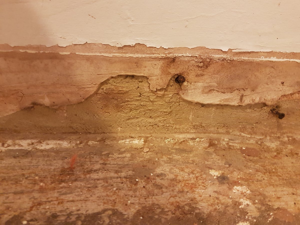

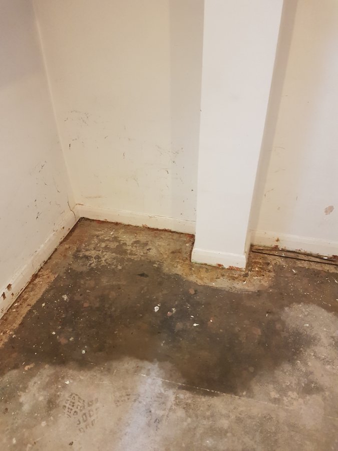

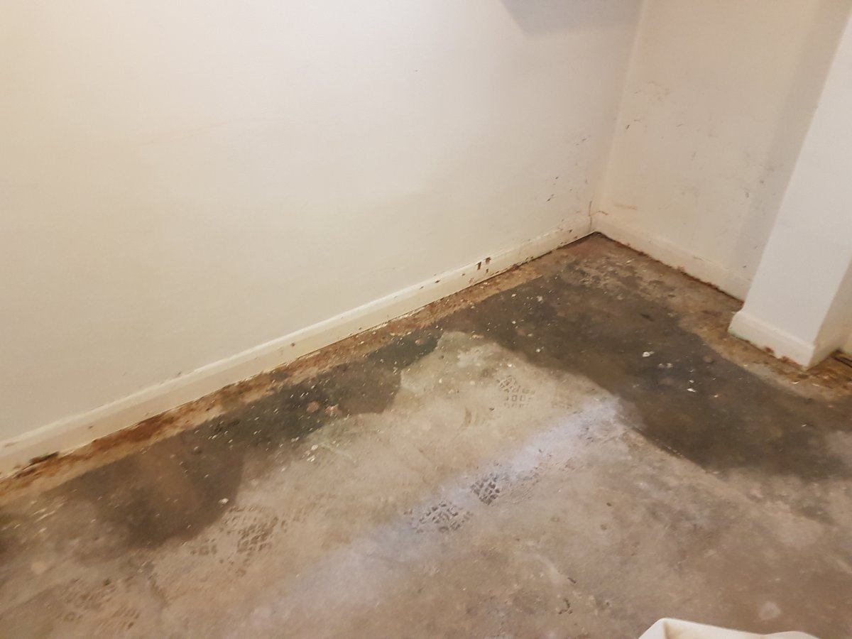

Hi all
I have a basement which is below ground level on the 2 external walls. These walls were re-tanked about 15 years ago and no obvious moisture has come in since then. After having a musty, damp smell I lifted the carpets and there are now damp patches on the concrete floor ( please see pics ). I have put a damp meter on the 'dry' spots on the floor well away from the walls and the meter still shows dampness, and where the obvious damp patches are next the the outside walls damp is showing on the meter up to about 30cm above floor level, but not much above that. The property was built in about 1900. Any advice o how to treat this problem, I was wondering whether trying the concrete with a de-humidifier first then applying something like https://www.kingfisheruk.com/epoxy_primer-item-70 would help?
Thanks for any advice.

When it was re-tanked, all previous existing waterproofing and backing coats were removed to ceiling height. An initial base render coat of sulphate resisting cement/sand (1:4) incorporating a modified polymer additive. The base render was overcoated with two coats of the Thoroseal waterproofing system at a combined loading of 2.5Kg/m2., again incorporating a modified polymer additive. The base of the waterproofing was sealed above floor line with Waterplug rapid setting hydraulic cement. Following that further render coats of cement/sand (1:4) added incorporating an approved additive to reduce the effected of hydroscopic salts, and then finished with a Thistle skim.

The tanking treatment that you describe seems to have worked - except at the base of the wall. However, so far as I can see on the pic, there's very few signs of damp near the floor.

What do you mean by "there's very few signs of damp near the floor." - do you mean the damp is located next to the tanked walls and not generally across the floor - if so then that's correct, although using a damp meter ( I know they can be inaccurate ) on other apparently dry parts of the floor shows they are damp.

There are obvious, but so far very minor, traces of damp on the exposed bit of wall - whats the condition of the back of the skirting? Can you pic it?
There's no sign of a membrane but given the amount of tanking layers it would be difficult to see.

I stuck a dehumidifier in there a couple of days ago and went to check today - the visible signs of damp on the floor had gone but the dehumidifier was full, have emptied it and will check again shortly. Does this suggest only a minor quantity of water coming through the slab?

Having said that, the visible signs of damp were all around the edges of the tanked walls, not in the middle of the concrete floor, do you have any thoughts on that?
The moisture is finding the line of least resistance as it rises from below - ie the join at the slab and the wall.
Its probable that using damp proofing sealants will only disperse the moisture differently and perhaps more intensely.
You will not dry out the slab.
The affected perimeter of the slab must be kept clear of any floor covering.
