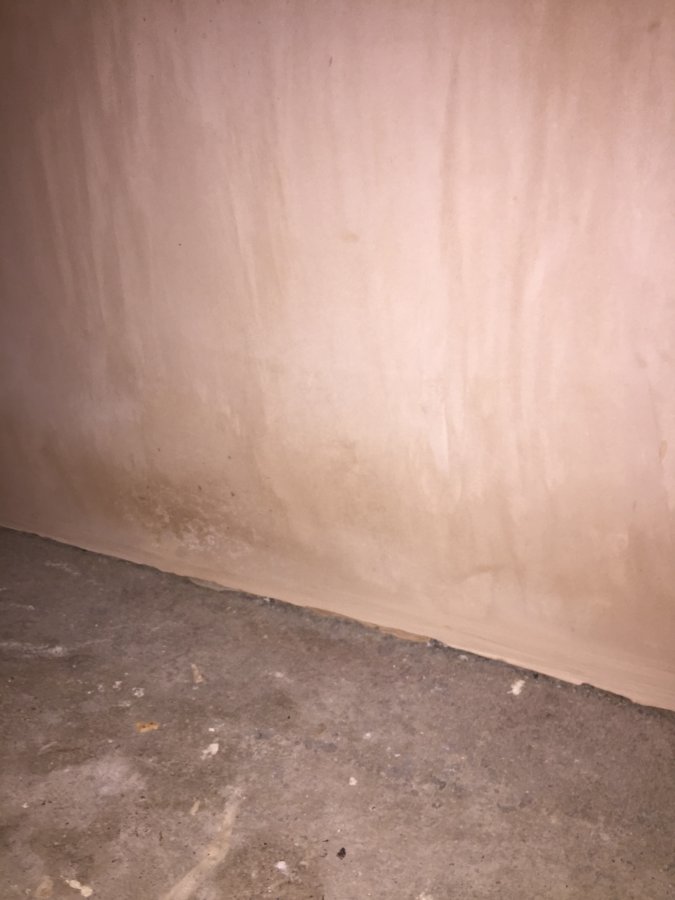

Hi
I have just bought an end of terrace house that was built 1890’s. It has been confirmed that there is damp in the lower gable wall where is meets the ground, damp is also coming in through the floor but this is just the part of the floor which meets the wall. It obviously gets worse when it rains.
At the other side of the wall is waste ground which the soil has been partially removed away from the wall. What I want to know is, if I remove the soil a bit further down than the level of the floor, then have all the waste soil/rubble area totally removed and the concrete over to make a car parking space will this stop rain water penitration the lower wall under the soil or I be creating a further problem/ masking the problem? I guess I was hoping that if I concreted over the area outside that the water would not be able to penetrate the bottom of the wall and soak into the floor/walls.
I appreciate that the wall needs repointing/repairing. I just don’t want to put down solid concrete just to have to take it up again if this is a bad idea.
Thank you.

The surveyor said that there was a little damp in the front room but when I moved in I noticed that the cupboard under the stairs smelt badly of damp and there was a half foot high tide mark from the ground up the wall.

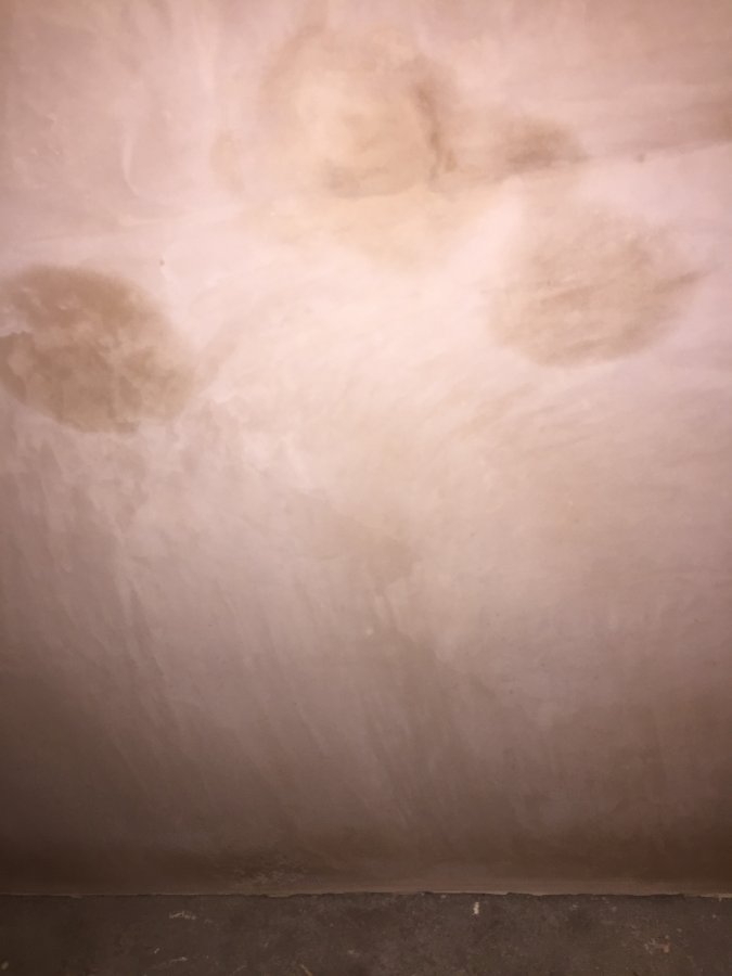

By mistake I got a plasterer in who replaced the plasterboard and said he put membrane behind. He said that wall itself looked dry. He told me that the living room gable wall also had damp with a small machine. That’s when all the trouble started and I noticed more problems.

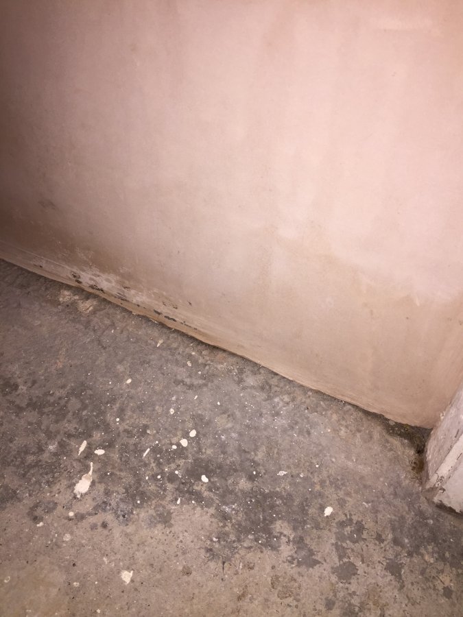

The cupboard itself smells bad, worse when it rains. The new plaster has now got a little mould on it and the hoover was wet and rusty. When it rains the plaster looks wet at the bottom and some patches higher up. I took up the lyno and could see that the ground was damp, with darker patches were it meets the wall.
I asked another company who deals with damp problems who checked the walls with a two pronged machine he told me that the whole wall in the livingroom, the cupboard wall and cupboard floor were damp. When it rains you can see that floor is darker grey and damp to the touch. I have also noticed that when I pull up the carpet when it rains the floor in the living room looks slightly darker in places.

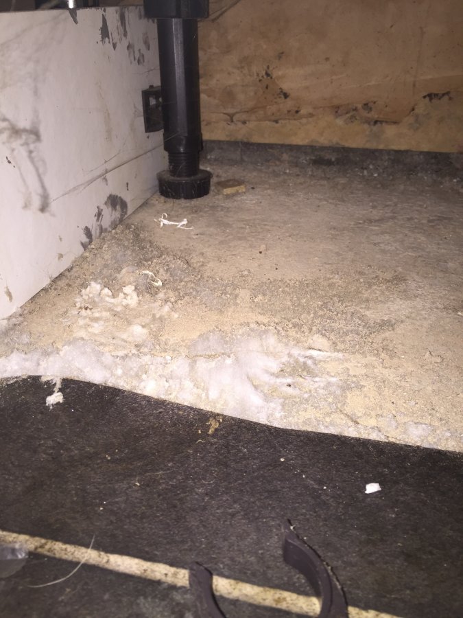

The kitchen wall is also a problem at the gable. The same guy touched the wall with his two prong machine and said there was damp in the lower part of the wall and needs a damp proof barrier putting on the inside. He didn’t check the floor in the kitchen but you can smell what’s smells like slight stagnant water under the lyno. Also you can see under the units that there are little piles of what I think are salt piles and the smell is horrible. The carpet in the kitchen also smells in places like stagnant water but it's now dry.
We are at nearly the top of a back and yes, the garden slopes slightly downward towards the gable wall which I why I wanted to level the garden area and cover it with concrete or something similar.
All the downstairs have solid floors and in bad weather are extremely cold but the carpet in the kitchen sometimes feels damp.
The smell in the kitchen is not pleasant and sometimes I can smell a wet plaster smell in the air and on my clothes.
