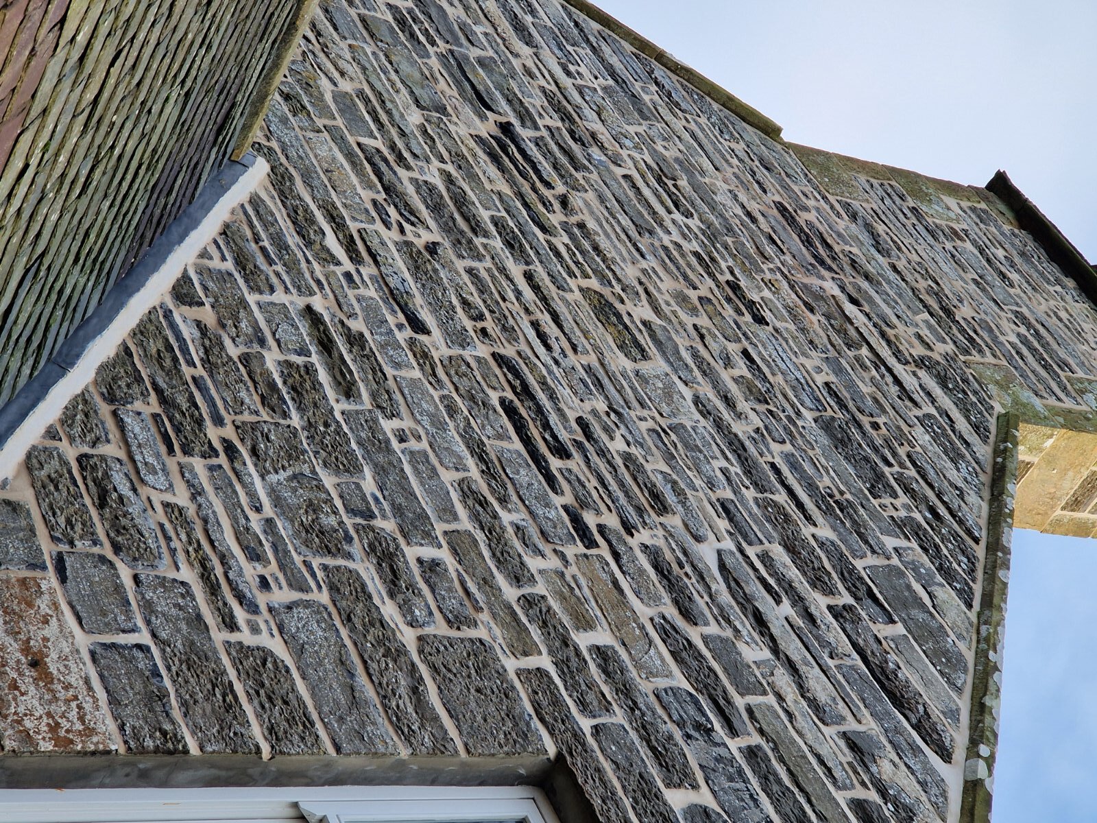

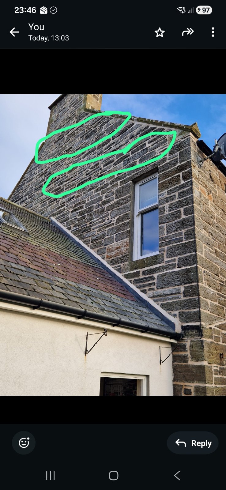

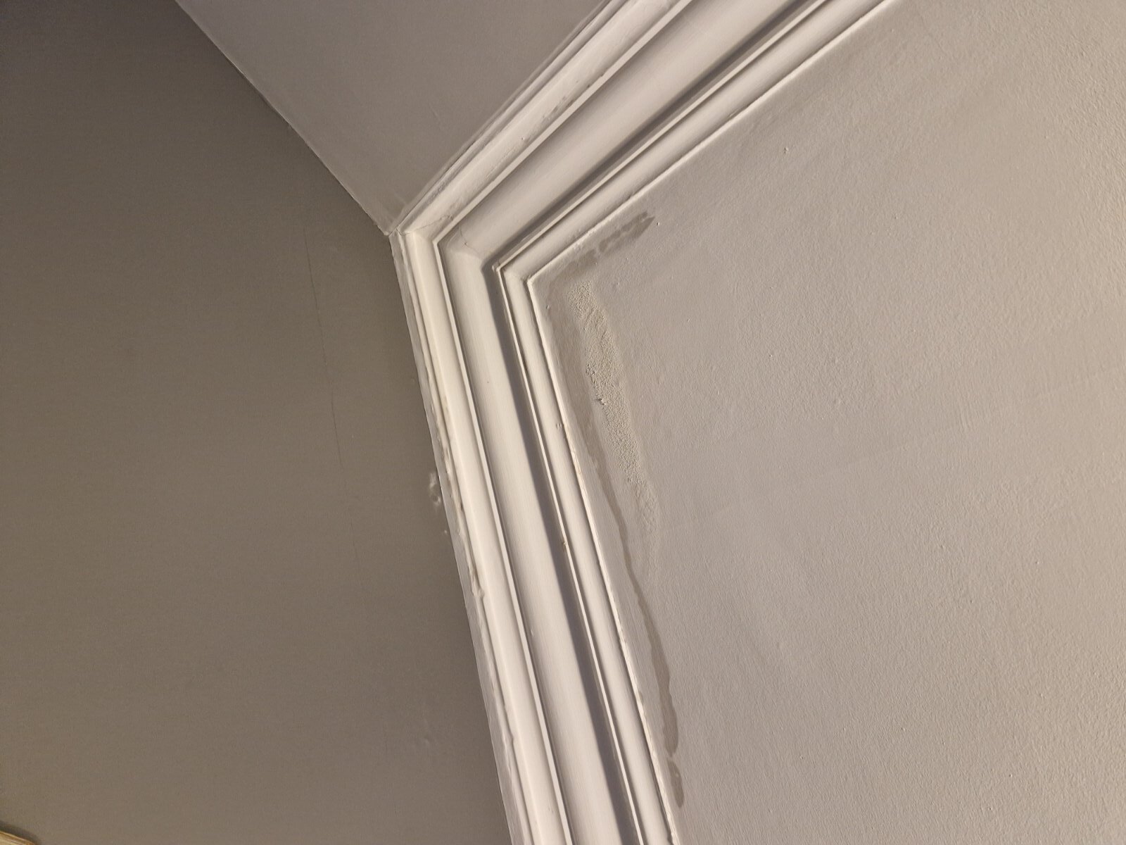

Hi,
We recently had our 1888 built house re-pointed, the wrong pointing(cement) was already there when we bought the house, we were seeing a number of damp areas appear, so we go our builder to pick it all out and re-pointed it with lime. He showed us a few areas that the old cement pointing had fallen out etc.
He finished the new pointing about 6 months ago. However we have noticed some damp coming through on the gable end on 2 levels. Now, the cable end went quite a few months being exposed between the picking and pointing( the builder was doing it all himself and had other jobs on the go) so it was open to the elements. Any ideas what could cause this?
He's a highly regarded builder and did the front of our house pointing 2 years ago with no issues, he used the correct materials aswell. My thought is could be left over moisture from when the cable was exposed and these points are where it's 'escaping'?
We have also had a massive downpour of snow and the resulting melting.
The builder thinks ventilation may be causing it?
The areas in green are roughly where the dampness is on the inside.

Your builder appears to have done a decent job too so not a pointing issue. Parapet walls however, are the work of the devil.:mad:
You can treat wall with storm dry as that may help.
You may find this helpful
OP,
As above, you have an excellent sand & lime pointing job but a suspicious parapet?
The chimney stack details - flaunching & flashing - might also be regarded as suspicious? Have the flues been swept in recent years?
The abutment flashing & fillet to the lower extension roof is wrong - maybe thats how the flashing was done on the inside of the parapet: a selfie on a stick taken from a front elevation window would help?

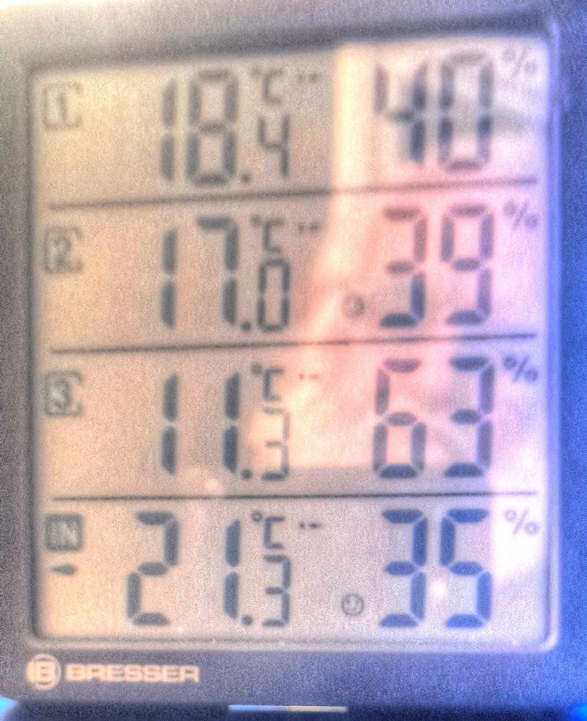

Clearly don't want to return to those days, but we need to replace the moisture removal items of yesteryear, or at least reduce the items making moisture. So we do need to keep an eye on humidity Thermometer4.jpg my thermometer shows how the cooler the room the higher the relative humidity, the worst is the utility room, which is unheated, and has the washing machine and tumble drier in it, but the reading were quite a surprise to me, as last house was more like 70% in all rooms, and I really don't know why such a huge difference. Father-in-law had even a higher humidity, likely due to triple glazing, there will always be some moisture in the home, but we need to keep it within a reasonable limit.
So seeing damp on the walls with this house would be a reason for consern, but in father-in-laws house, it was more down to way he lived, the gas cooker clearly not helping. So what is the relative humidity and temperture in the rooms affected.

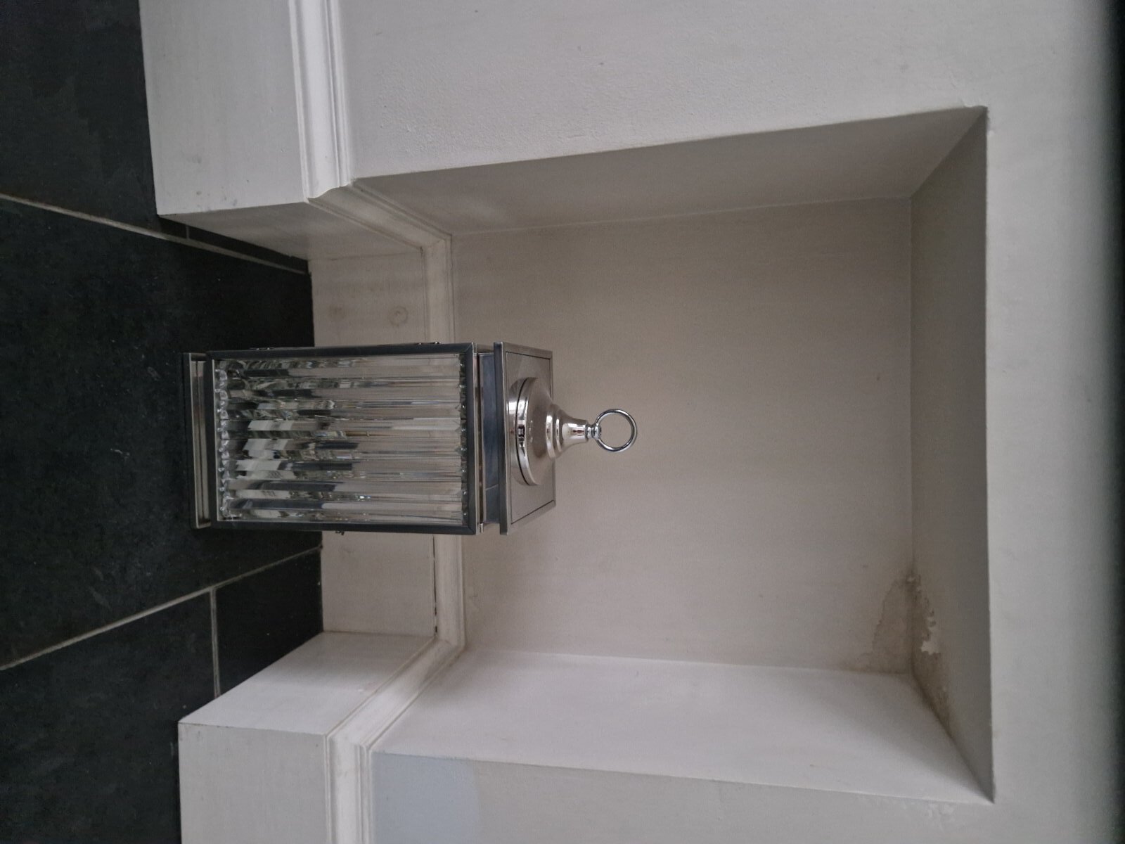

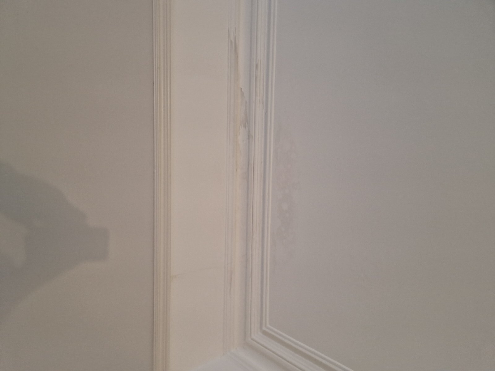

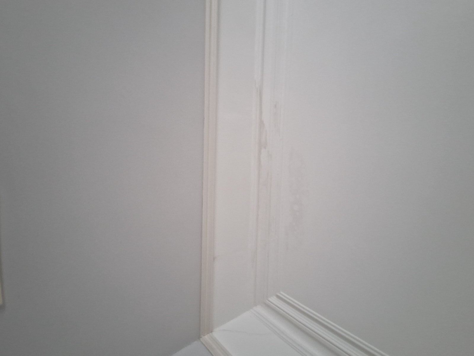

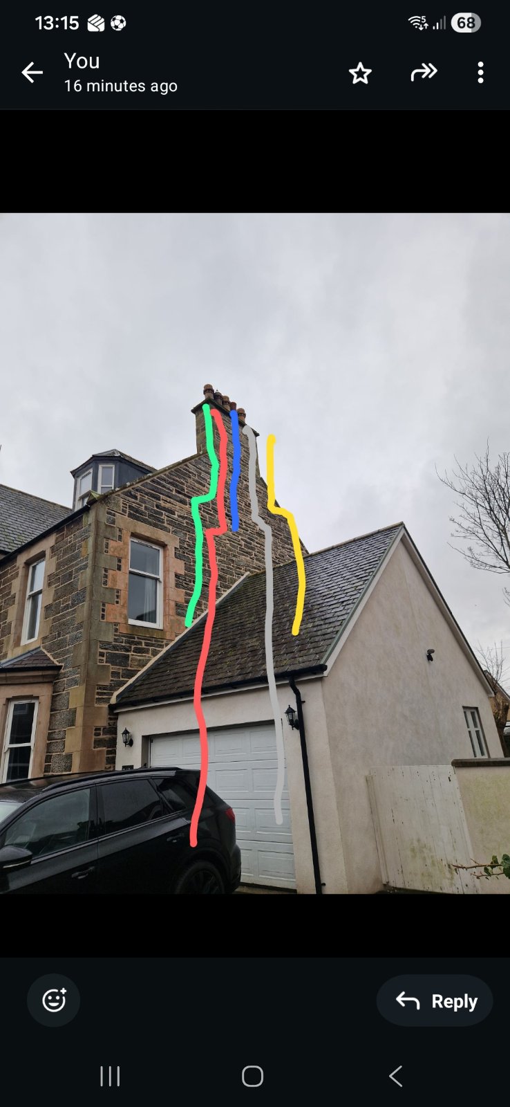

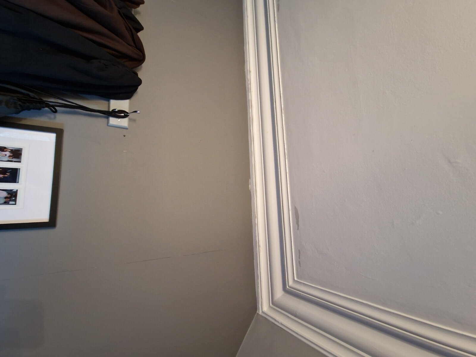

Hi,

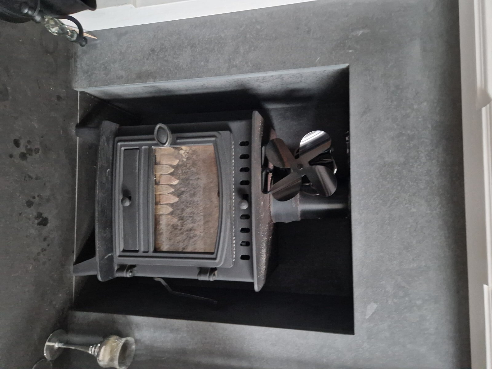

As you say, the flaunching on the chimney stacks are inaccessible, however I doubt this has been changed out for many decades, we also have has a minor dampness in the top bedroom for many years and prior to the repointing.

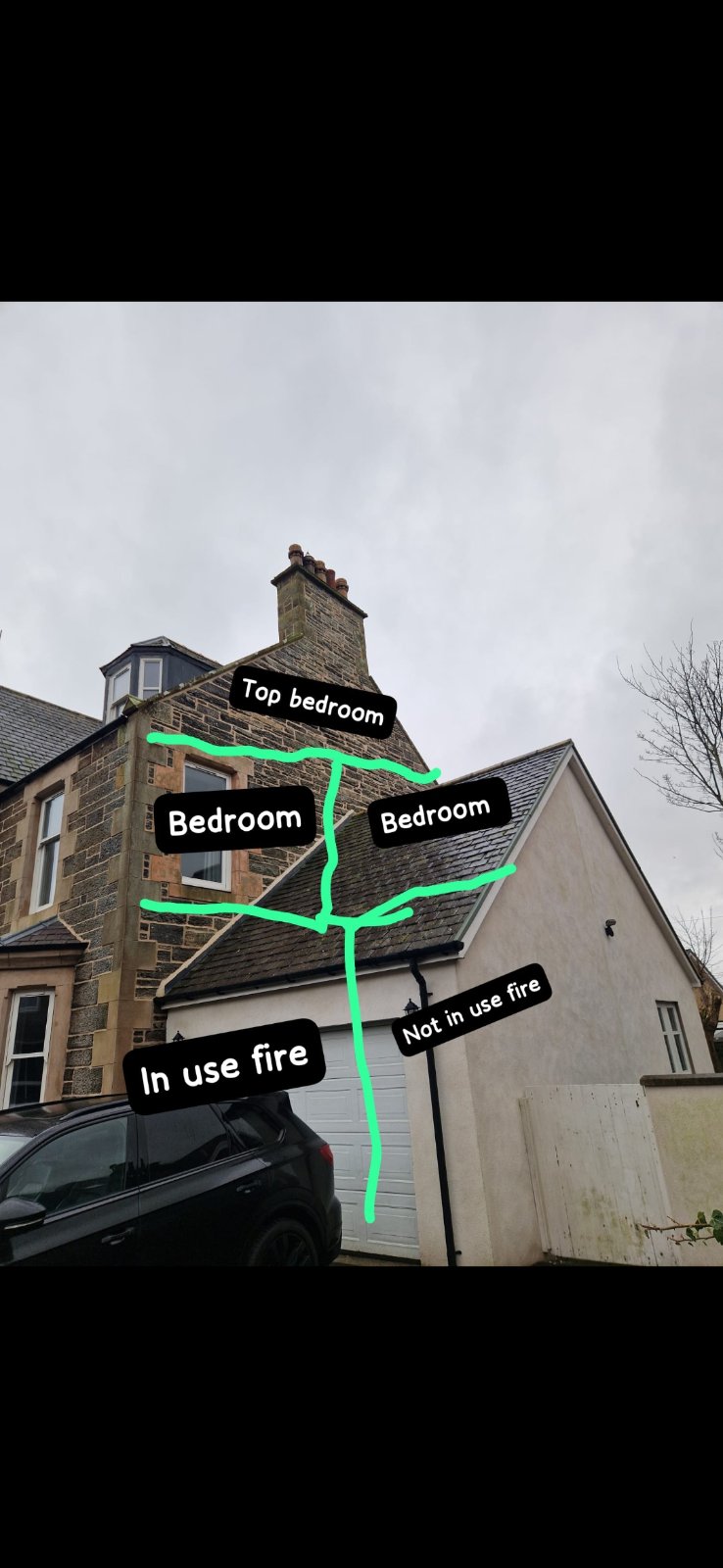

I've attached a photo of the cable end, we have 5 chimney pots, which I assume means 5 stacks.
I've coloured them to their believed routing.
Only the red one remains in use, the grey one has been covered up, however the fireplace frame remains in place and you can see a damp patch in the top left corner, again this has been there periodically for years, there is also no vent on this at any point.
The other 3 go to 2 bedrooms on the second floor that have been completely sheeted over and again have no vents

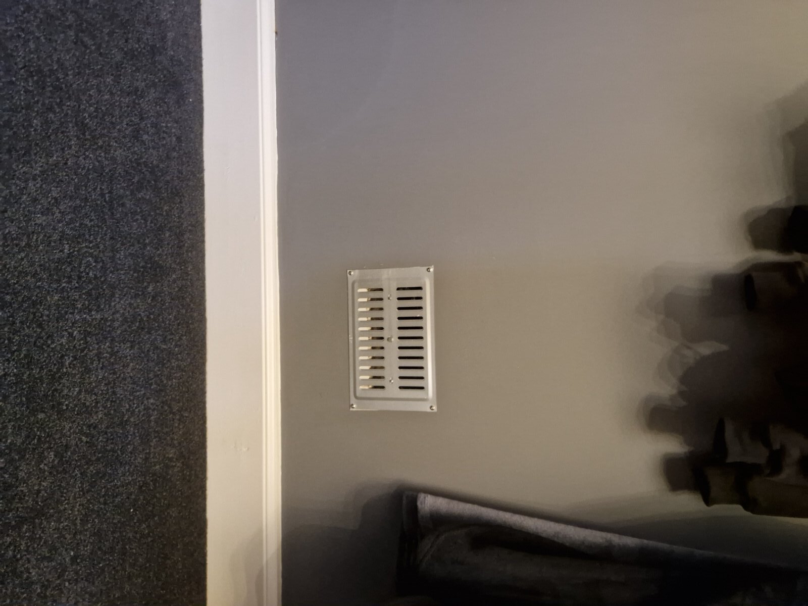

The final blue one goes the the bedroom on the top floor which has a vent, photo attached.

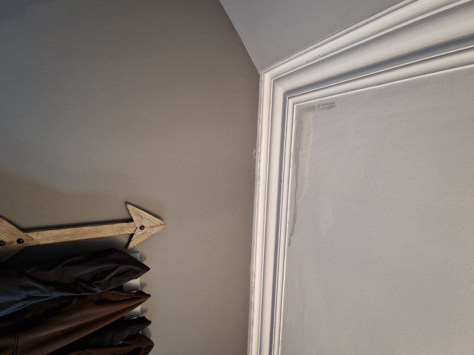

I've also attached photos of the dampness and then where is roughly sits on the gable end exterior.(circled in green)
Again, alot of this is assumptions , so I could be wrong.

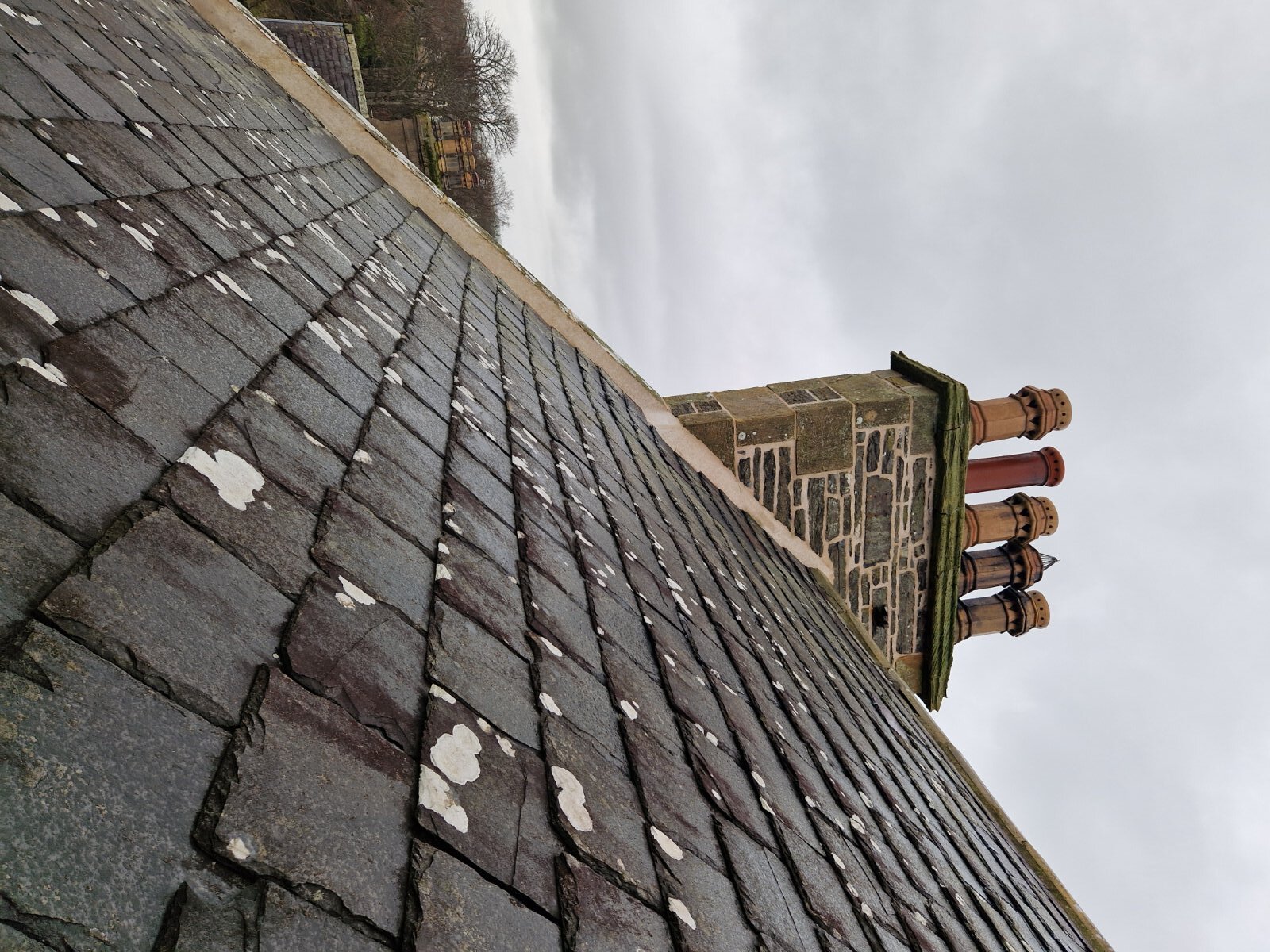

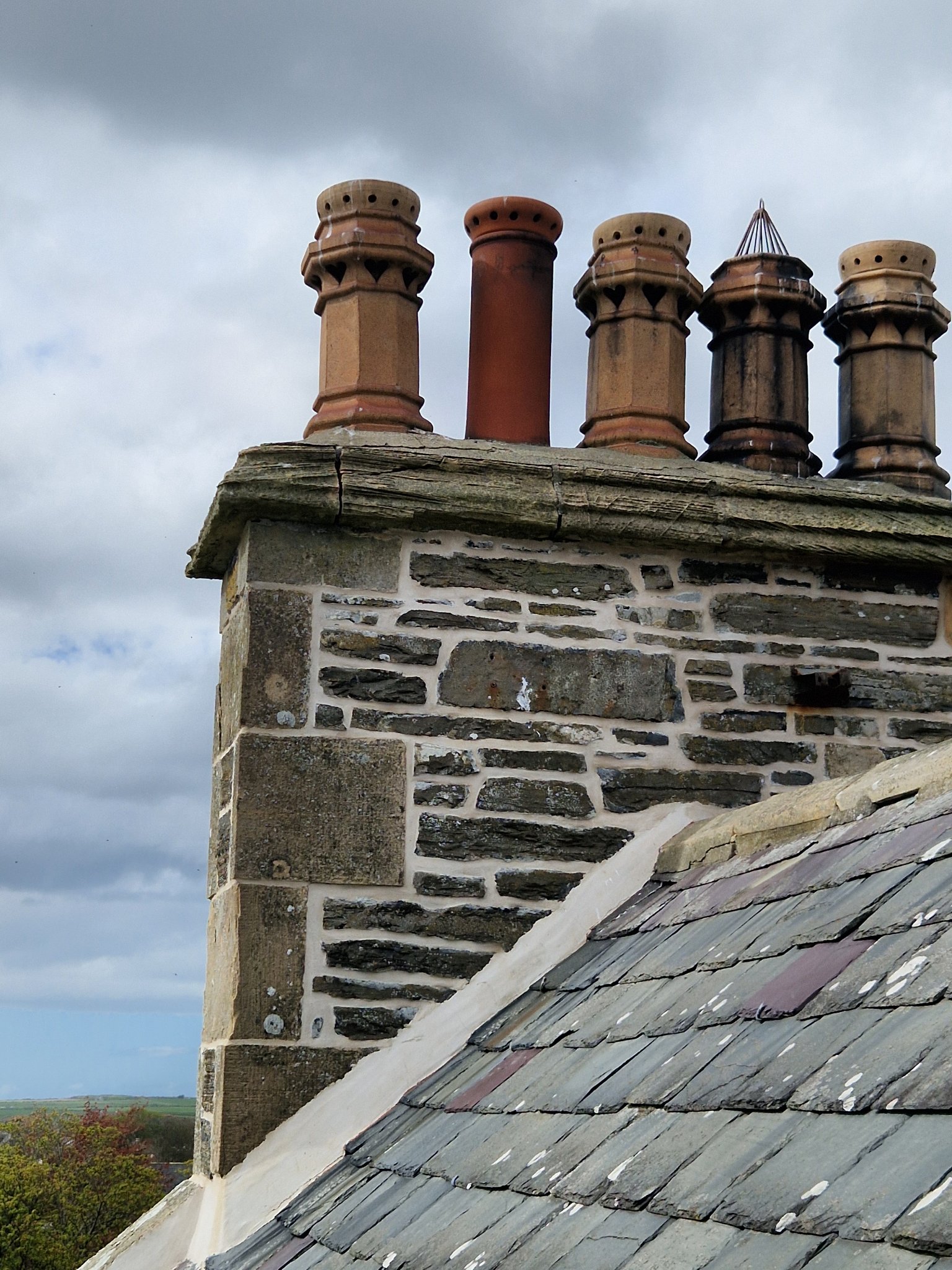

I've managed to get a photo of the parapet at the top.
With regards to the extension/garage, I'll raise the issue with the builder.
Apologies for the crude drawings.

Posh pots! Nicely capped, however some would use sealant to stick down the caps, as sometimes water can trickle in if it's not a tight fit.
Not easy to tell but looks like no oversail on the inside, the big mortar fillet on the inside of the parapet wall is sus, and could be lacking soakers, all as Ree has pointed out.
OP,
Why not use search button for "chimneys" or "chimney flues" posted by ree - then read up on them? eg. each pot has a separate flue.
The inside of the parapet & the chimney stack has a sand & cement fillet - this is wrong and needs changing to lead flashings (why not read up on my posts about flashings?).

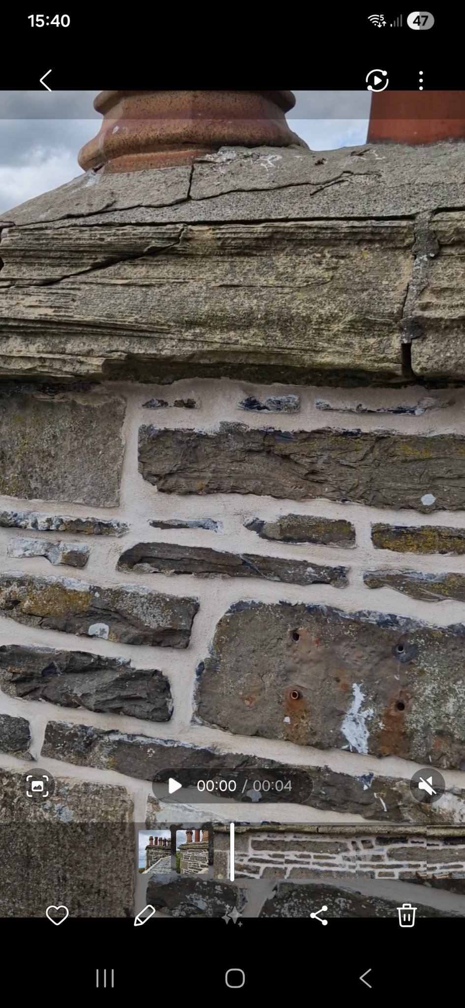

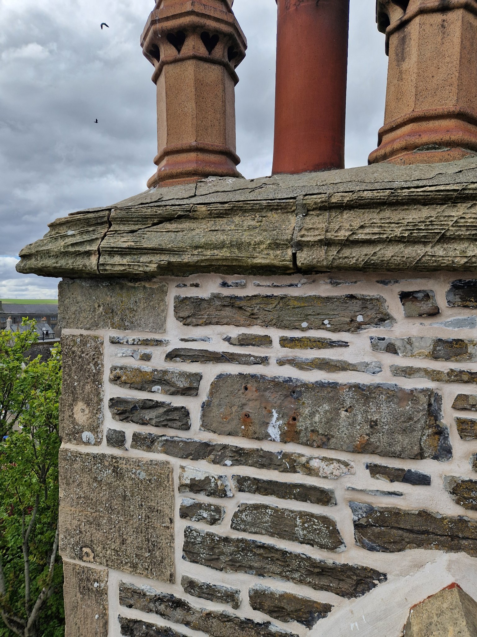

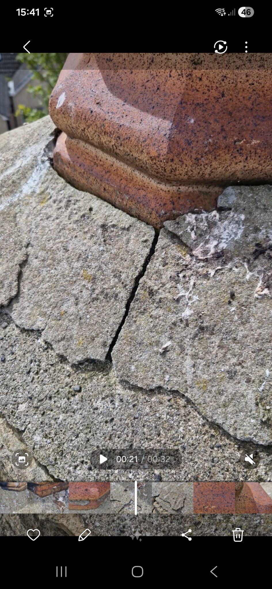

Sorry for the delayed update, I finally managed to get up to the stack, please see the photos attached, to my u trained eye some of those cracks could definitely be the issue?
OP,
Did you read the posts I suggested that you read? Have you decided what to do about the faults I noticed?
Your new pics are interesting & suggest that there's more work needed on the chimney stack & possibly inside the house?
FWIW: I can advise you further eg. the moulded stone capping is becoming dangerous - but first are you up to speed with reading similar threads from the search facility?
