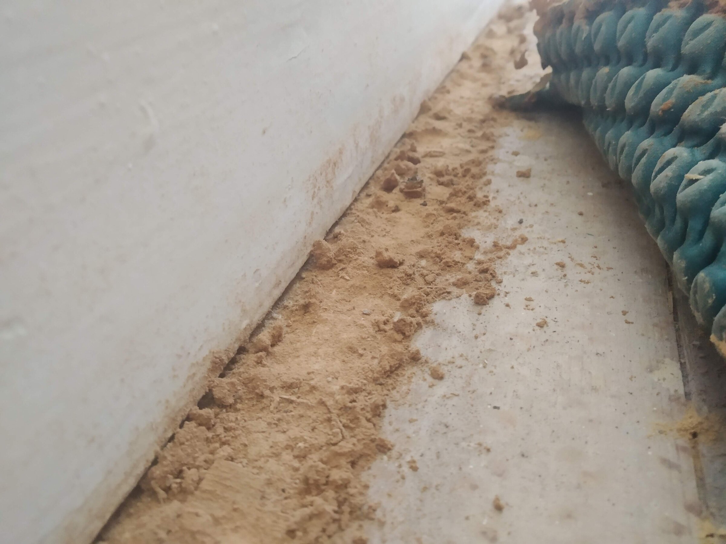

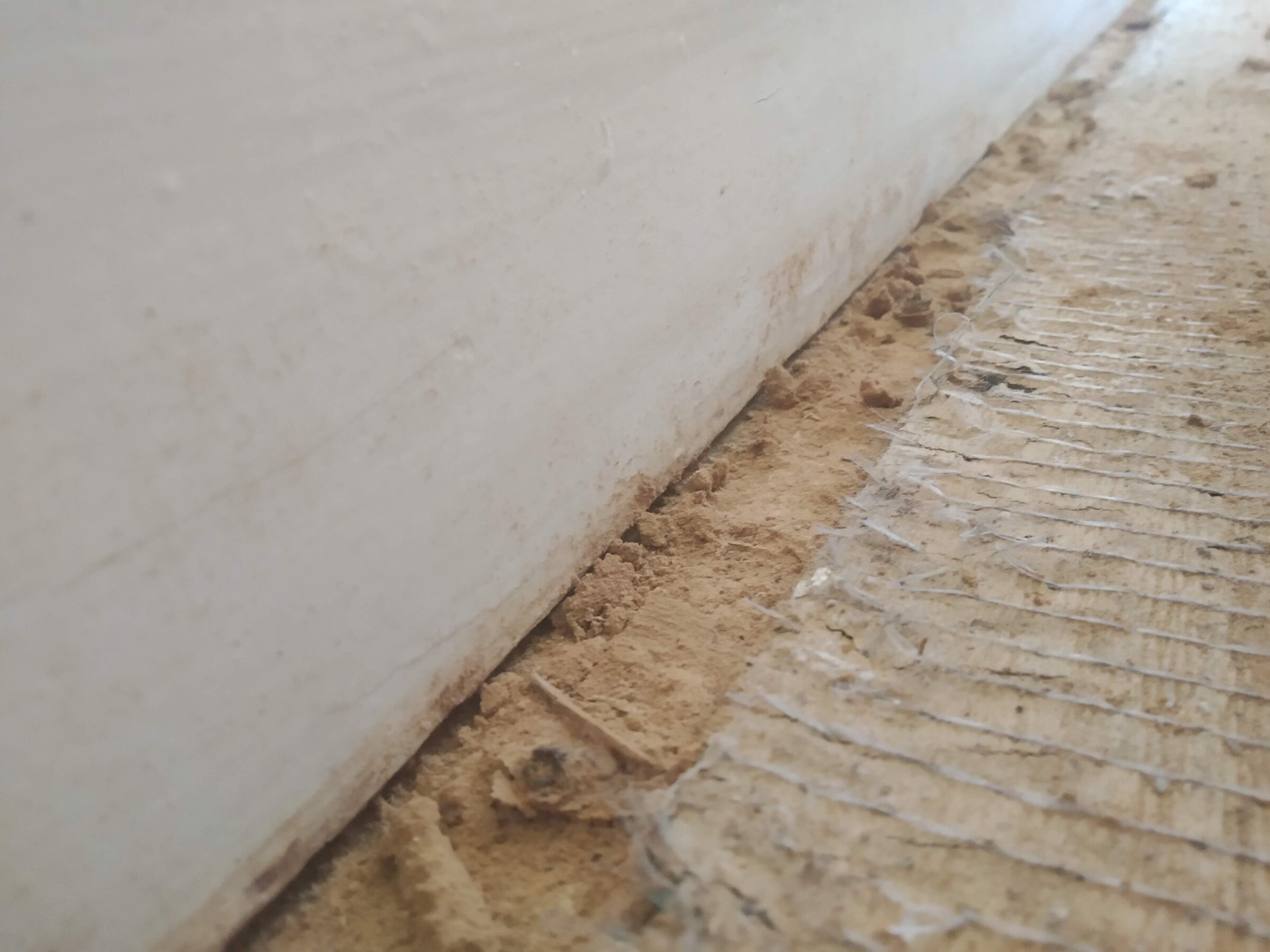

Hi folks,

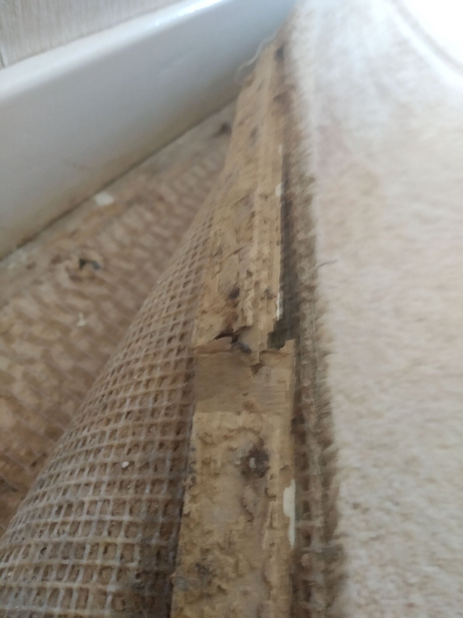

We've moved some furniture around in out back room and found that the carpet underneath was rotting. I've lifted it up and found that there's a section of carpet edging strip that's disintegrated into a dust. Is this dry rot?
The floor boards underneath seem OK, so hopefully I have found it before it's done too much damage.
I'm wondering if the walls are letting in moisture or whether it could be caused by years of poor ventilation in that room and not getting enough heating in there.
The house has a void underneath the floorboards. On the outside of the wall, there is a downpipe from the guttering about 2m along, so I will inspect that later when I have access from my neighbour.
Does anyone have any tips to help me resolve this please?
Pic 3 looks a bit woodwormy but is so fuzzy could just be rot.
Does it smell
Yes, definitely worm. It's strange how they can decimate one bit of wood and leave another bit alone.
