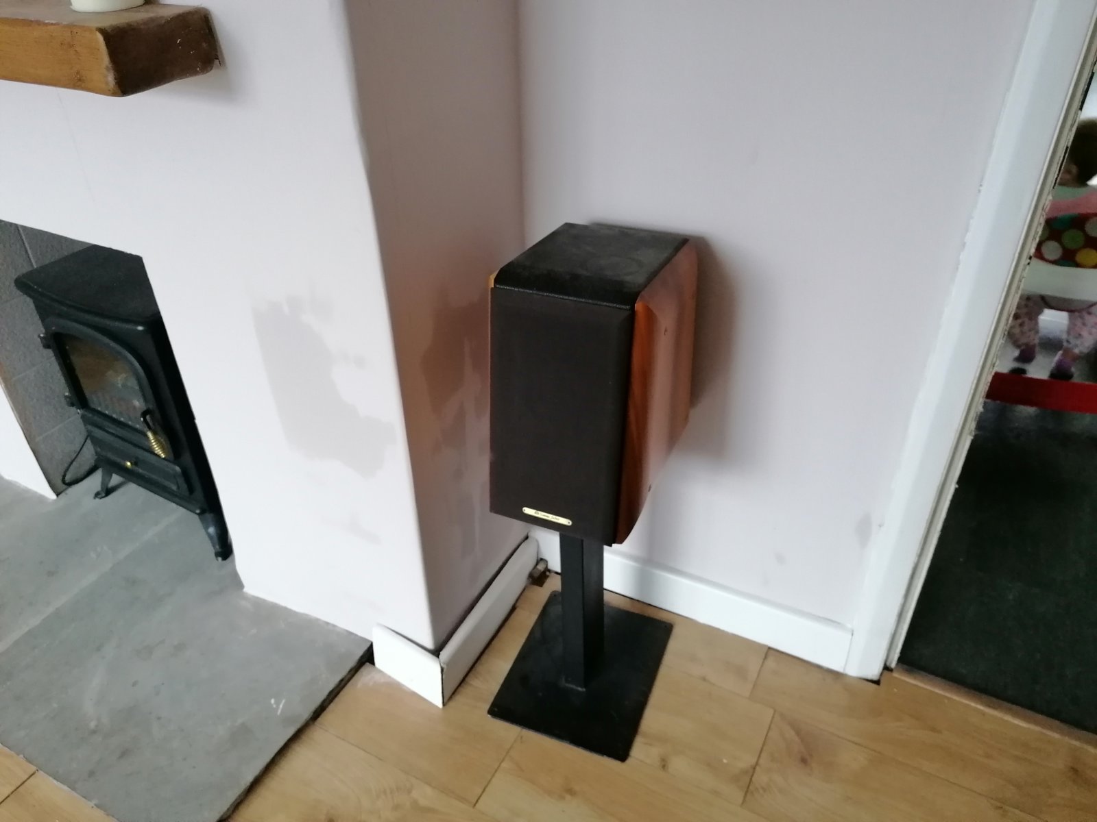

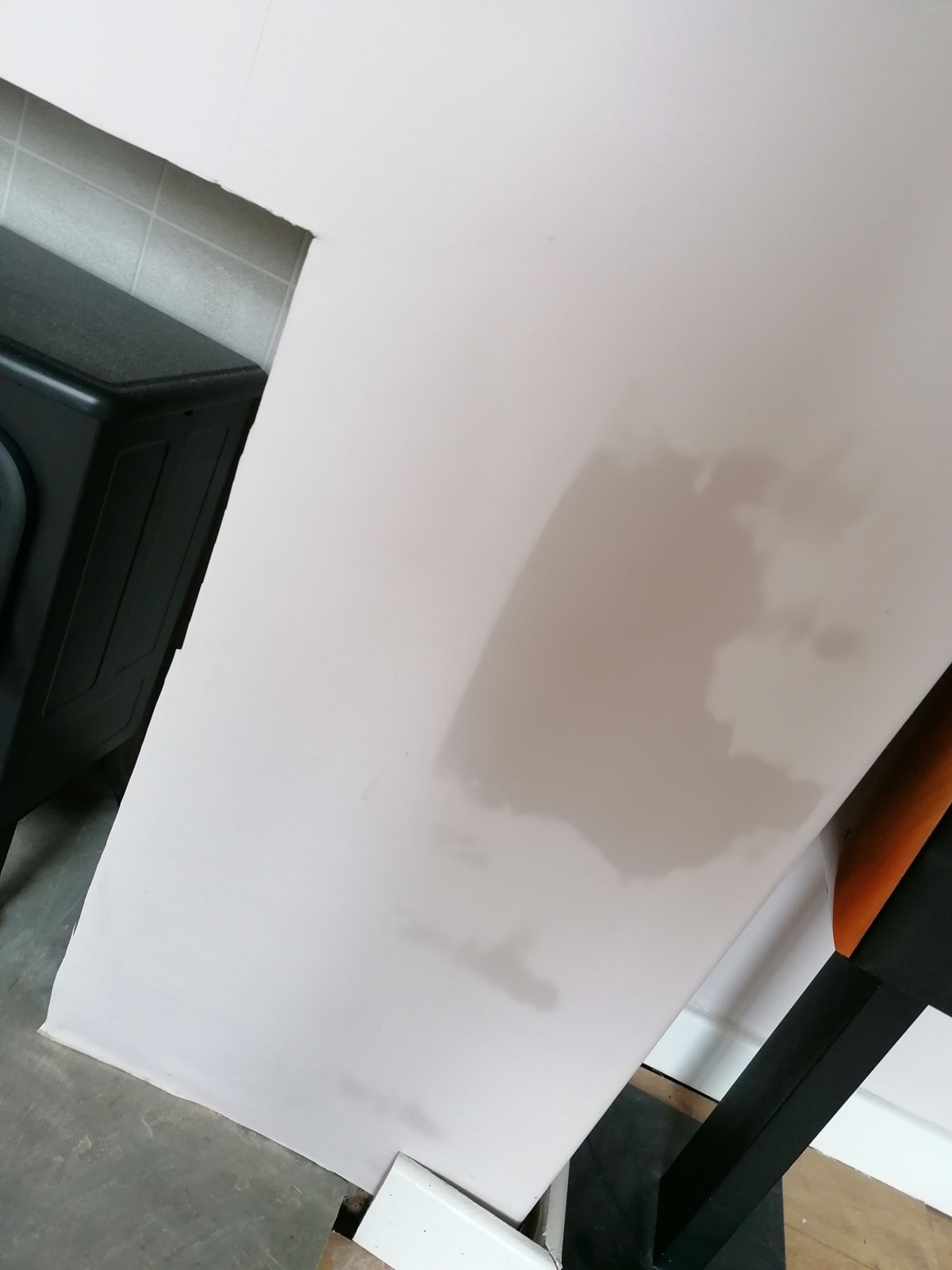

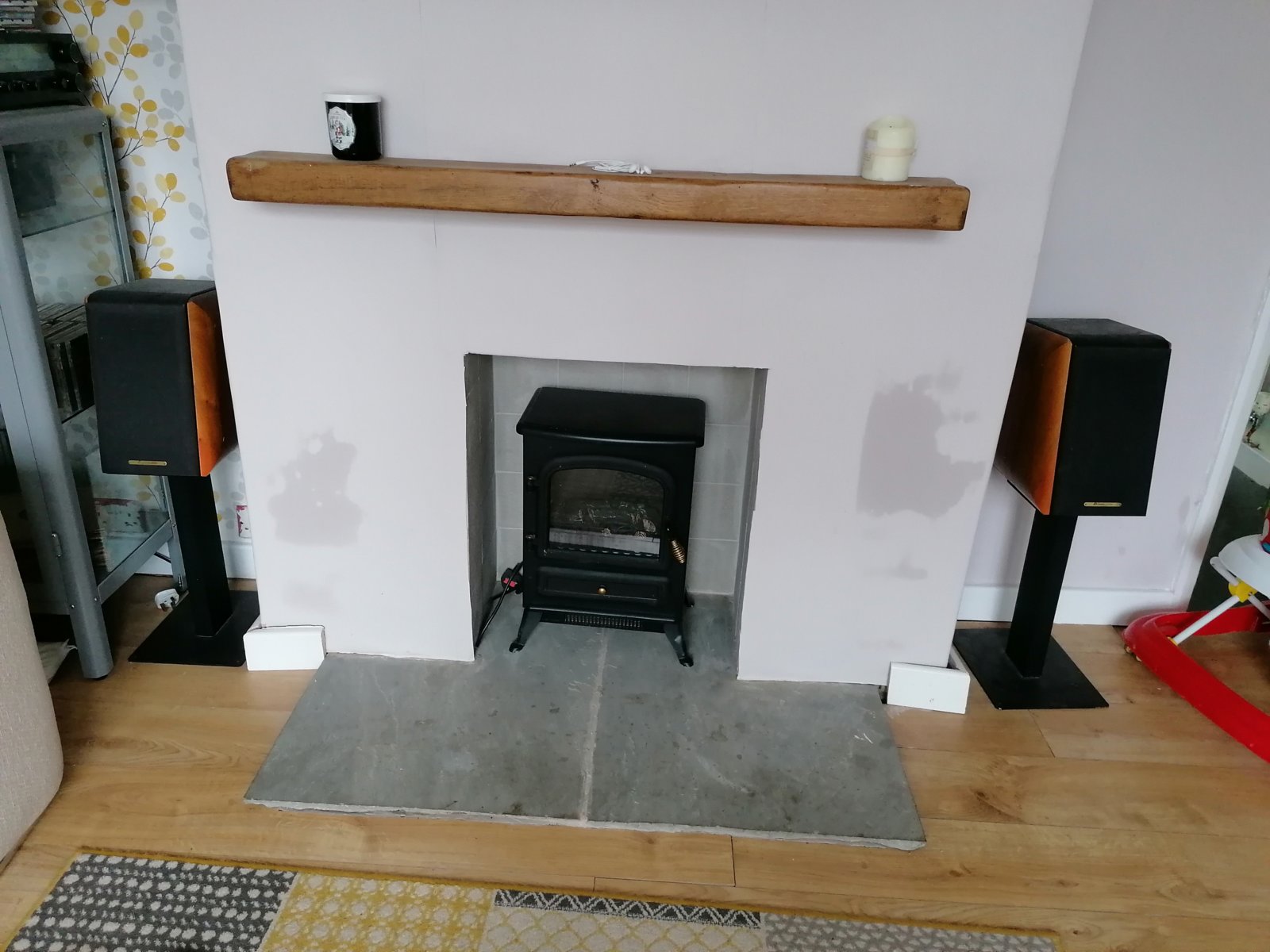

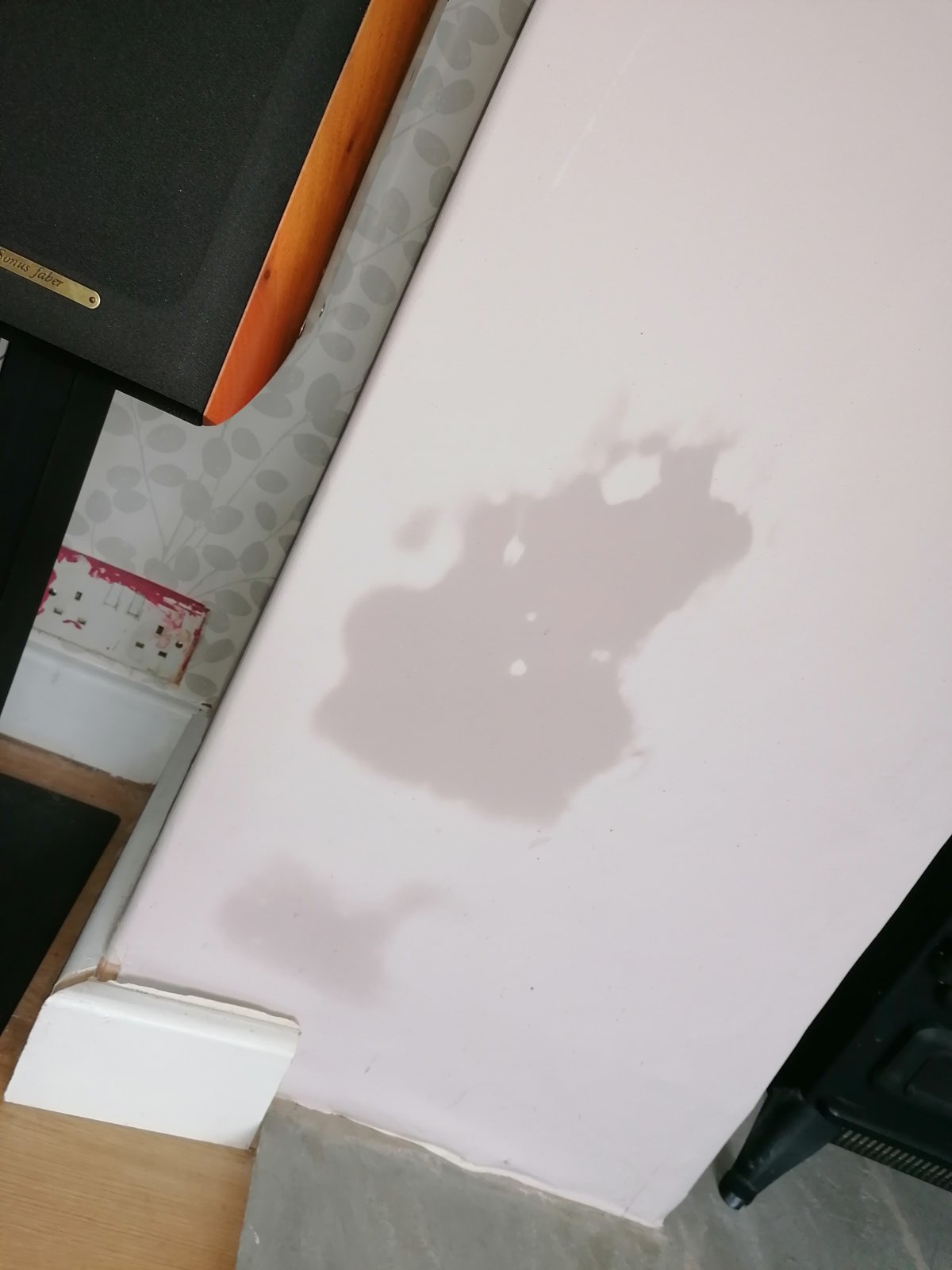

Hi, since wallpapering my living room these dark marks have appeared on my wallpaper. They were a lot fainter to start with but now darker and bigger. It shouldnt be damp as we had a damp proof course done 12 months ago.
Anyone have idea what this is or how to deal with it?

Your damp patch seems to extend about a metre above the floor so is probably being supplied by a source of water. It also appears to be localised. Is it an outside wall? Do you have similar damp patches on other walls?

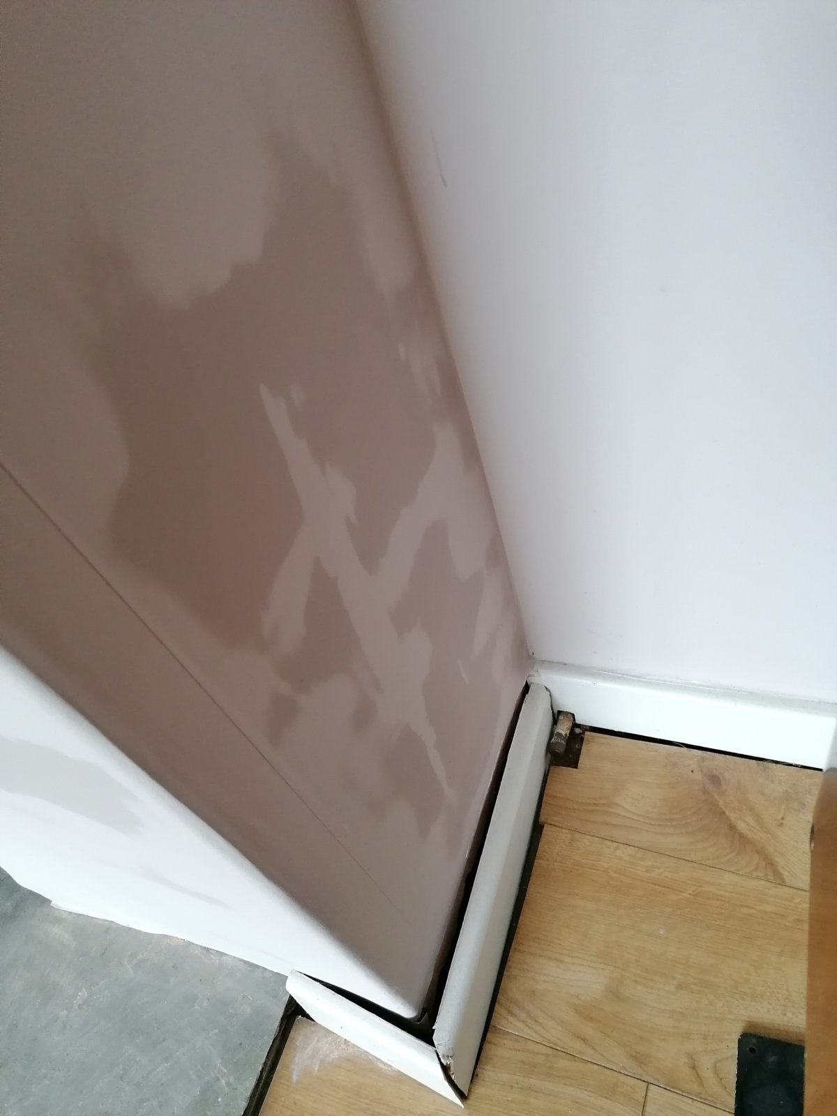

It doesnt smell, and no not an external wall. Mainly just either side of the fireplace. A small amount has appeared next to the doorframe by the speaker

So the wetness appears to be associated with the chimneys.

it looks like the hearth stones have been laid on the wood finished flooring - perhaps the finished flooring has been laid on the old soil, hearth infill - this could eventually cause damp conditions.
more immediate you have damp signs whether from rising damp or hygroscopic chemical damp i cant tell.
does your chimney flue have ventilation bottom (above the elec fire) and top?
its probable that the gypsum (wrong) plaster thats been used will have to be hacked off the chimney breast and the back walls - and replaced with (the correct) sand and lime render. you dont use gypsum plaster in damp remedial work.
