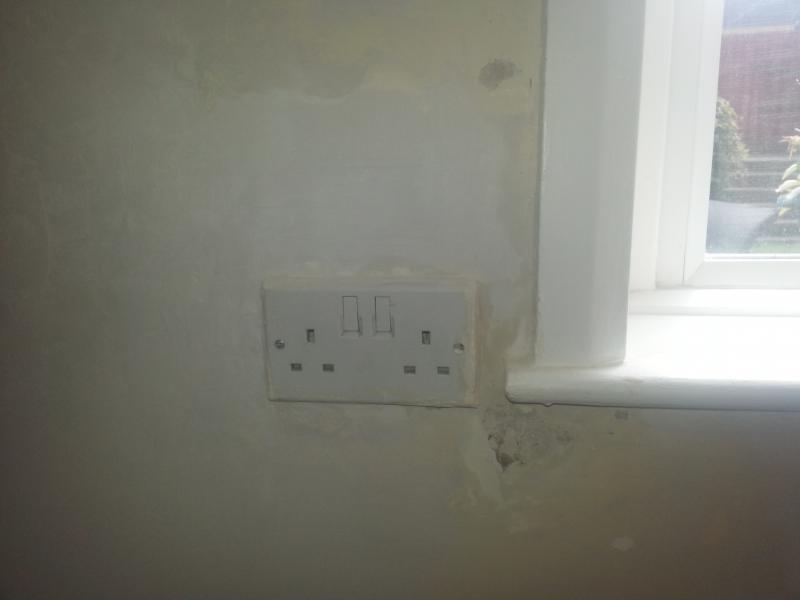

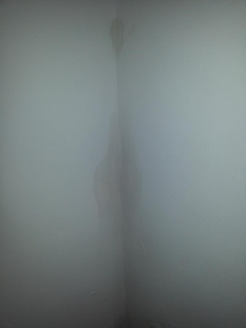

Recently bought/moved into a old terrace house and 4 months in i'd started to notice wet marks dotted around a wall.
These wet marks start near window corner and move along the wall (never rising from the floor) this is also the same near the front door and cover of the room.
I've attached a picture of the corner and where i've sanded back the wet marks around the window.
I've tried sanding back, and using ronseal damp proof paint which covered the marks great, but the wet marks appear again below/above where i painted.
The bricks outside where the damp marks are look well weathered, and a few flaking (apologies.. i'm a diy amateur)
Any advice??

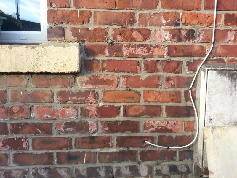

The elevation has been re-pointed in the past - re-pointing requires a rake out of 20mm to 22mm deep and a soft mix of mortar. Check your pointing.
The stone cill appears to be central to any damp penetration - does it have a clear throating, and is the PVC frame well silicone sealed?

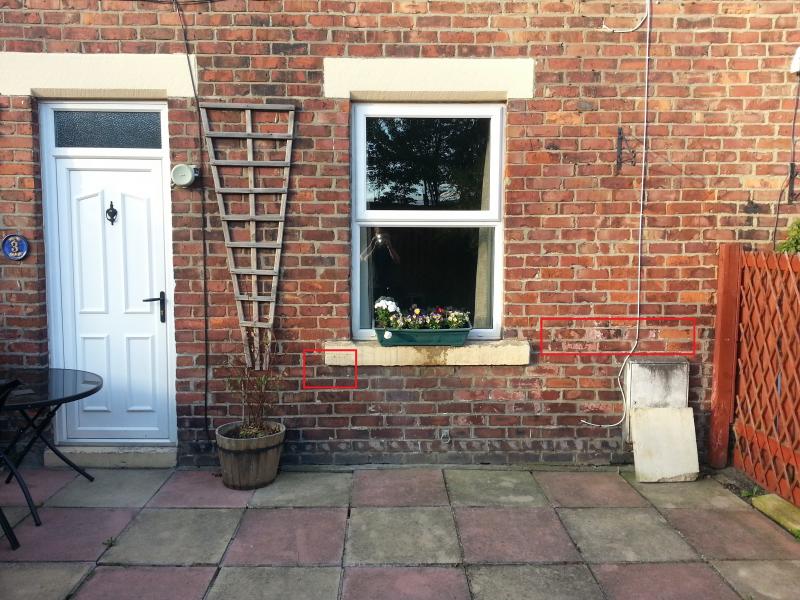

Your right, one section of the wall where it's wet is around the pipe from the gas meter outside, i wouldn't have a clue how to fix that without worrying that it's gas.

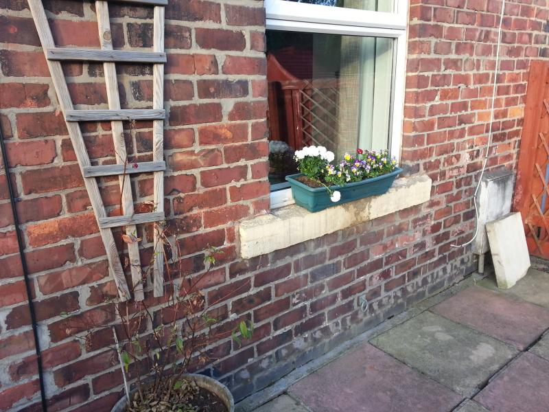

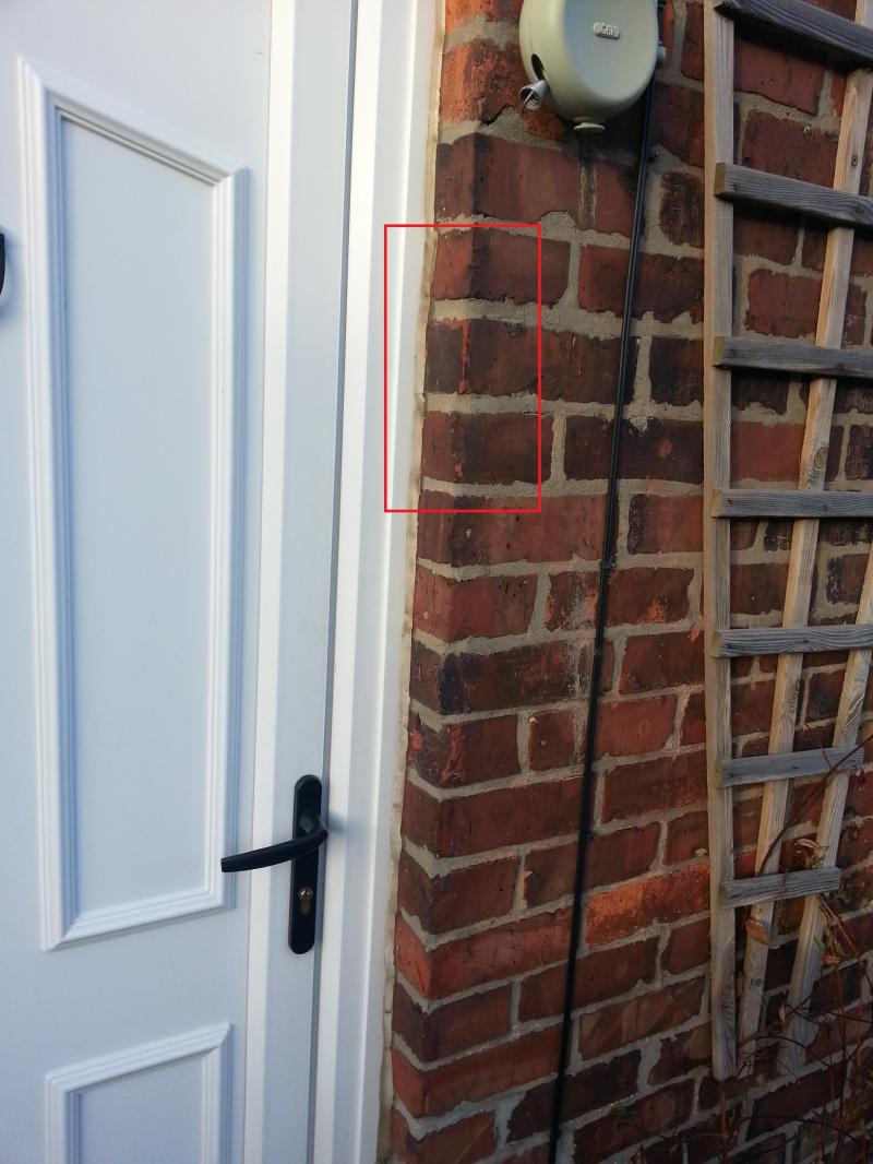

Going by the brick bond you may have a cavity wall, albeit a narrow (finger) cavity. Slightly unusual for an older property. I wonder if the problems around the window and door are caused by damp penetrating the outer brick cavity closer (header) and 'wicking' through to the inner leaf. There may be similar problems around the meter box where there may be local bridging of the cavity.
Modern construction would include cavity closers that prevent such transmission of damp but they did not exist when these properties were built, hence I think this may be the problem, at least in part.
If that is the cause then I would try a clear water seal solution on the brickwork but only in the affected areas. The brickwork does look in poor condition in places so damp penetration could be the issue.
There has obviously been a chemical damp course inserted at some point but I don't think that has any bearing on your problem.
The flagged yard has raised the external ground level, and to compensate a fillet of sand and cement has been installed, and a ((as above) DPC injected at a useless height. No air bricks are visible - except perhaps glimpses of virtually covered over air bricks just peeping above the flags. Suspended floors need venting.

How long has the abutting fence post been in position?
Was the trellis recently covered with foliage?
