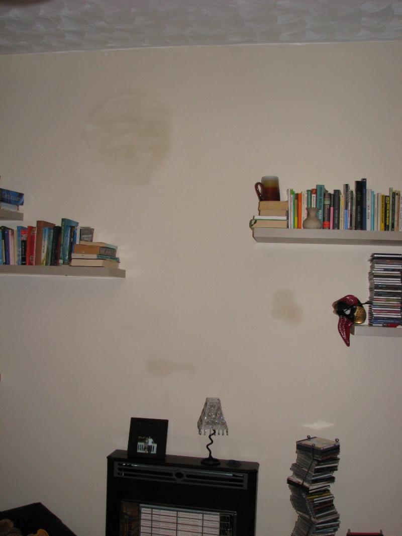

got damp patches coming through plaster on chimney breast with gas fire (fire not used often). Only appeared since rainy season.

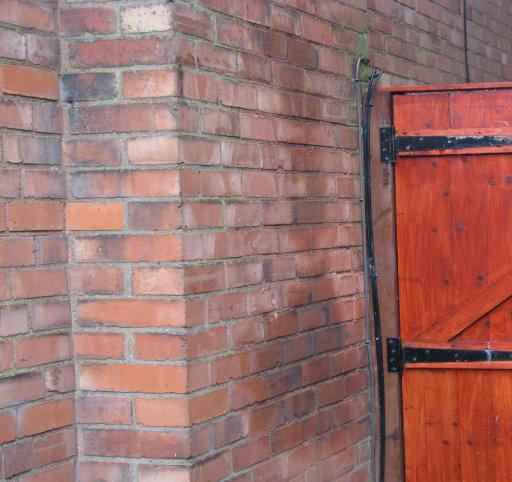

Pointing on chimney breast externally (end terrace) is really bad at roughly the height of the damp patches internally on plaster. Could this be a factor - Could the water cross the flue space?
No other damp in rest of house - some white powdery damp residue on internal chimney brickwork in loft

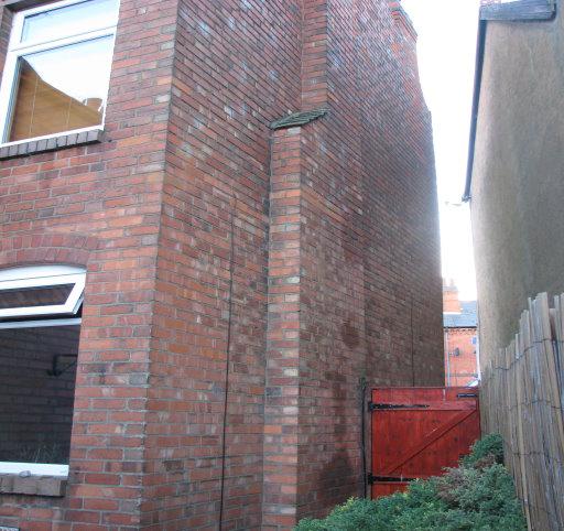

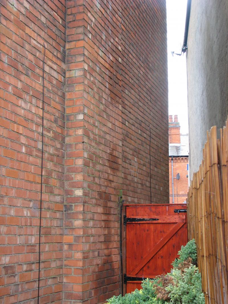

you can see on the external of the chimney breast pathces of damp I assume coming through from the inside of the flue?
These are at a smiliar level to the damp patches on teh plaster internally

Looks like rain is running down the flue.
May be a problem with the pots or the flauncing on top of the chimney

The pattern staining of the flue/fireplace outline indicates excessive moisture within or around the flue. If may be that the pointing is defective, but it would be extreme for that moisture to get to the internal face of the breast, but not impossible - especially if that wall gets a lot of wind blown rain

wondering as well, how the water could breach both sides of the chimney breast - internal and external?

The way those stains are localised, would indicate that the flue is playing a part - either by channelling moisture downwards, or holding moisure in the area around the flue or any linings
Looking again at the pointing, it is quite degraded and the ledges of the bricks catch and hold water, and that granular mortar can soak it up quite well. This can quickly saturate the chimney internally and this then soaks across

Notice that the external "damp" patches move to the right following the one flue only, and stop at the approx. position of the next floor fireplace position. Has work been done there in the past? Are all your redundant flues vented.
You should bite the bullet and get a smoke test done on the gas flue in use ( observe at the second floor fire place for leaking smoke) and all being OK then have the flue(s) swept. This would eliminate blockage and help if sulpherisation is begginning, and also positively indicate which terminal is the gas terminal.
