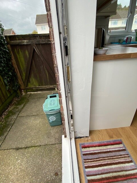

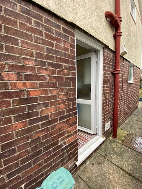

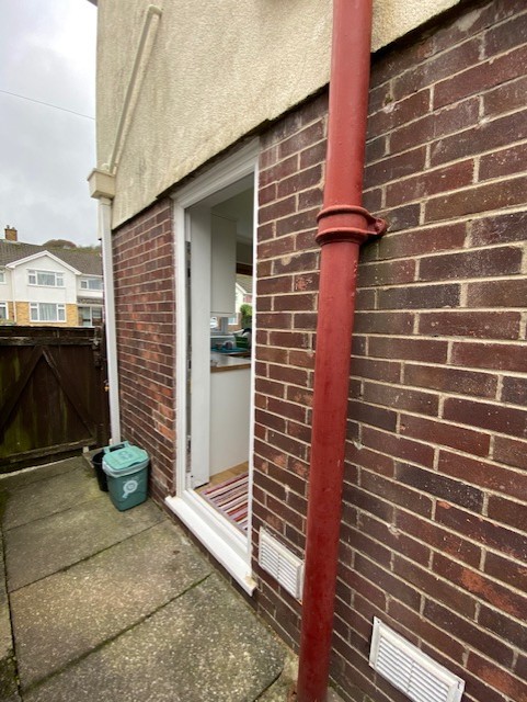

Hi,
I've always had a minor issue with damp on the gable end of our 1960's house. Recently, I managed to get the insulation removed from the cavity on the gable end through the CIGA guarantee. It's a south facing gable in a coastal Welsh town so took the brunt of all the weather.

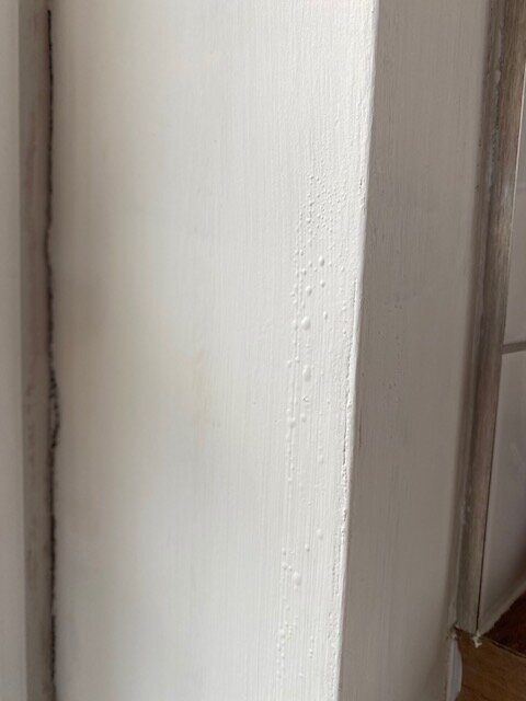

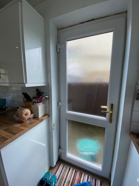

Forward on 4 weeks, I've painted the internal wall with a damp proofing paint along with the external wall. Recently I've noticed that the paint is bubbling in locations and failed in others. This is mostly around the door frame/reveal. The location of the damp issue seems to follow the same profile as the angle bead on the corner of the wall.
I'm starting to run out of ideas as to what the cause of this could be and I'm tempted to get a builder in to reconstruct the cavity closure with a new vertical damproofing around the door frame.
I was wondering if there were any other suggestions to the cause and possible fixes?
