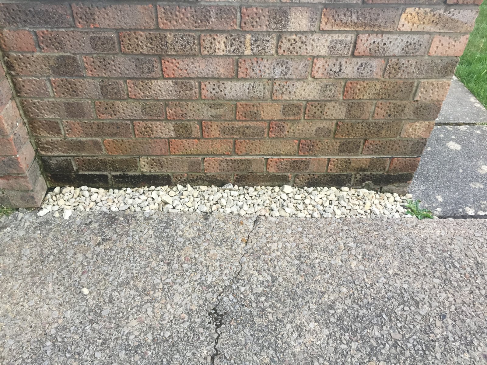

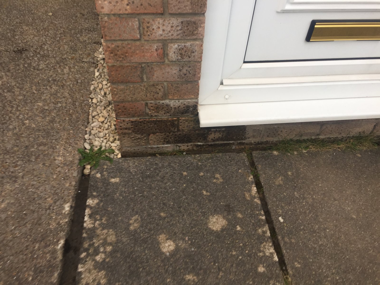

Hi
Just noticed some dark discolouration on lower brick line on our pitch. Could this be anything to worry about?
its rising damp below the DPC and maybe some splash.
there's a little previous re-pointing, and what maybe a shallow French drain.
but, unless your cavity is bridged, its of little significance.
