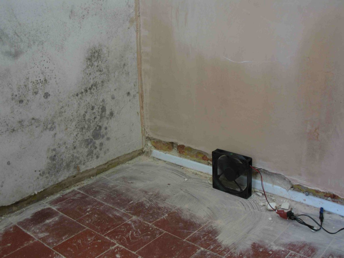

Hi,
I have a room where all of the walls that have been dot and dab plaster boarded, are damp at the bottom. The other side of one wall is dry to the touch.
If you look at the photos, by the spade at the bottom, shows a damp brick below the damp coarse.
Any ideas?
Camerart.
Possible condensate issues where the dot and dab has allowed cold bridging t the base of the boarding, producing condensate and eventually the black spot mould growth, not a good idea for the boards to be sat on tiles either, any condensate will be absorbed by the base of the gypsum boards. Damp brick below Dpc level shows Dpc is doing it's job.

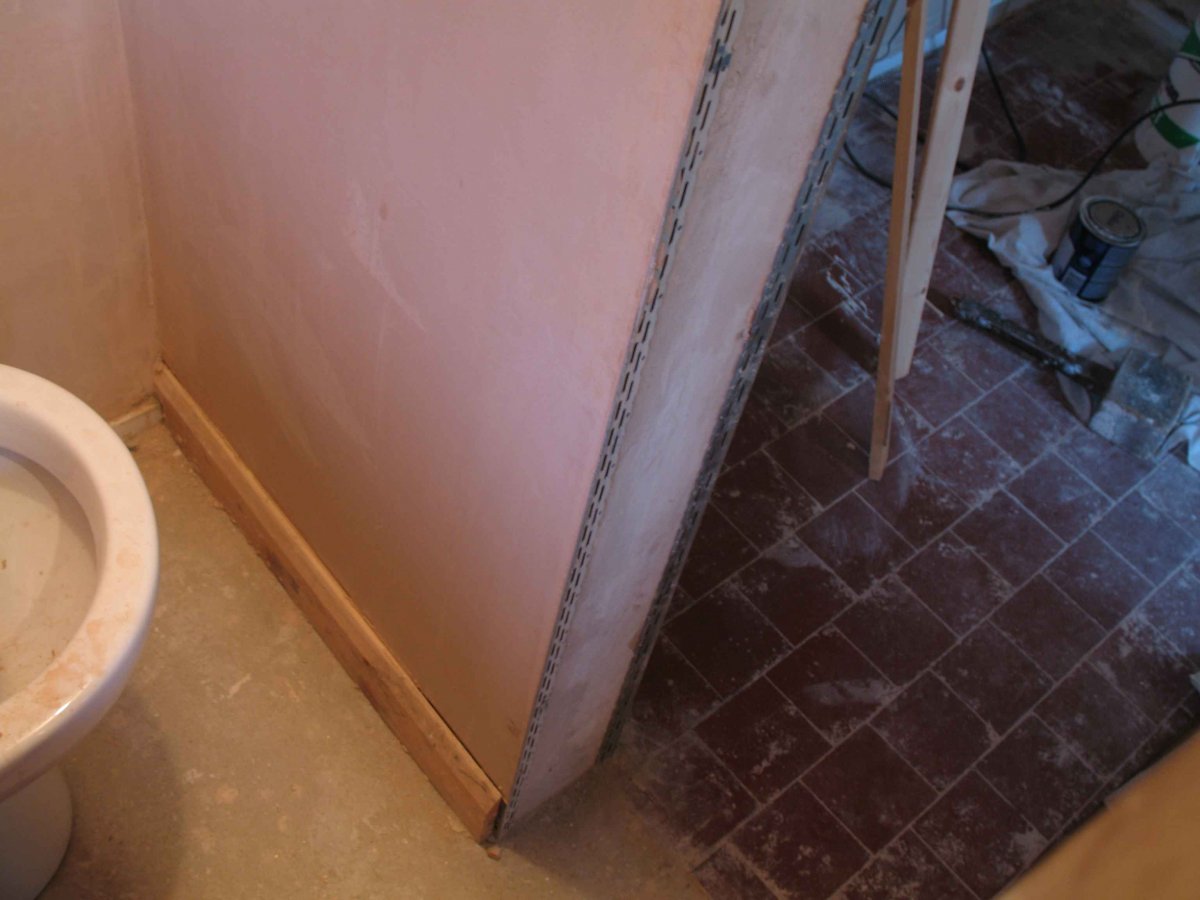

I remembered this morning that the floor level on the tile side is two bricks higher than the exposed side, making a bridge across the damp course. How do I get round this? The floor level must have been lifted up in line with the kitchen floor, many years ago.
Camerart.
The level of the room behind the wall has been lifted to the level at the bottom chalk mark in the photo, with quarry tiles at the top mark.

Your inner floor is bridging the (slate?) DPC in the solid wall - unless there is a membrane below the inner floor? The DPC can clearly be seen in the bed below the chalk marks.
When you have removed the damaged plaster board look for a membrane, and why not post pics of the wall behind?

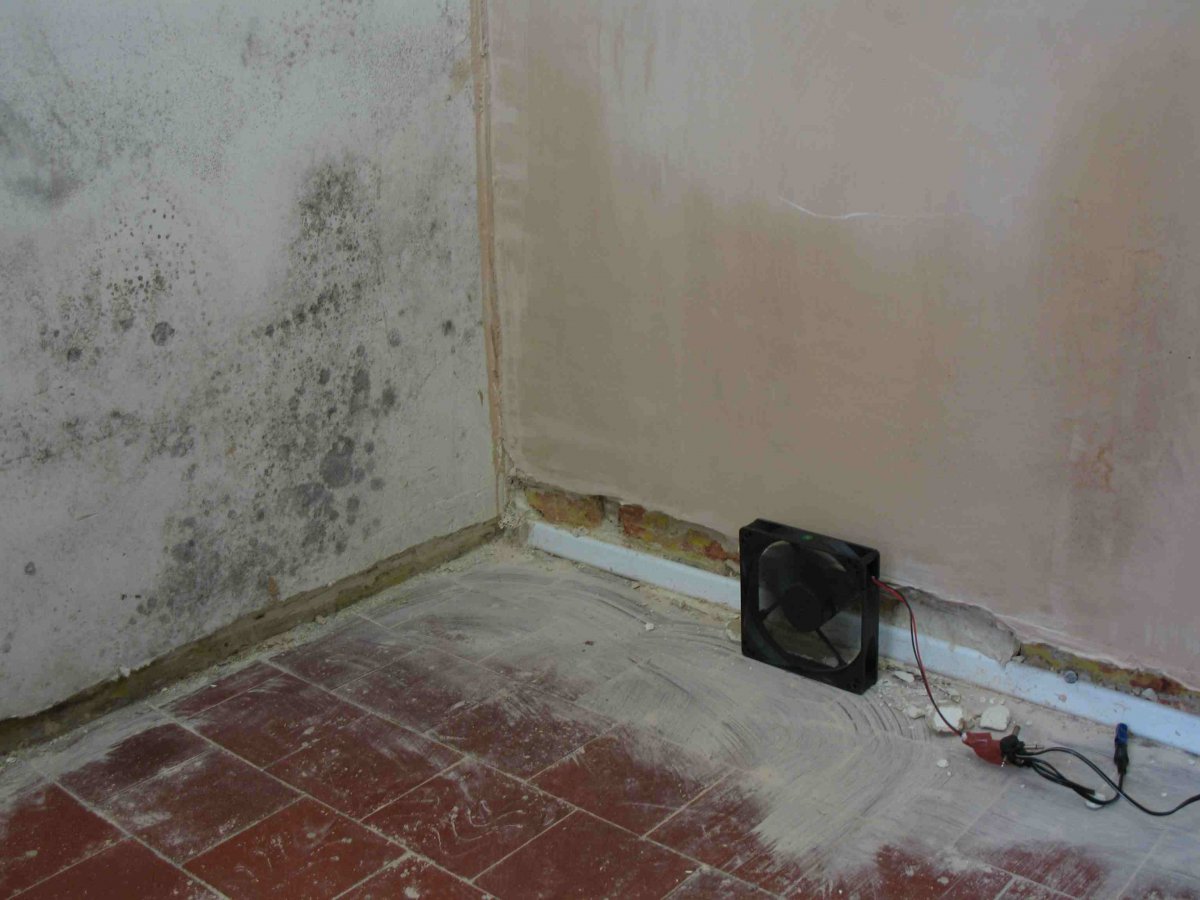

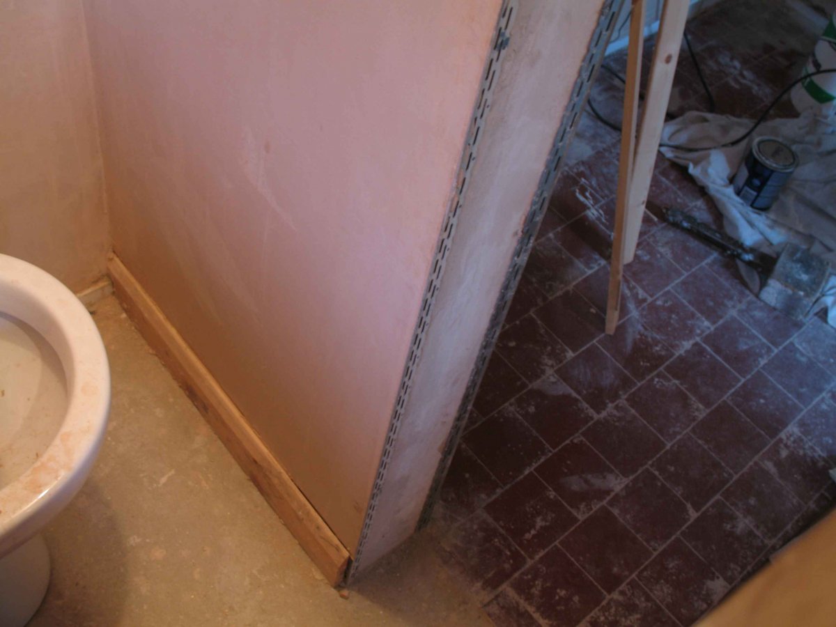

Here are some photos of the other end of the room. Toilet side shows a dry wall, while the kitchen side looks damp. [The toilet in the photo is not fixed;)]
A previous suggestion was that the damp is from condensation because the plasterboard was touching the tiles, a week ago I cut the bottom of the plasterboard. You can see a computer fan that has been blowing for a couple of days and there is a gap where the plasterboard isn't touching the wall, but it is not drying out. How long would it take?
C.

I thought you said that you've "stripped the plaster board out"?
Whats "not drying out" - the p/board (or the wall)?
Anyway, if I understand whats going on then you should strip all of the stained plasterboard - all of it.
Your problems are not your p/board but the underlying cause(s) of any condensation, rising or penetrating damp.
