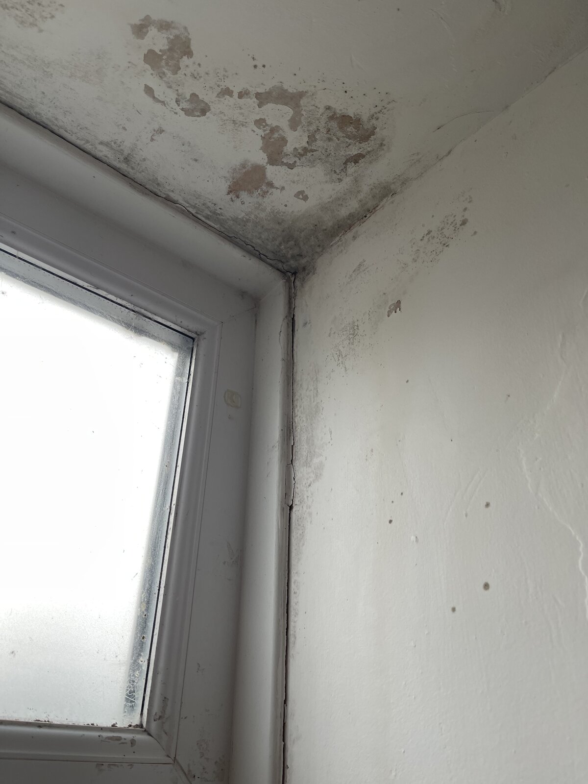

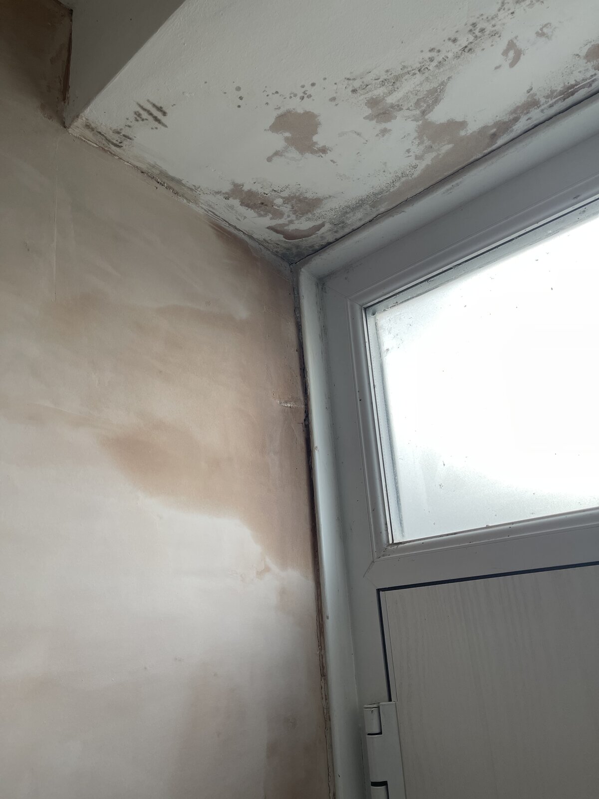

Hi.. I live in a stone terraced house that has been repainted and had new rain water goods and felt support trays. Around 4 years ago we had a new composite front door with a window above it.
After a day or so of heavy rain we get very wet walls on the corners of the ceiling/walls at the top of the window above the door.
Can please anybody shed any light on what this could be? My neighbour has also had rain water good renewed.
For a long time I had these jobs done to solve the water but it’s still happening and I am now thinking is it something to do with the door? Even though everything looks sealed and perfect outside
What are "rain water goods " ??
Pictures would help, inside and out, close up and showing a wide area.
Sorry for confusion, gutters downpipes etc all new! Will get a picture tomorrow. Thanks for a reply!!
See images. They are the top corners of the window above the door. It looks much worse as we are decorating but there’s no ‘damage’ as such. It just gets very wet after prolonged rain

What is above that ceiling?
Looks like a roof leak to me
Unless you dry washing nearby, causing condensation.
To be coming in so high I think that's something above the door, normally door leaks manifest at the bottom as the water runs down the door. What's above the door? Is there another window?
Water doesn't run uphill so i'd be looking at something above the door, pictures from outside would help
The window (bedroom) has no sign of damp whatsoever or any sort of water ingress and the house is repointed etc. baffling me at the moment. Will get a picture of the outside when I can! Thanks all
It may be the seals on the outside of the upstairs window, allowing rain to get in ? If it has concrete window cills it could be those ( have seen it before ).
If the rain is getting in the bottom of the window in may not show around that window. Water finds it easiest path out , which in your case , looks like it's hitting the lintel above the door frame and then seeping into the properties plaster

Update; above the door is concrete lintels with stone work and floor joists above.
Today I cut the joist ends off and cleaned the pockets in the stone work to see if there was any sign of water etc. nothing (but what I can access isn’t as far forward as the front door so I could be missing it still.
Window above the front door drains well - I tested the weep holes in the half open window and it ran clear at the bottom.
Should I maybe drill holes in the bottom of the window frame? As there is no weep holes in bottom of the frame.
Last thing to do is seal around the window as it’s pretty old but doesn’t look particularly bad.
Just another bit of info - my neighbours house is desperately needing repointing and he’s currently renovation due to some damp issues. I’m not 100% but after checking my window I’d say this water could be coming from his side?
Hi. Another update. Still soaking with heavy rain. Window has been sealed on the outside and even sealed under the concrete sill. Absolutely no improvement.
My neighbour has bad damp and I have no other option to now think it must be coming from his badly pointed stone work which is very close to my boundary/front door? It must be moving across the wall some how though which is why I can’t commit to it being his house causing it. I just find it hard to believe that rain is going across the wall and under my window that quickly. But maybe it will.
