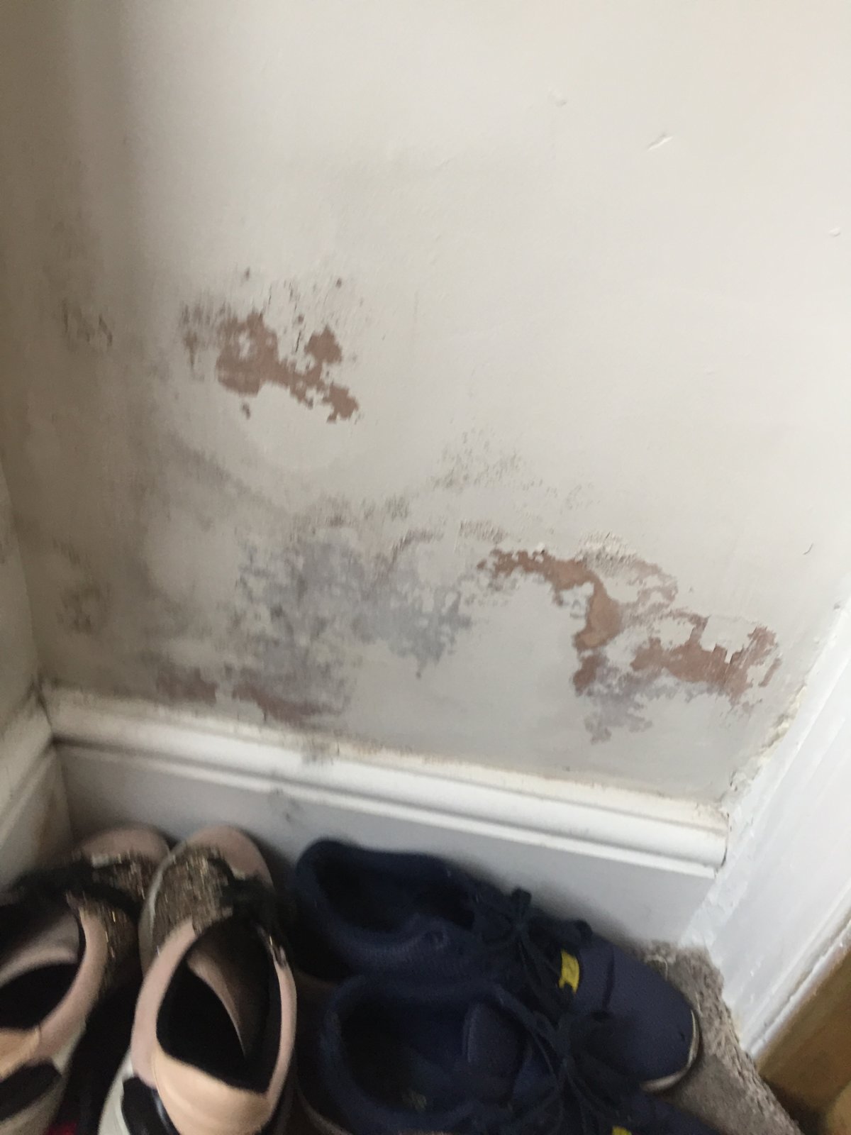

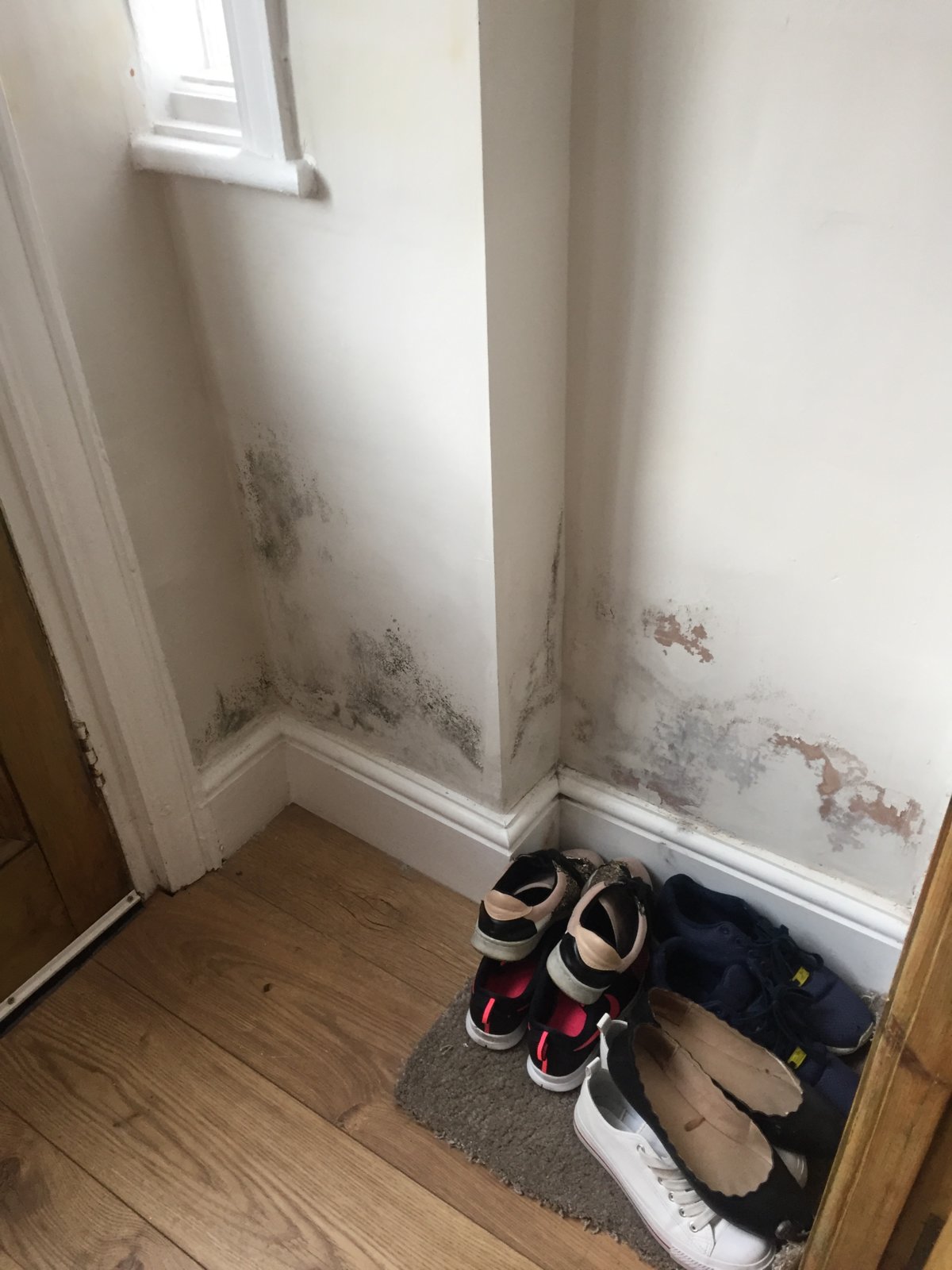

Hi everyone,
I have a small damp patch which has recently appeared in my vestibule and is becoming progressively worse. There is now a black stain on the wall which is getting larger and paint has been flaking off (see photographs). It’s quite cold in this area as I have an original wood front door that is quite drafty.
Obviously I would rather not chip off all the plaster and treat the damp in the usual way. So I was wondering if anyone would recommend a treatment for this such as maybe Zinessa or another damp sealant?
Any help would be much appreciated.
can you post pics of the outside walls and entranceway at ground level?
that looks like rising damp which has attracted condensation.
previous (damp?) work is indicated by the very new skirting in an older porch/vestibule.
the gypdum plaster used is wrong.
at the least, you will have to hack off the plaster back to masonry, up to window board height. and remove & examine the skirtings.
make good with a 4:1 mix of sand & lime and a Limelite finish.
is the floor solid?
are the vestibule walls solid or cavity? do they have a DPC?

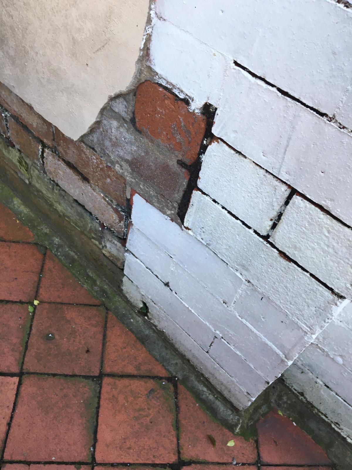

I’ve supplied photos of outside, I can of course post more though if this isn’t the best angle.

rubber, injection hole plugs can be seen but unless the solid wall was injected from inside as well as outside then damp can sometimes bypass the outside injection.
the injection line is too high to protect any joists seated in the brickwork.

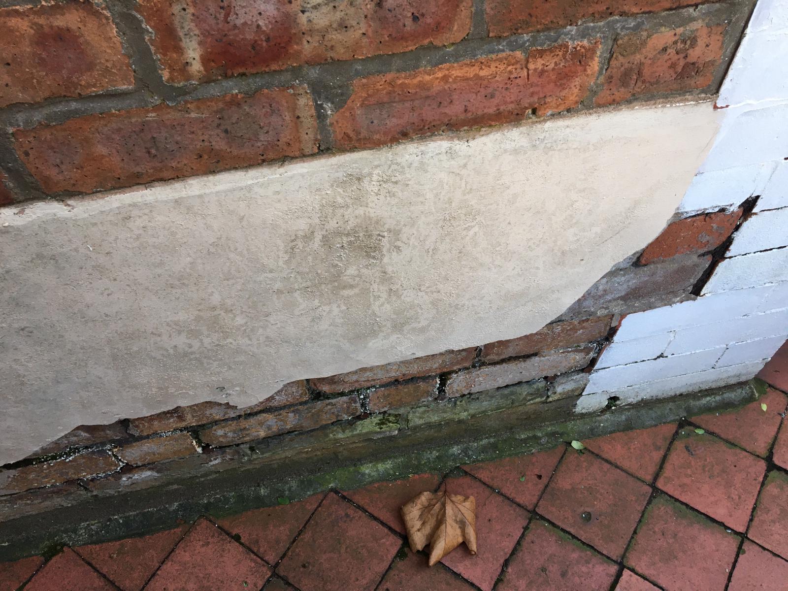

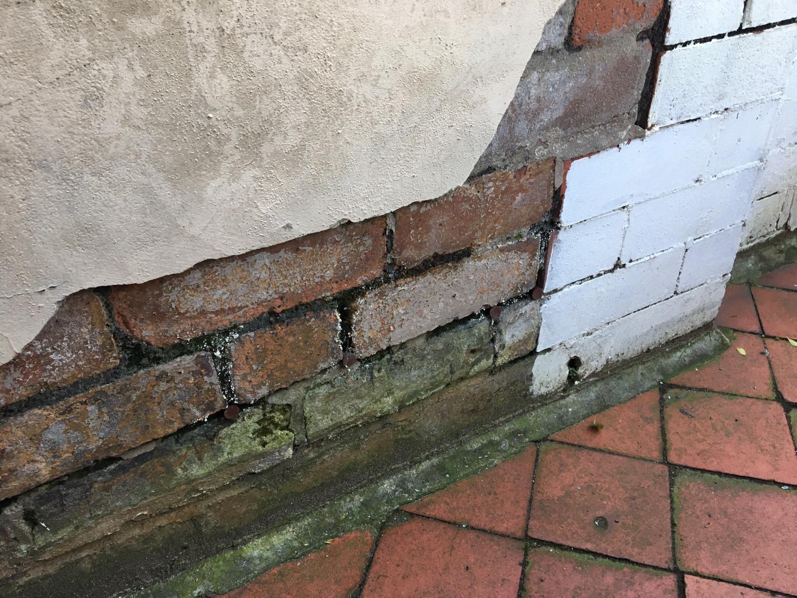

outside, a mortar fillet has been used at the ground/wall junction - this was an always failing attempt to prevent damp penetration. best to remove the fillet.
what is the white square thing on the side wall - paint or a patch of render?
the course of bricks in ground contact looks sodden and green - does the porch roof have well fitted rainwater goods?

Yes you’re right. After your message I’ve inspected the outside wall. To be honest I’m embarrassed I didn’t check here first!
It looks as though some of the pointing has fallen off which could be letting water in. What do you think?
Definitely. Also the joints in the painted section which have algae on them.
That defective render is not helping. Water is running down it and soaking straight into the brickwork. That's probably why that section of wall is bad.
Sort the render out - it should have a "bellcast" along the bottom to cast water off and away from the wall.
When it's all rectified, coat the bottom two course of exposed brickwork with a clear water repellent.
