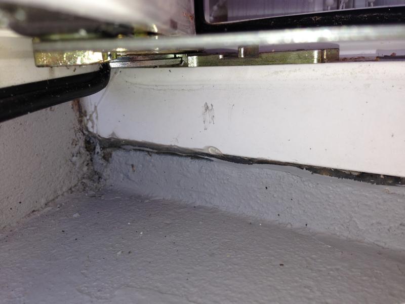

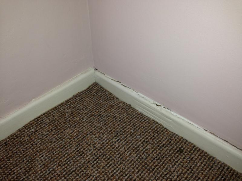

Hi,

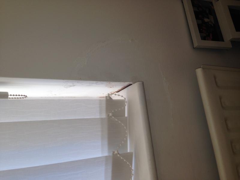

New to this forum. Can anyone help with identifying a possible cause of damp patches on the interior corners of my window cills? it is occurring in both front upstairs bedrooms (Pic 1 and 2). Also in one of the rooms the skirting on the opposite wall to window can be seen in the pic 3, is this an issue, and could it be related damp?

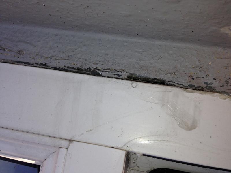

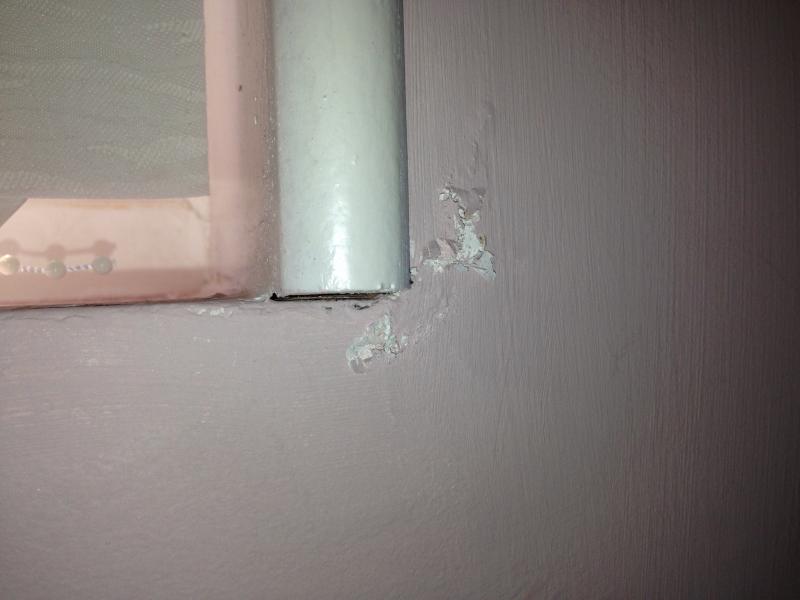

The sealant around the window on the exterior is patchy and in some places missing, could this be a cause? (Pic 4 and 5)

Definitely rake out the old sealant and renew....there's all sorts of bodges there!
As for pic 3,it doesn't look damp - rather the skirting has fallen for some reason.....best lift the carpet for a closer look!

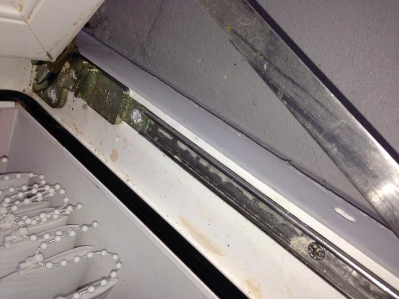

Is pic 5 the top or bottom of the frame? If bottom you should have some drainage holes sat on the frame, this allows any water out. If you haven't then its draining out of the bottom of the frame which could be a problem
Thanks John, I done as advised. Scraped out the old and replaced with a good helping of silicone around the entire frame. I'll just have to wait and see it that was the problem.

DHFrames, both pics of window are the bottom. The drainage holes can't be seen in them. Is this the hole you mean seen in the bottom right corner of pic?

Yep that's your drainage holes, pour a bit of water in to the channel on the bottom by the hinge and see if the water drains out of the holes
