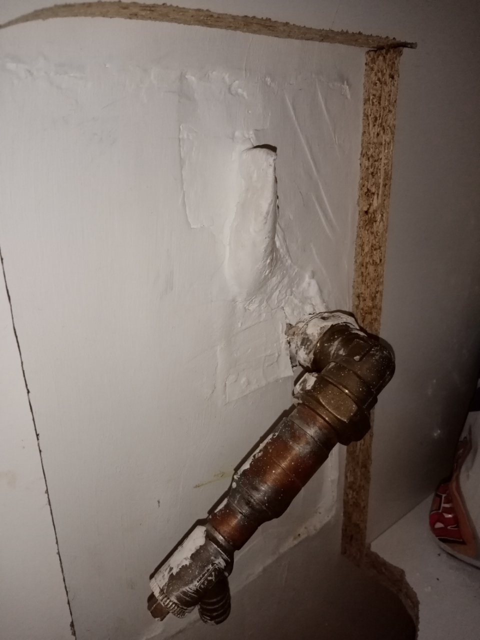

Inside this cupboard is the central heating drainage tap and another piece of pipe crimped at the end. The piece of pipe crimped (literally just squeezed at the end) was like this even when the very old boiler was in place 15 years ago, so assumed it was just a very old disused pipe.
However, did notice tonight that this crimped end of pipe does get warm to the touch when the heating is on which is a bit alarming as the end isn't exactly sealed proper. Just squeezed together. That said, there's no sign of leakage or dampness there.

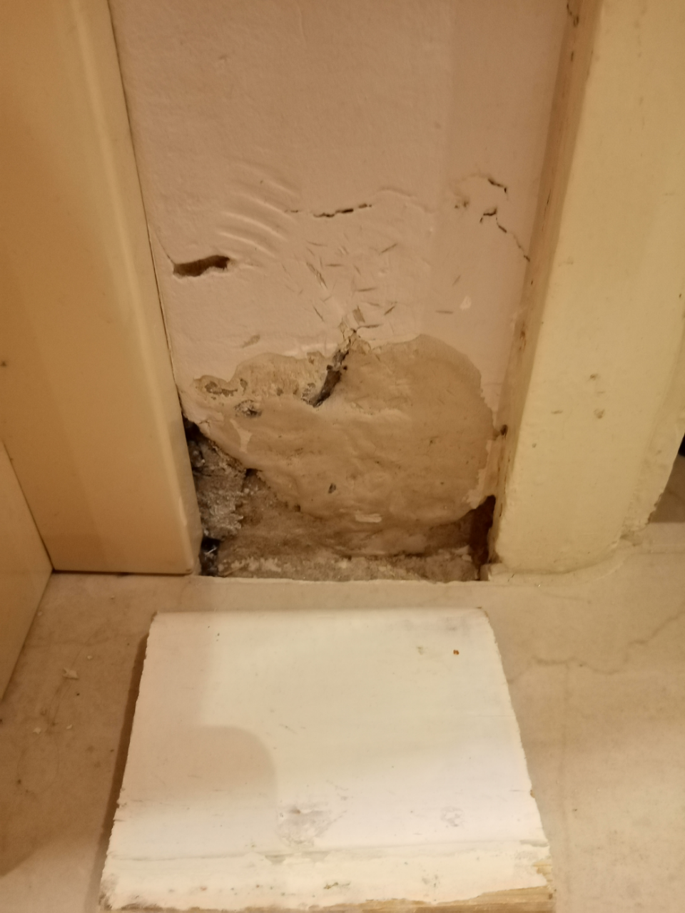

Have attached pics of damp wall and inside the old boiler cupboard.
In the latter pic, you can see the newer drain pipe and the crimped pipe, now painted over.
On the other side of the wall is a toilet with sink albeit about 1.5 feet away.
Have taken away the boxing around the pipes in there in case there was some leak but all looked fine.

Is the floor concrete ? The plaster looks like it's coming down very low ,and may bridge the damp course ?
  • Thanks
Reactions: WSB
Yes, floor is concrete.
What do you mean by "bridge the damp course"?
So dampness coming up via the plaster?
The different colours on the wall pic are the kitchen paint at the top and just plain plaster at the bottom (what was behind the skirting) with some paint flaked away above.
If I leave the skirting off, I think it stays dry as probably continually drying out.
Wedge the piece of skirting in place, then come back later to find it's damp behind.
The position of the problem is right in the centre of the house.
Don't know much about damp rising but is that still possible if in such a central position?
There would be a damp proof course within the mortar ,somewhere close to the first brick level above floor level .If plaster is taken down close to floor level it goes across the horizontal damp course. And moisture travels up the plaster.
  • Thanks
Reactions: WSB
Plaster should never be taken down to ground floor level ,for reasons stated above. That's why skirting is used to finish off/ cover the brickwork that would otherwise be visible.

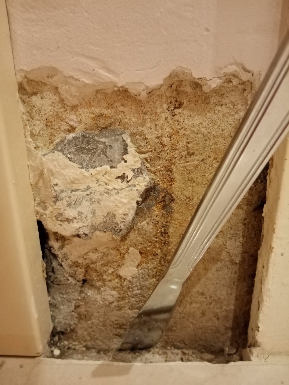

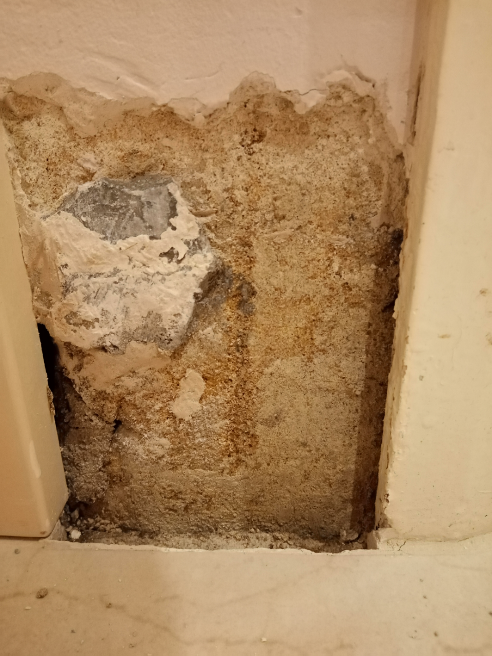

Hi Terry,
Two pics.
First with damp plaster chiselled away.
Second with a knife I shoved down the back. When knife pulled out it was quite damp.
Would I be right in saying that the fact I could shove a knife down there isn't a good sign?
Question is, is the damp at the bottom there all the time or only as a result of the central heating being on.
Need to do some more tests to find out whether the heating being on is a factor.
Have wedged some tissue against the wall about 2cm above the concrete base to double check it's definitely coming from the floor upwards and not from a low part in the wall. As I type though I think it'll be coming up though.
