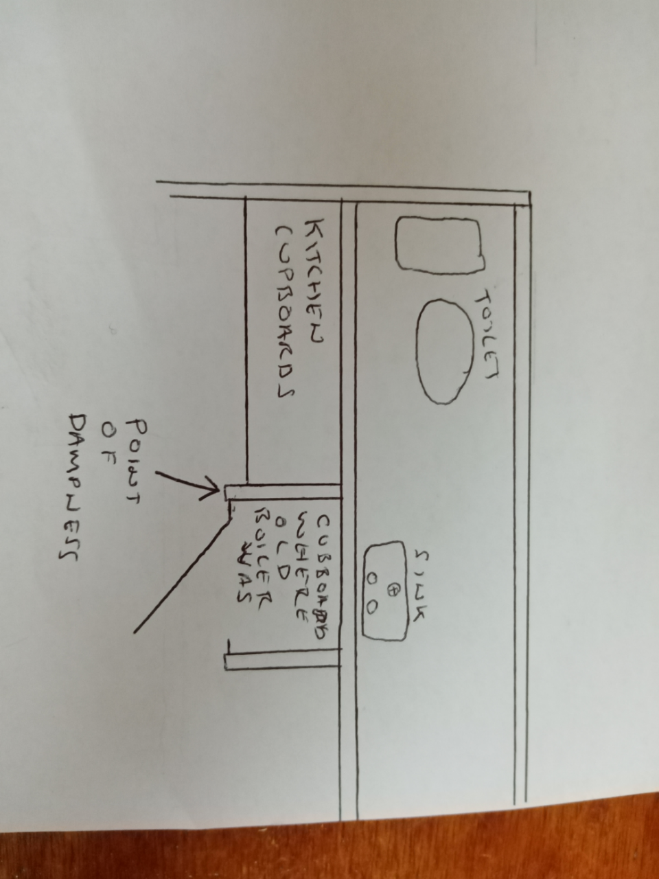

Have you exposed the Bare brick faces ? Your last pic doesn't show brick ? That area seems to be next to a doorway ,what is the wall like on the reverse ? I.e. if you drilled a hole right through the brick from where you removed the skirting ,where the drill comes through the other side,that area ? If this makes sense

Probably easier if I show a diagram. The double lines are where there is a single layer of brick. I have taken away the boxing round the piping in the toilet under the sink an all is dry unless the leaking is below the concrete floor of course. Before we had the old boiler removed 15 years ago there were signs of some water leak, presumably from the old boiler so maybe some of this issue is historic.

Is there skirting on the other side of the wall ( boiler cupboard side) ,same bricks, just their other face ,that shows damp signs ?
Are there any pipes buried in the concrete floor ?

The boiler cupboard side is tiled on the floor as is all the kitchen. No skirting board in boiler cupboard, just plasterboard down to the floor. No sign of damp in there. There are pipes buried in the floor around that area as when the heating is on, the tiles in front of the area I've been talking about get quite nice and hot in places. Always been like this since we've lived here (16 years).
To be honest, when I shove a knife down the gap between the wall and the concrete base in the suspect area, it's only ever so slightly moist, possibly not much at all. Could be some condensation occurring due to the hot pipes and colder concrete. Am thinking about just cementing that small sliver of gap in and replastering that little area down to an inch above the bottom. Give it a while to ensure the plaster is no longer getting damp, then stick the skirting board piece back over.
Yes ,no need to go as low as 1inch close to the floor. I would leave a 2 inch gap at least.
