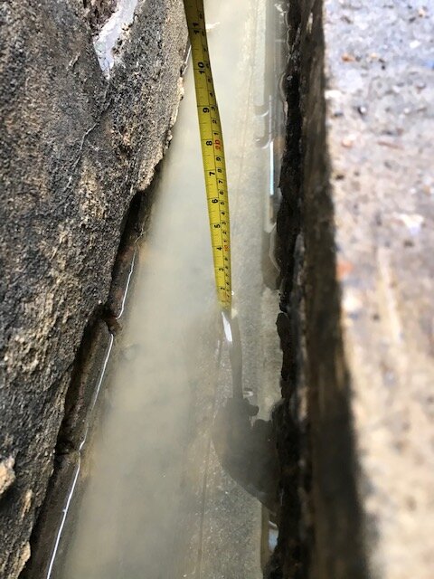

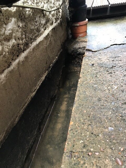

I think I've found out why I'm getting the damp too. 90 mins ago I had heavy rain and now the gully is full with 2 inches of water sitting on the footings and not draining away - see photo. I think I will need to install a channel drain? Can I connect it to the waste down-pipe at the end of the alley? The path slopes that way anyway.

It was suggested that the soil pipe would be a fly in the ointment for drainage - maybe it is?

You say you have a gulley at the rear elevation so maybe that would help with any Aco drainage? Whats certain is that you will have to find a way of disposing of the water from the front and side elevation channels whether its from a French drain or an Aco?

=> Sorry I didn't know what you meant the first time you mentioned it. My question is can the channel drain be connected into the soil pipe?

=> Yes I plan to do that but even after removing the plinth having standing water sitting against the brick work isn't going to be good either hence the question around the channel drain.

=> Yes that is my question of whether a channel (ACO) drain will do the job and can I connect to the soil pipe?
(And to note 5 hours after the rain stopped I've still got over an inch of water sitting there).
I wouldn't mess with the soil pipe - it would probably lead to knock-on complications.
You need someone on site to take you any further.
You can only connect to the soil pipe IF you have a combined sewer - rainwater and foul. Then you need to make an underground connection via a trapped gulley for the surface water.

I may have a combine sewer as currently I have rain water from my conservatory going into a drian with waste water from the kitchen / bathroom. But I'm going to get a plumber round to have a look and go further. In the meantine I've taken the plinth off to let it all breathe.
