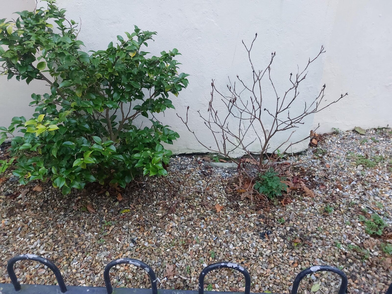

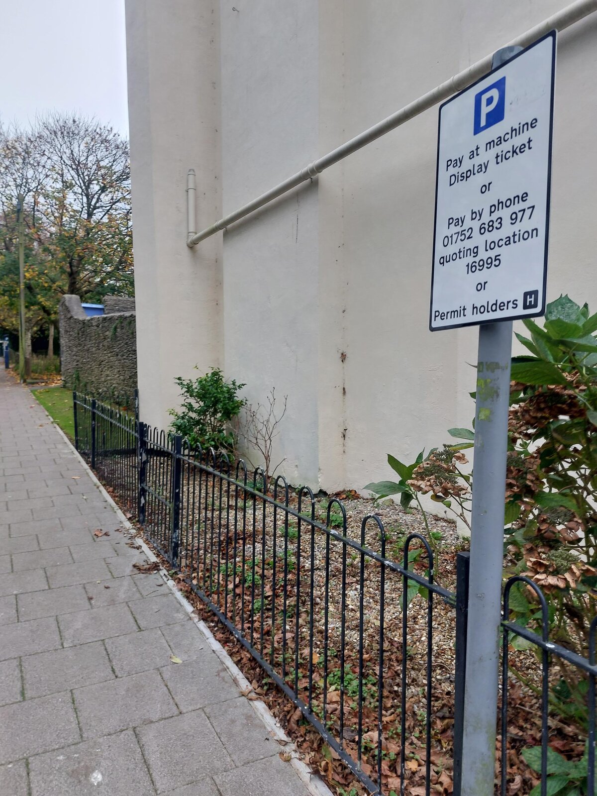

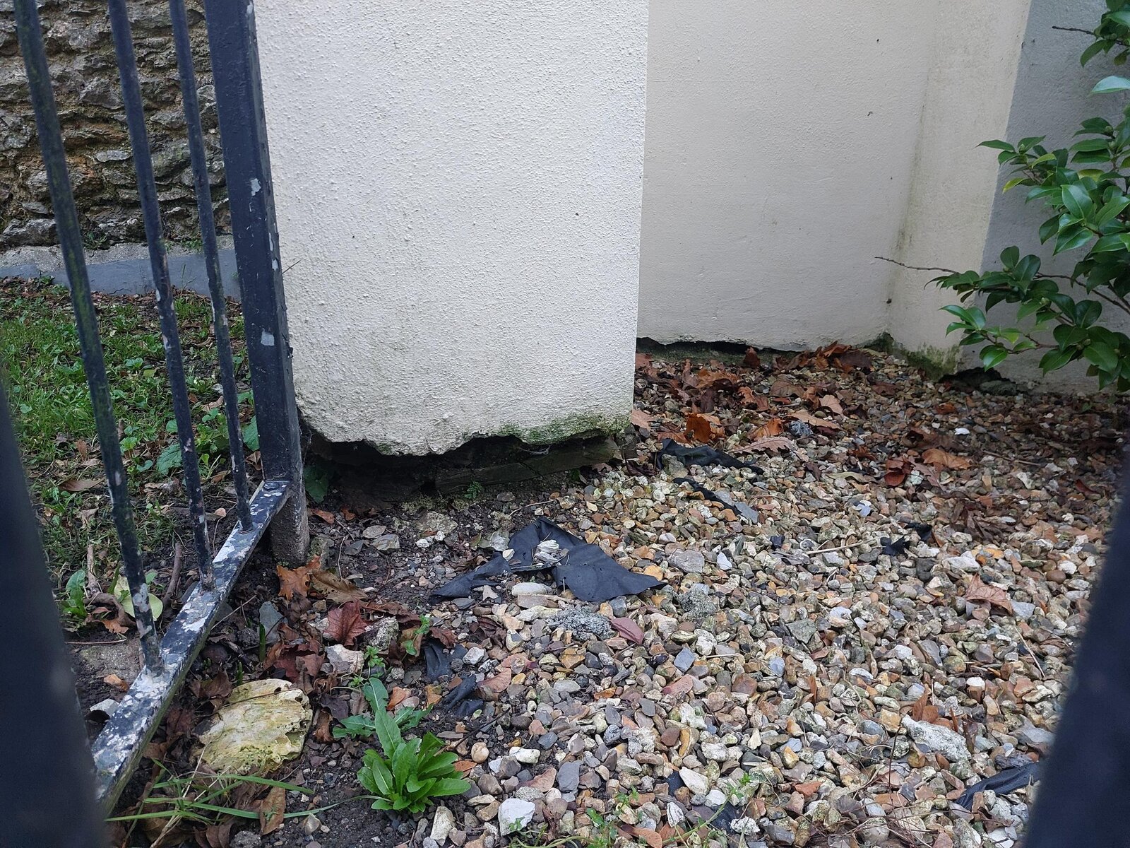

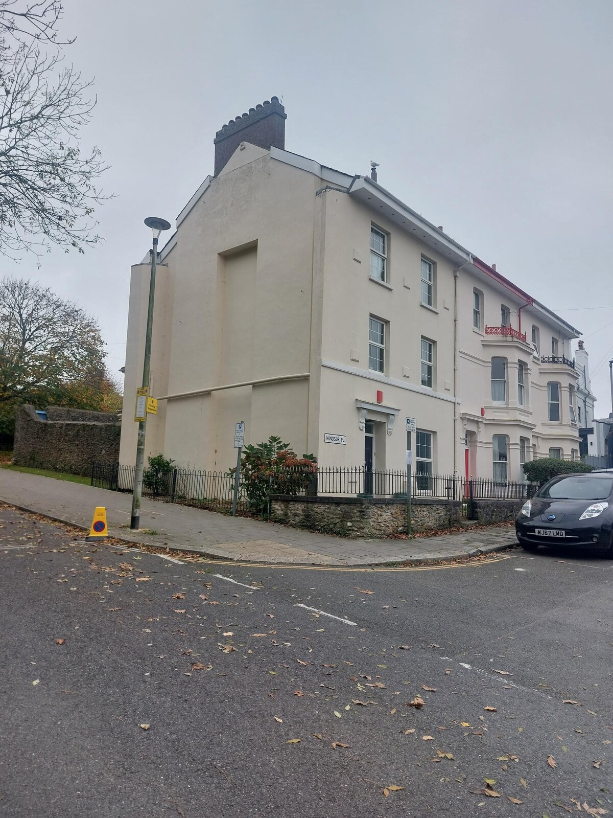

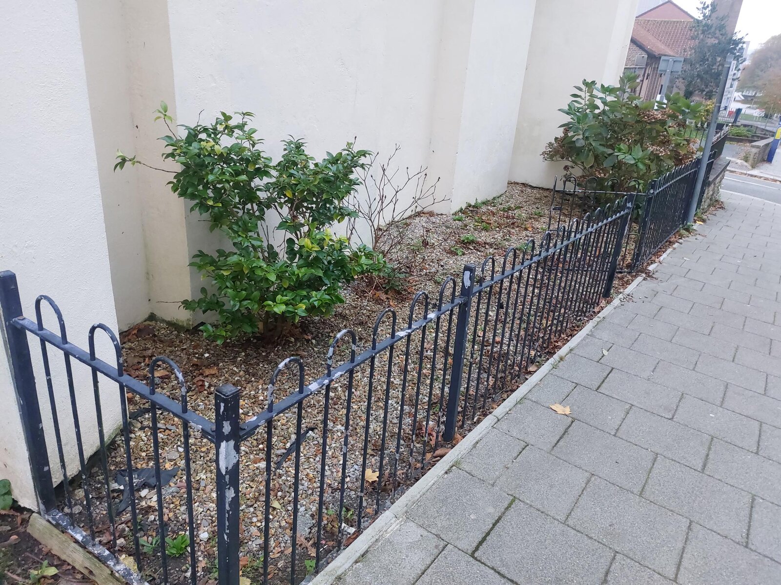

Morning,
I bought my house recently and the survey showed high damp readings in the basement on the side of my house. The side garden is also slightly higher than ground floor hallway, so surveyor advised to reduce the side garden level (I’ll dig down 30cm) and improve water run off as any water hitting the side of the house is running into the side foundation, probability causing the basement damp. Basically at the side of the property there are wall remnants from the previously demolished adjacent property 60 years ago and no path was ever laid.
So my question, what could I do to improve water run-off on the side? I was thinking about digging down (so that side garden is lower than hallway 30cm), then laying a patio slopping away from house with a drain gully on edge of property to take water away? I have asked a renderer for a quote to put a plinth at the bottom also.
Or do I lay contrate path? Or waterproof membrane with gravel on top? What would you all do?
Matt

Your cellar wall is in contact with the earth, so will always be damp. The wall may have a DPC. For a start, find it. The ground level must be at least two bricks lower than the DPC and your internal floor. This will prevent the wall above the DPC bring wet, and reduce risk of your floor joists rotting. The DPC must not be bridged by render, plaster, earth or paving, inside or out.
You might be able to make the ground less damp, if you put paving on it, sloping away from the house and also running towards the road, with a gutter to catch and lead away rain from the public path. You will never make the earth dry or lower the water table.
Look out for any nearby pipes or drains that may be leaking into the ground, and repair them.
You should ventilate your cellar to reduce water vapour.
It is possible, at huge expense, to apply waterproof lathing to the inside of underground walls so that penetrating water runs down to the floor, to excavate and drain the floor, and to add new false walls and floor on the dry side. You will not prevent water getting into the walls.
