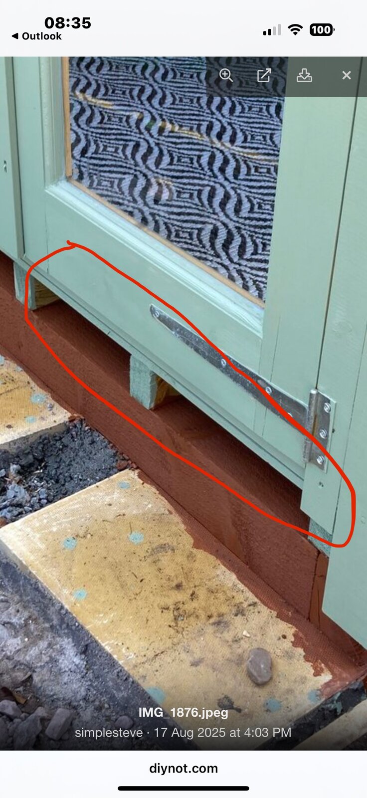

Only as you were looking for photos/ideas …

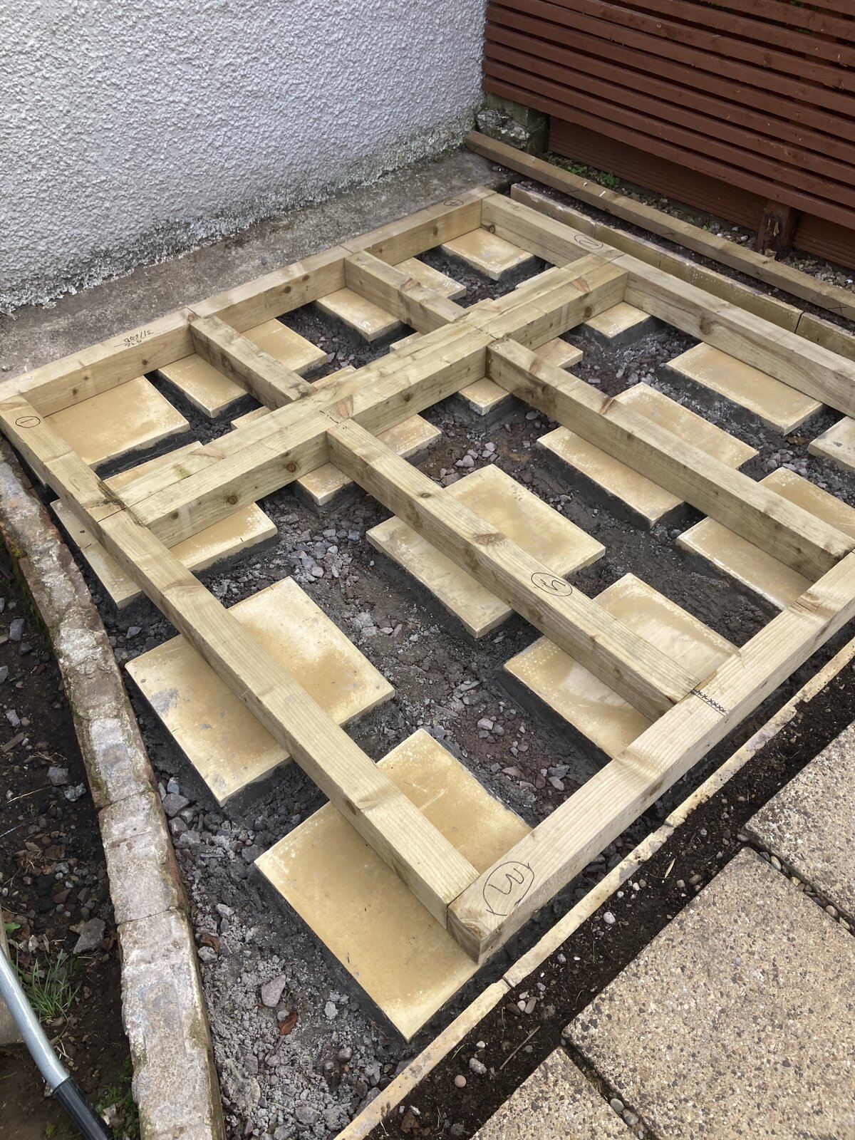

At this point can i put the osb flooring down then start? I see yours has that gap with the bearers going across but as mine is on block paving and there will be a gap underneath the slabs can i just do that?
I don’t see why not; though I’ve sealed the gaps off between the slabs to stop mice getting under it, and having bearers on top of a frame means there will always be air circulating under it to help keep it dry.
I might just add bearers underneath the frame on top of the slabs or keep it how it is, I’ll see if i can do it within my budget

Anyway, I made my base first, out of Pressure Treated 4 x 4’s, put on top of a concreted in slab/pad at every join which was levelled.
Worked a treat, but had to go back this morning and throw a handful of concrete between the slabs :- mice had moved in and we’re driving my dog nuts !
Tommorows job is nailing the rat mesh across the floor bearers….
This is essentially how I did a shed years back, levelled and compacted an area of soil, laid 4 rows of slabs, laid 4x4 posts on said rows, base of shed laid over the 4x4s, shed constructed. I didn't have any dpc between anything.
A decade later the shed was still perfectly dry, no damp. When it rained (and being in Scotland this was quite frequently!) yes water was absorbed by the 4x4s, however the shed base never seemed to be affected. I think what undoubtedly helped was the void under the base created by the 4x4s which aided airflow.
