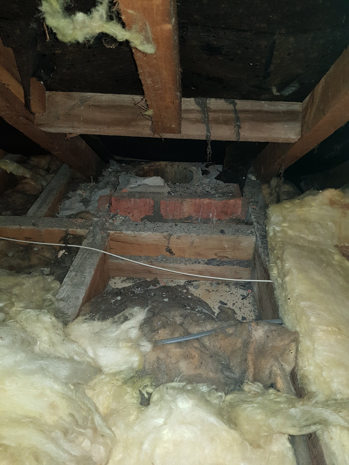

The chimney has been removed below roof level and not capped as the clay liner can be seen under the loft insulation. There are no signs of water entering the loft.

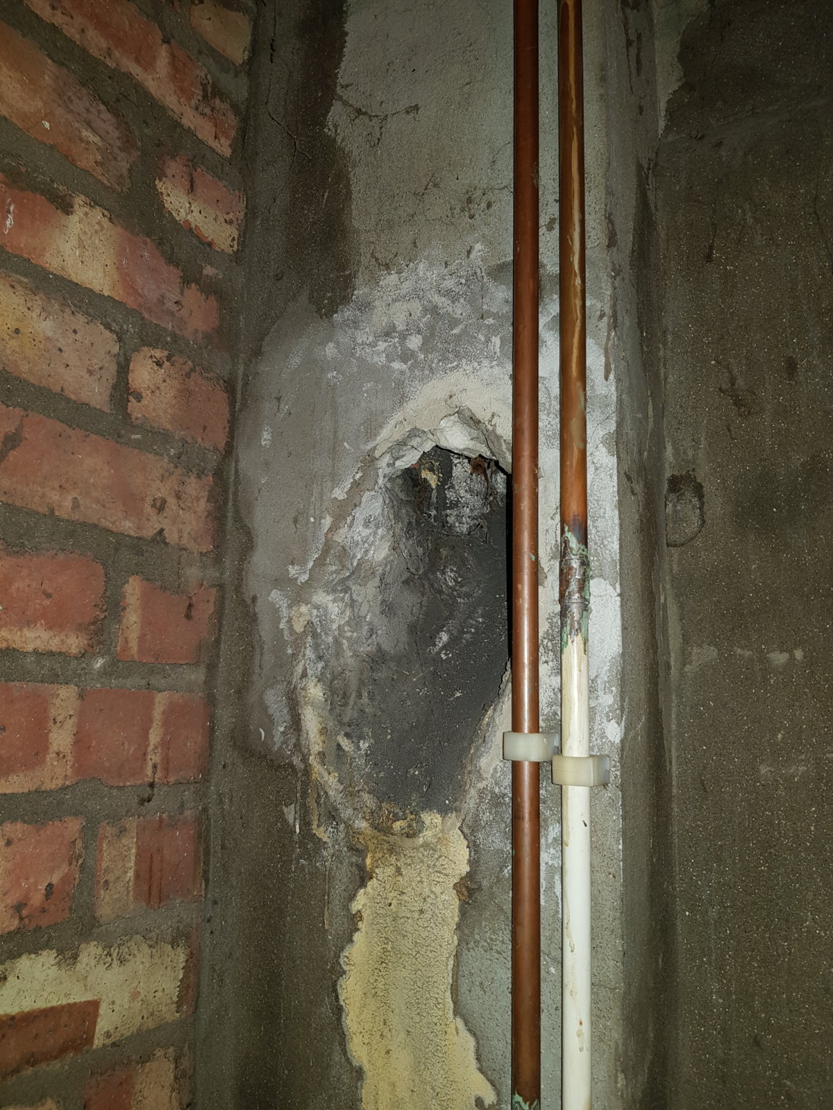

I'm struggling to find whether the bottom is vented as its behind a lot of cupboards/panelling which will eventually be removed with the refurb. A part of the chimney breast is visible in the garage below the bedroom with no signs of damp but it appears to have has a hole created in side? I'm still unsure why this would be and will try and upload some pics.

1. Does the exposed chimney liner need to be capped/insulated?
2. If not, do I cover with insulation as found or leave it breathe?
3. Is the amount of condensation and damp feel in room directly linked to uncapped chimney breast in loft?

Not sure if photos are uploaded but this is chimney
If it's condensation, then you are producing it and you need to deal with that.
Use of ventilation, extraction at source from kitchen and bathroom, and heating patterns.
OP, why not post photos of the bedroom including the c/breast and the window?
there's no signs of condensation or water penetration in the loft. so, as above, presumably you are producing any condensation in the bedroom.
leave the loft flue alone - as it is in the pic.
the "hole in the g/f chimney" could be where a previous boiler flue had entered the brick chimney breast?
the yellow staining could be leaked condensate?
or it might have been an ashes clean-out hole for any solid fuel fire above?
looking up the hole, i can see strands of fibre or wisps of insulation - what is it?

I managed to speak with previous home owner who said that hole in ground floor chimney was flue for an Aga.

I have left the old chimney uncovered.
