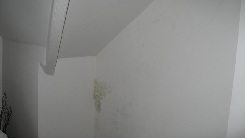

Hi there
Got some interior damp but already had the roof done (they cleared out the vegetation and painted a sealed a the top of the party wall). The neighbours also did likewise their side.
But ... it's come back, It's a small patch but persistent and some other coin sized area are a little damp.
What should I do ? Get a roofer to go up again - or is that a waste of time ? What if the source of the problem is not obvious ?
Is it better just to hack off the damp and mould and paint with breathable paint and wait until it gets bad enough to trace the problem ??
Cheers

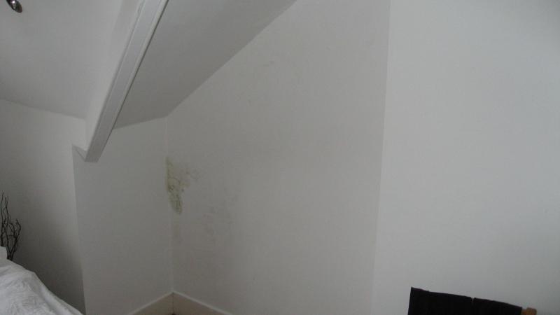

Yes there is flashing between wall and tiles. And there is a "gable" at the front. So there is a V shape wedge at the front of the roof on that side which is flashed and has had some veg in it in the past ... but actually have a sim problem on the other side and the neighbours too so it seems like the terrace's masonry has reached a similar point.
My problem is that since this crappy seal has been put on there is still some small leaks coming through that wall ... and I don't know how easy it is going to be to see it ... from the pics there is a green patch that is coming through about 1m below the ceiling on that wall ... plus some other assorted little wet patches.
In the pic to the left of the green patch of mould is a plasterboarded section of the room ... possible that the entire V above is bleeding behind that plasterboard.
At the summit is a chimney stack, on the other side is another house in the terrace.
if it's a mortar fillet it probably wants pulling off and lead flashing installed.
