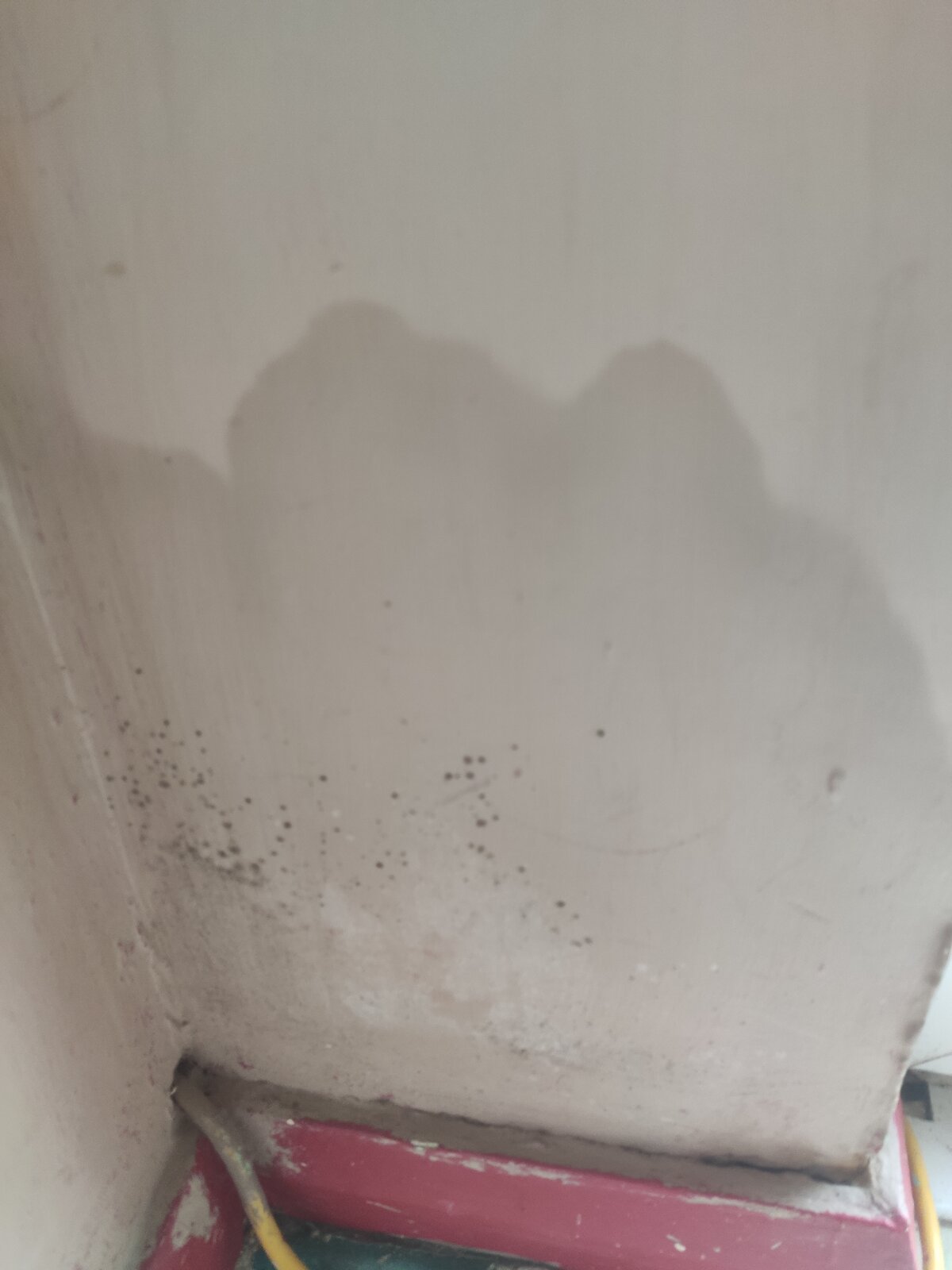

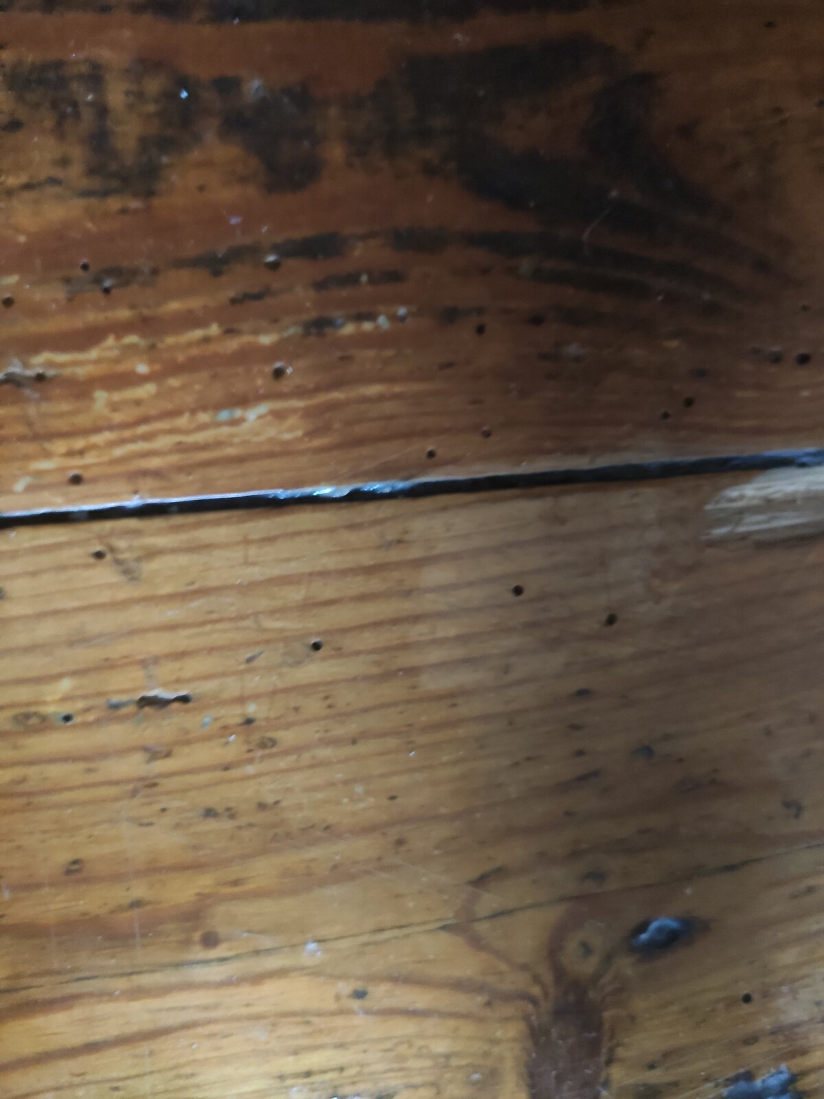

Pics as promised. The pinholes are spread across a fair bit of the living room, can't see if it spreads to the kitchen/hallway as these are tiled.

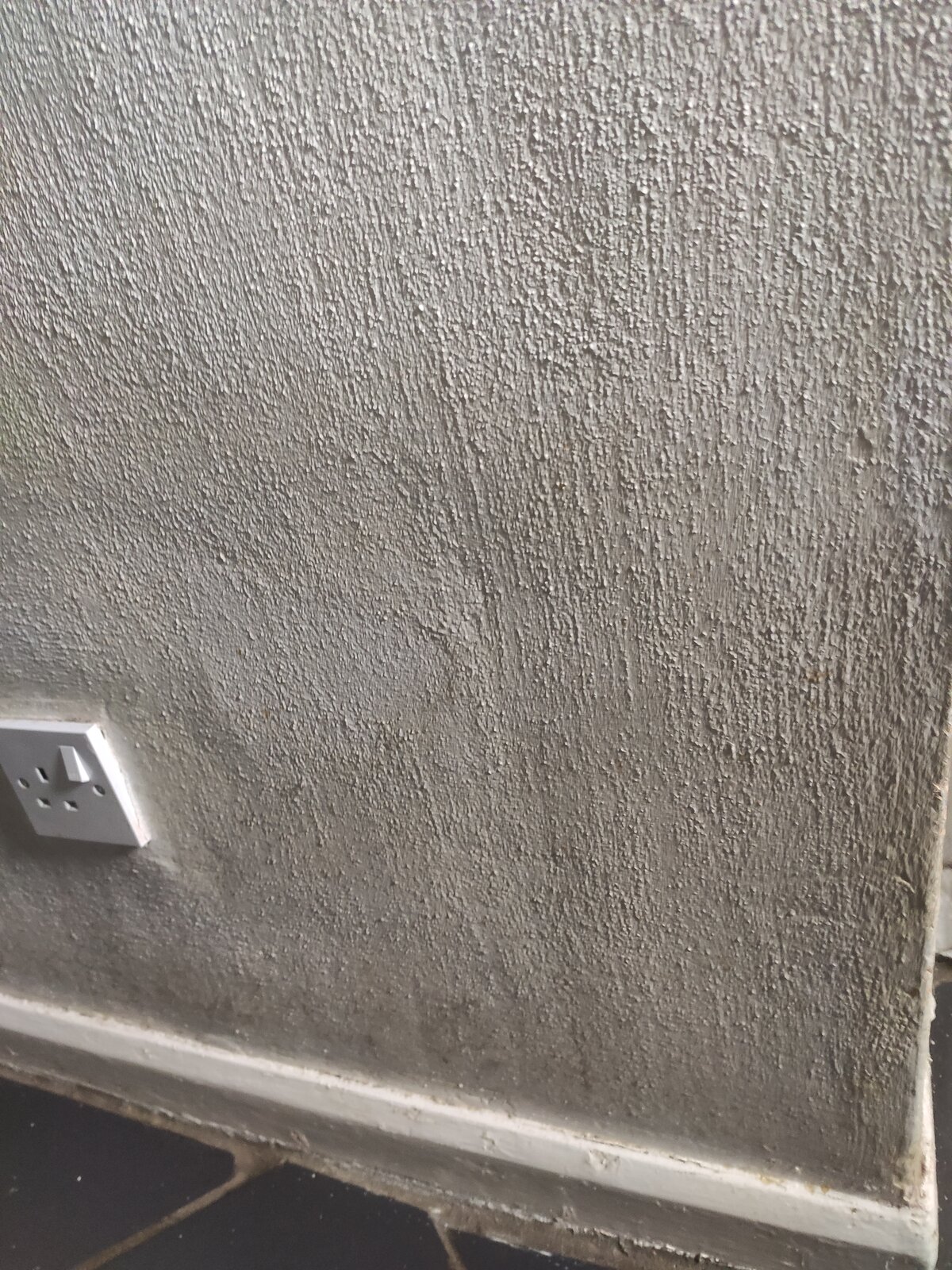

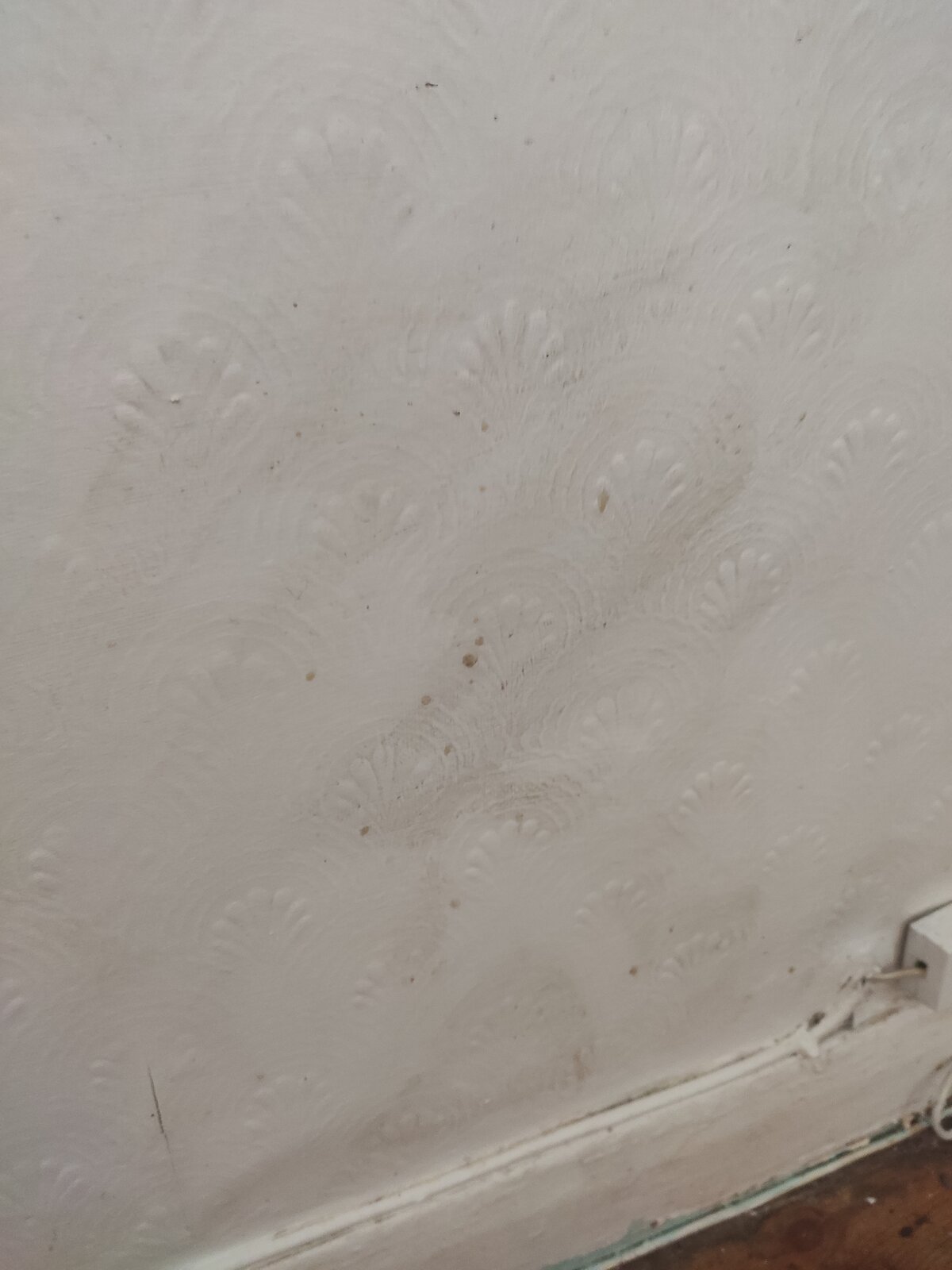

The pics showing what I presume is damp are, in order, external wall under living room window. Internal wall at bottom of stairs & external wall under kitchen window but not near sink or pipes.

That woodworm looks historic to me. What makes you think it is active, have you seen definite bore dust? (known as frass) Surveyors look for bore dust around Spring time. You’re unlikely to see any this time of year.
My advice is hold off on any works until you know exactly what is causing the dampness issues. First thing is to establish 100% if there is dampness within the masonry. Not on the surface, WITHIN the masonry. You'll need to get it tested by an independent. i.e. NOT a damp proofing company.

You undoubtedly have rising damp, and a little condensation.
There are signs of previous attempts to deal with the damp.
Can you gain access to any crawl space below any suspended floors?
