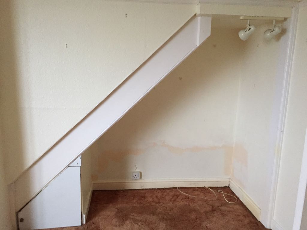

The survey has thrown up a few things I knew about, but I'd not spotted the damp on the side wall and potential issue to the timber floor.

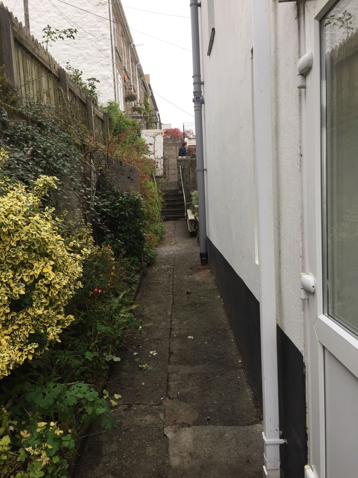

The side wall of the property has a concrete path running alongside and one downpipe discharges onto this path. The path is above internal floor level.
Some of the floor boards against that wall have been replaced with board. Couple of square metre, around the down pipe.
That wall has some damp around the down pipe. Further along the wall is the chimney with back boiler (cowl fitted) with a floor vent. Boards here appear to be fine.

Internally taking plaster away is fine as we have a full refurbishment to do. I'm a bit more worried about the timber floor. I think it's ventilation is poor, but I'm struggling to see how I improve it without some sort of snorkel type affair on the side wall.
Fix that before anything else - could easily be the entire cause of the problems.

I am not an expert but a French drain would probably help?
I.e. Remove a strip of path where it touches the house, excavate a narrow trench and fill with gravel so that it drains away. Presumably requires somewhere for the water to go but quite simple and cheap.

To my mind, if I stop the water splashing against the render, get that downpipe away to a small soak away, chop away the internal plaster, vent the floor and repair anything suspect with rot in the floor ; I'm doing about the best job I can and I should not be considering burning 50 pound notes.
Tiger, I was considering cutting the concrete path and installing a lined filter drain along and away from the house. That's within my skill base too.

Basically solid walls work by drying out quicker on average than they gain moisture.
The first step is to stop all sources of water as you've suggested, so pipe all drains away and check for splashing etc.
Then ensure all paths slope away.
Then look at evaporation, so dig out beside the wall or ideally lower the whole path to keep water from soaking through too high up and increase ventilation down there.

Regarding the floor, the same logic applies, so you need it to dry quicker than the damp gets into the dirt. You also need general air flow around any timber down there.

Super, thank you for taking the time to respond. I'm less concerned than I was earlier, but I need to go have a closer look at the floor in that area.
Best images I have to hand of the side path, down pipe and an internal photo.

Looking at the first photo it looks like it may be possible to lower the level of the path.
Probably, there is a retaining wall to the left so I'd not want to alter levels too much.
The retaining wall shouldn't be a problem. You could have a dwarf wall along side the slabs and drop the path. Having an external ground level higher than your floor levels is a common cause of damp problems.
I've lowered the levels on a few properties over the years and the owners were really happy with the results.
Thank you Stuart, sounds very sensible. I'll check on the utility situation too, in case anything would stop that. That will be a fun manual job as there is limited access.

At the front I ended up with a slope as the pavement is significantly higher than the doc, so we put in a narrow flower bed and a slope on the drive.
I'll hope it's just a thin layer of concrete.
I'm minded to remove the path entirely and not put it back (it's not a right of way).
Disposal will be fun as the biggest thing I can get to the front would be a transit style tipper.
