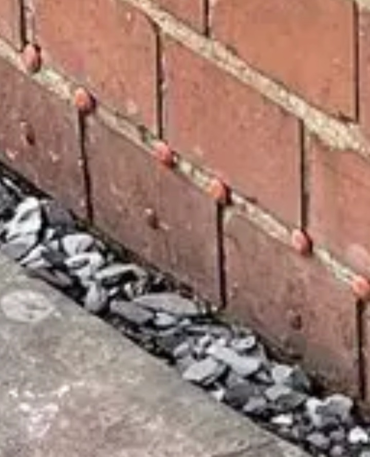

The concrete seems to have covered up the old drains. See if you can take some pics down the gaps round them. Also any signs of cracking or patching of the concrete above and around them.
Scrape out the chippings as deep as you can with a garden trowel. This should expose the real DPC. Look to see if the trench fills up with water after rain or after a bath.

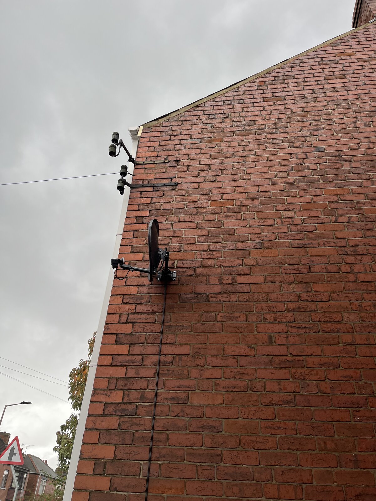

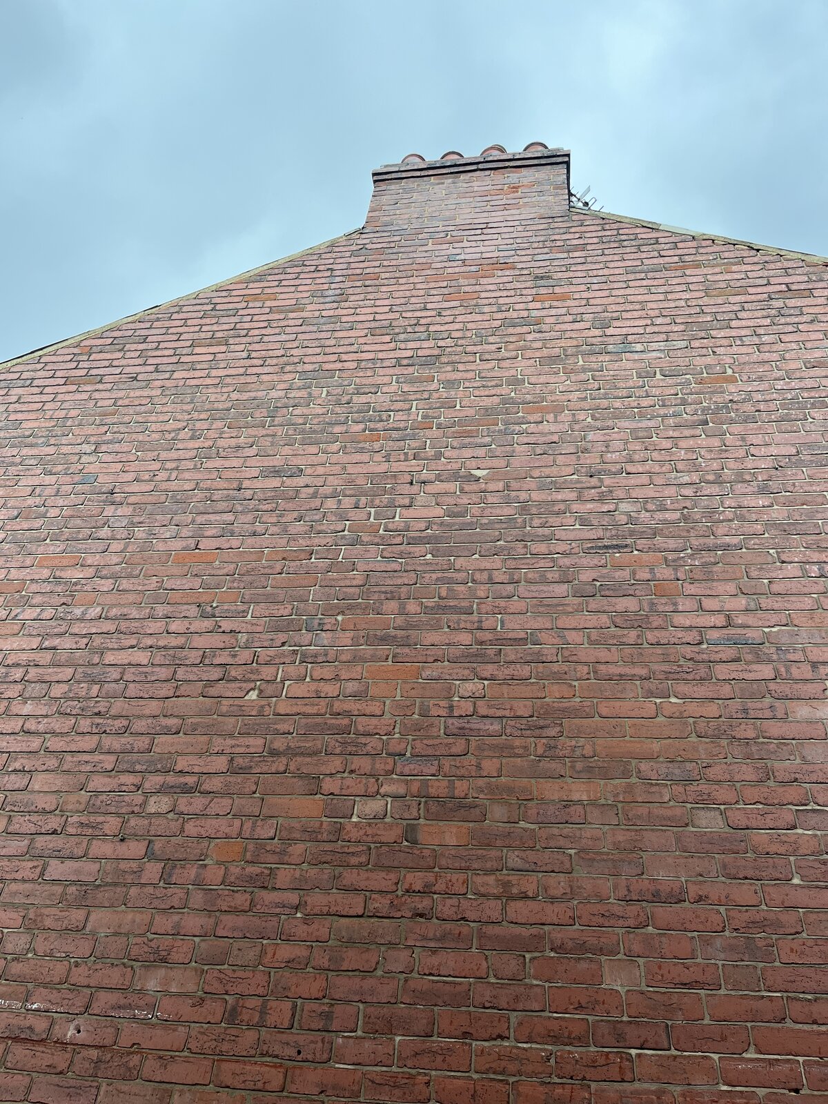

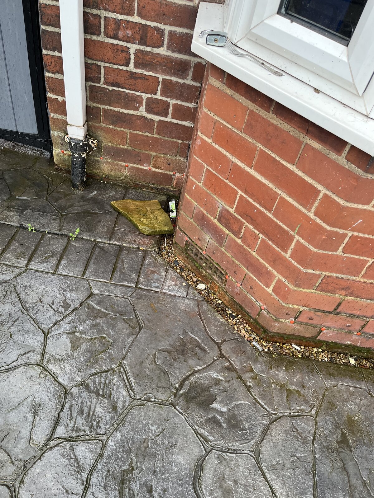

Please stand back and take a wider pic of that entire wall, all the way up to the roof, and especially the gutter.

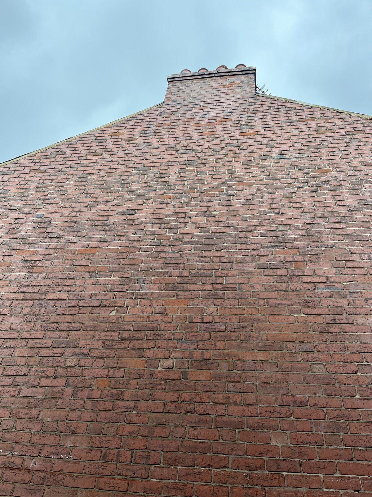

I’ll just reply here with more pictures as lots to reply to :) again really appreciate all you guys! Very helpful indeed. It’s raining currently and I can’t see any dripping from anywhere

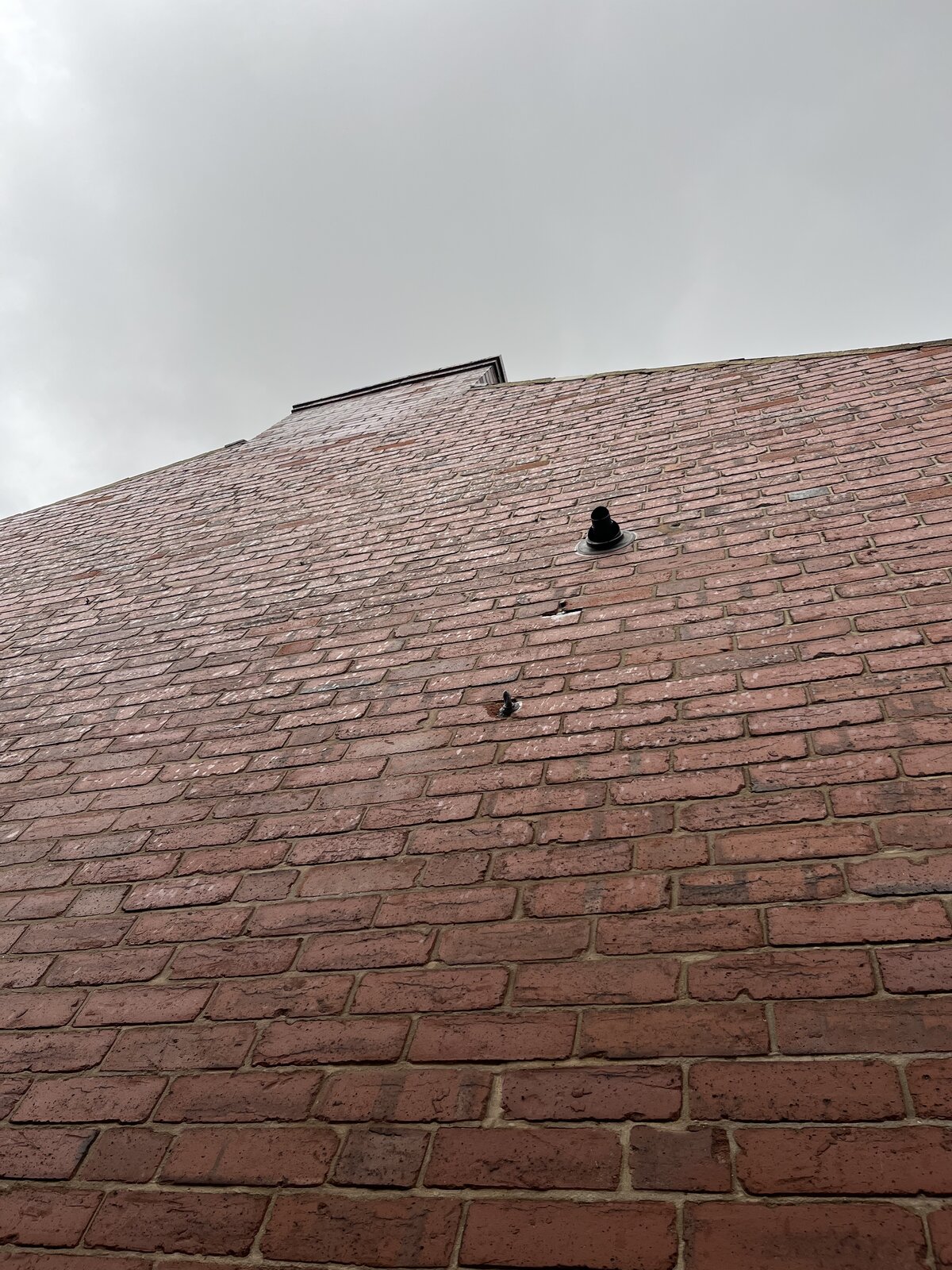

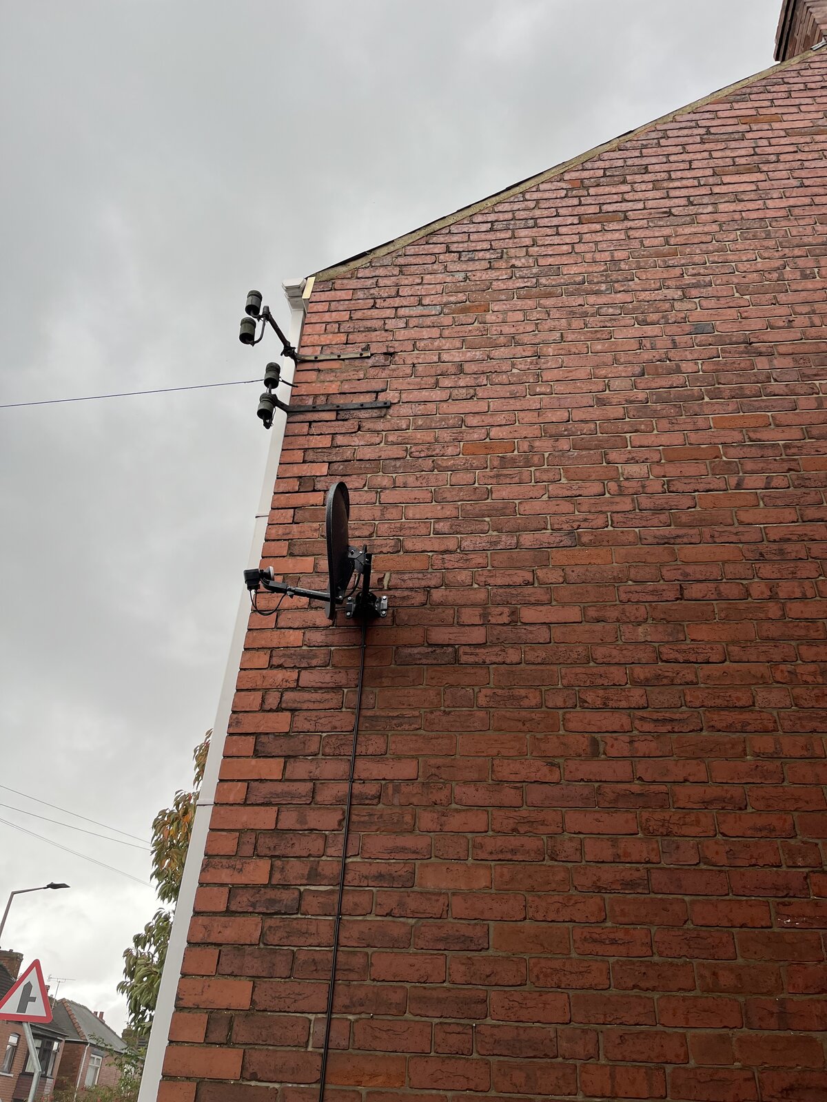

For that wall, all the way from roof to paving.
As well as possible defects, there may be witness marks left by water.
Does the wind blow rain off the gable end?

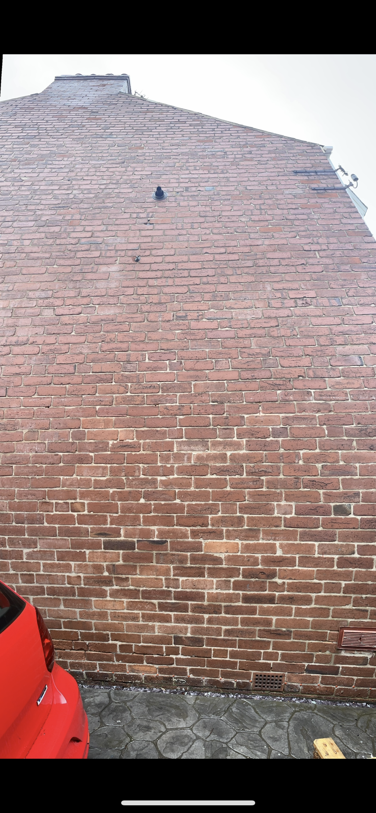

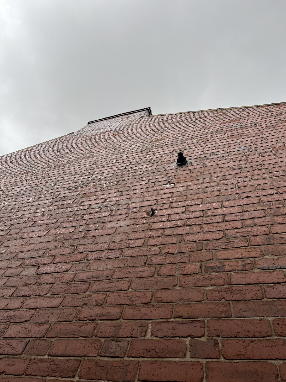

Especially as I now see a balanced flue, and a boiler vent, both of which may drip. Sometimes there are overflow pipes as well.

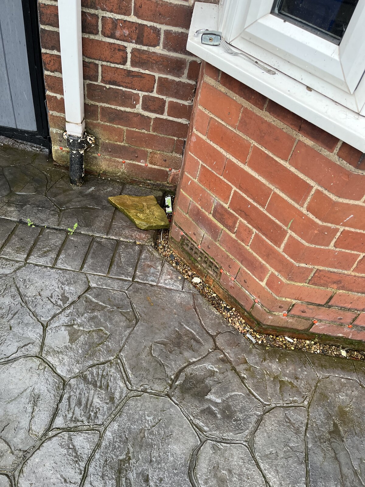

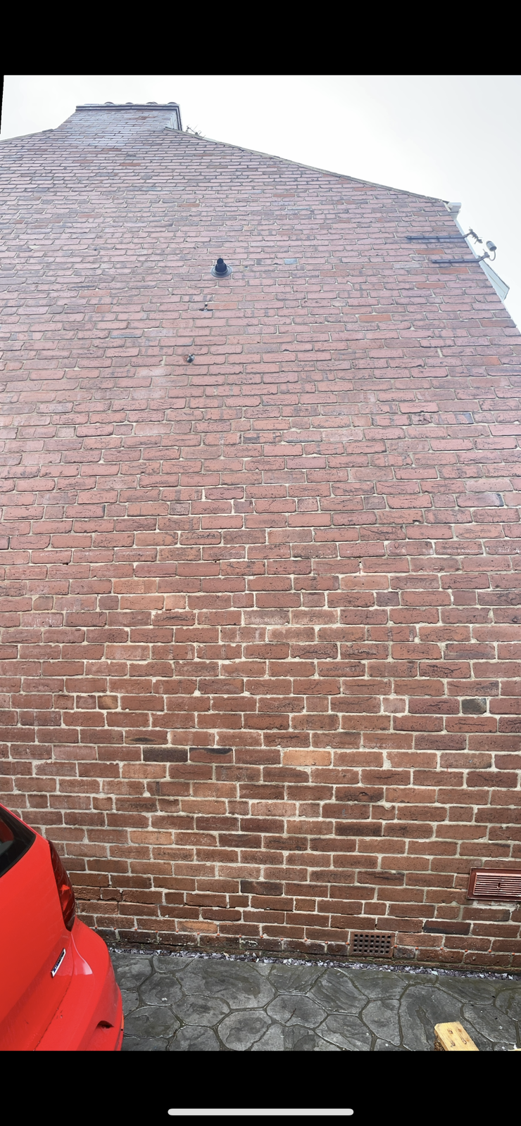

This is as good as I can get in one picture my back is against my neighbours wall haha
My eye is drawn to the very wet area around that very old cast-iron drainpipe.
Almost as if the drain was broken or blocked....
As expected, the silicone injections did not repair the drain.
Time to get out your pickaxe.
Don't allow your "damp expert" anywhere near your house again.
And I see another downpipe. Would I be right in guessing that it is close to another wet patch?
