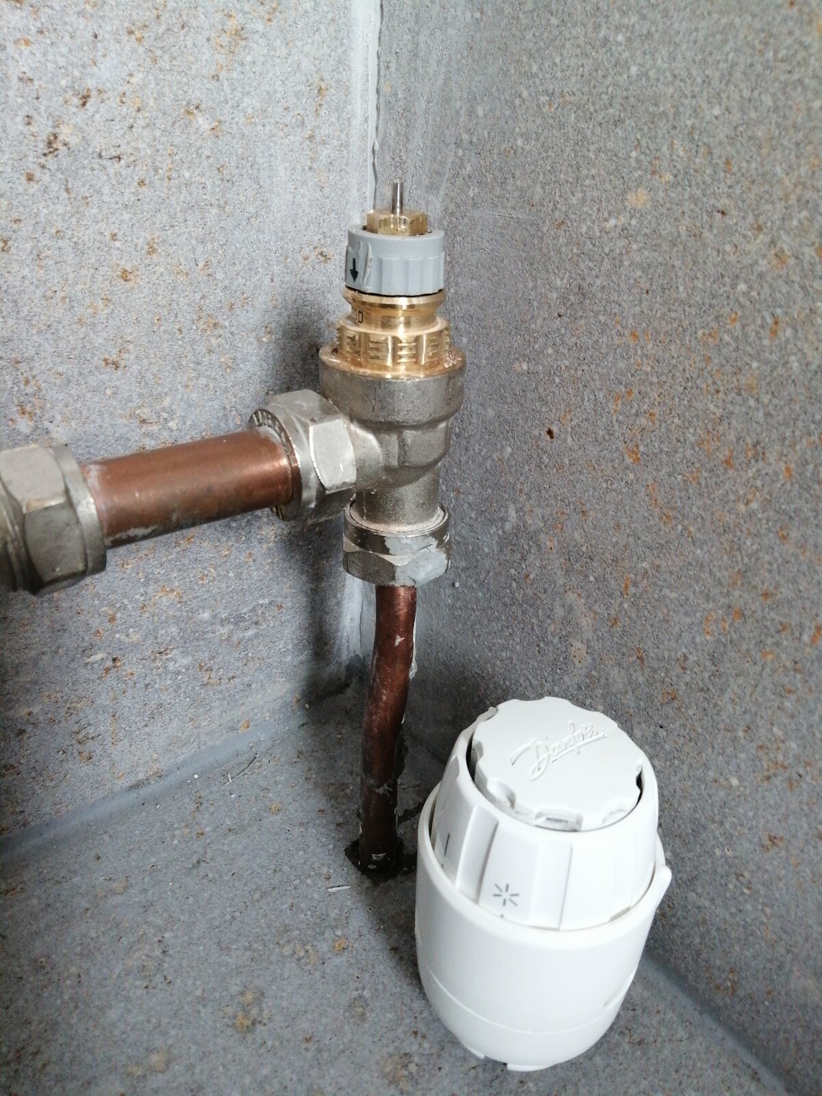

Please can anyone advise, any ideas why won't this valve shut off at 0!?

If you’re trying to turn off to remove the rad, then you need both valves closed. It could also be debris on the seating.
No radiator attached. But water keeps coming out even with the valve set at 0. so had to put 15mm short run of pipe with an isolation on it while I tiled the bathroom. In the end I cut the pipe, slung the danfoss in the bin and put some standard angled valves, stopped the water no probs
