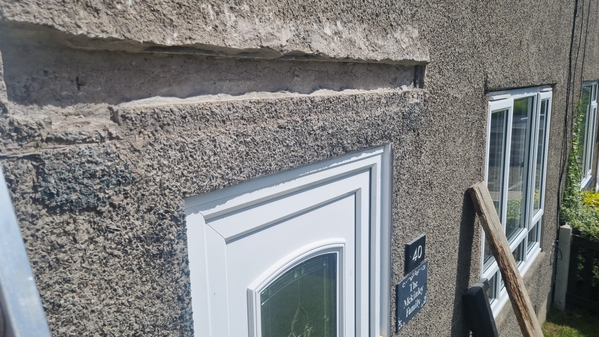

Hi complete diyer here just wondering the best way to patch the wall in the picture.doesnt have to be anything special.i was thinking fill it with a scratch coat then a ocdc.any advice would be appreciated.never mixed any kind of cement etc.

It would look a lot better to cut back to above that lip above the gap, presumably where a canopy was fitted. Then get rid of the bit between the gap and the door. Then you'll have a bigger patch but hopefully less obvious.
Alternatively, just fit another canopy.

The bell cast needs moving downwards. Remove existing render material and bell cast down to the door head and about 50mm past each side. Fix bell bead and re apply. Don't forget additives.
