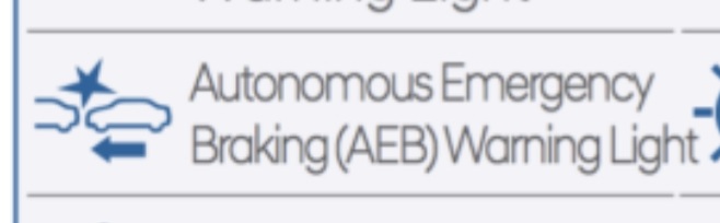

Anything like this one?
Yes, probably a radar behind the bumper or grille, that was getting its view obscured by snow.

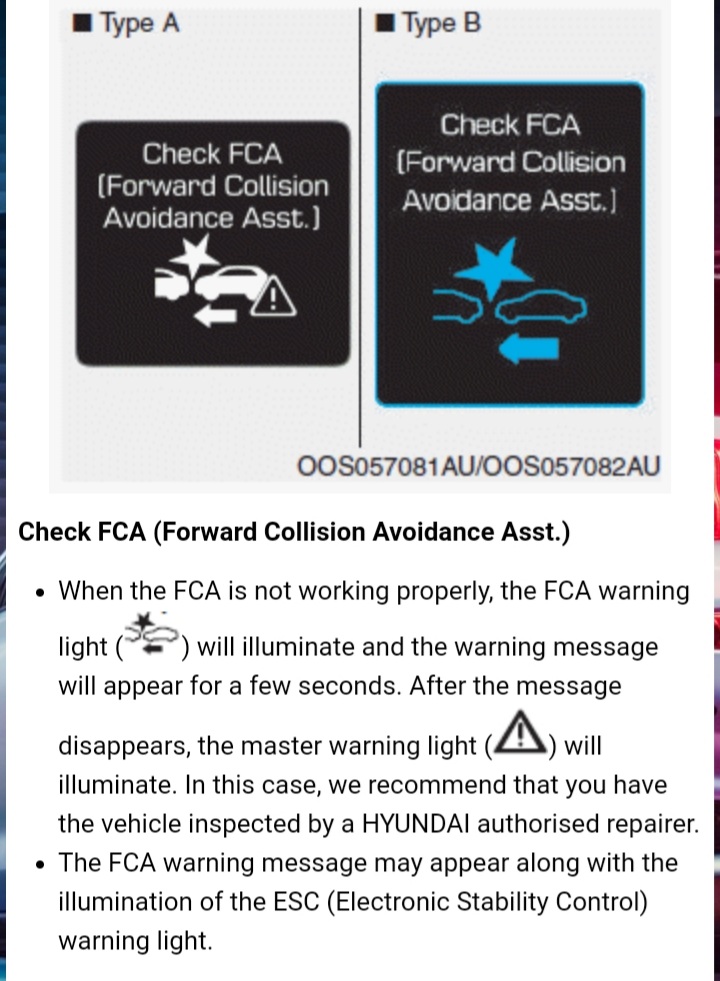

It was the FCA light that came on. Called AEB (assist emergency braking) in my handbook, where it says "When the camera sensor is blocked with snow etc the system may stop, and a warning message appears".
