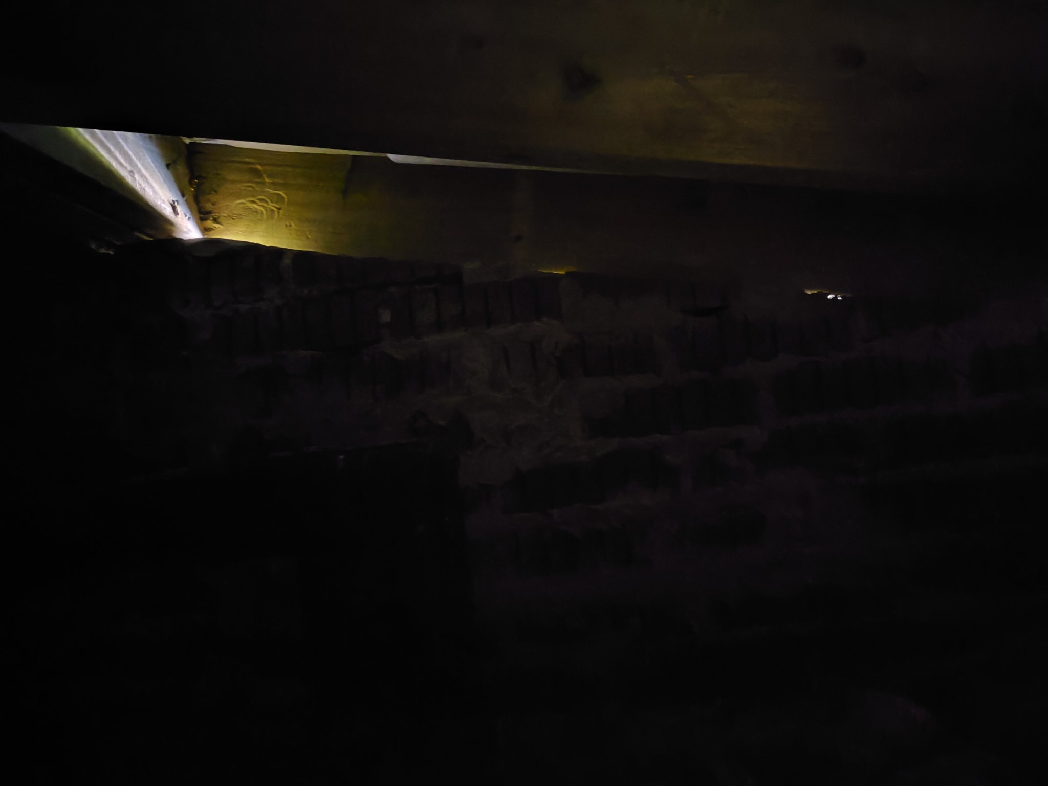

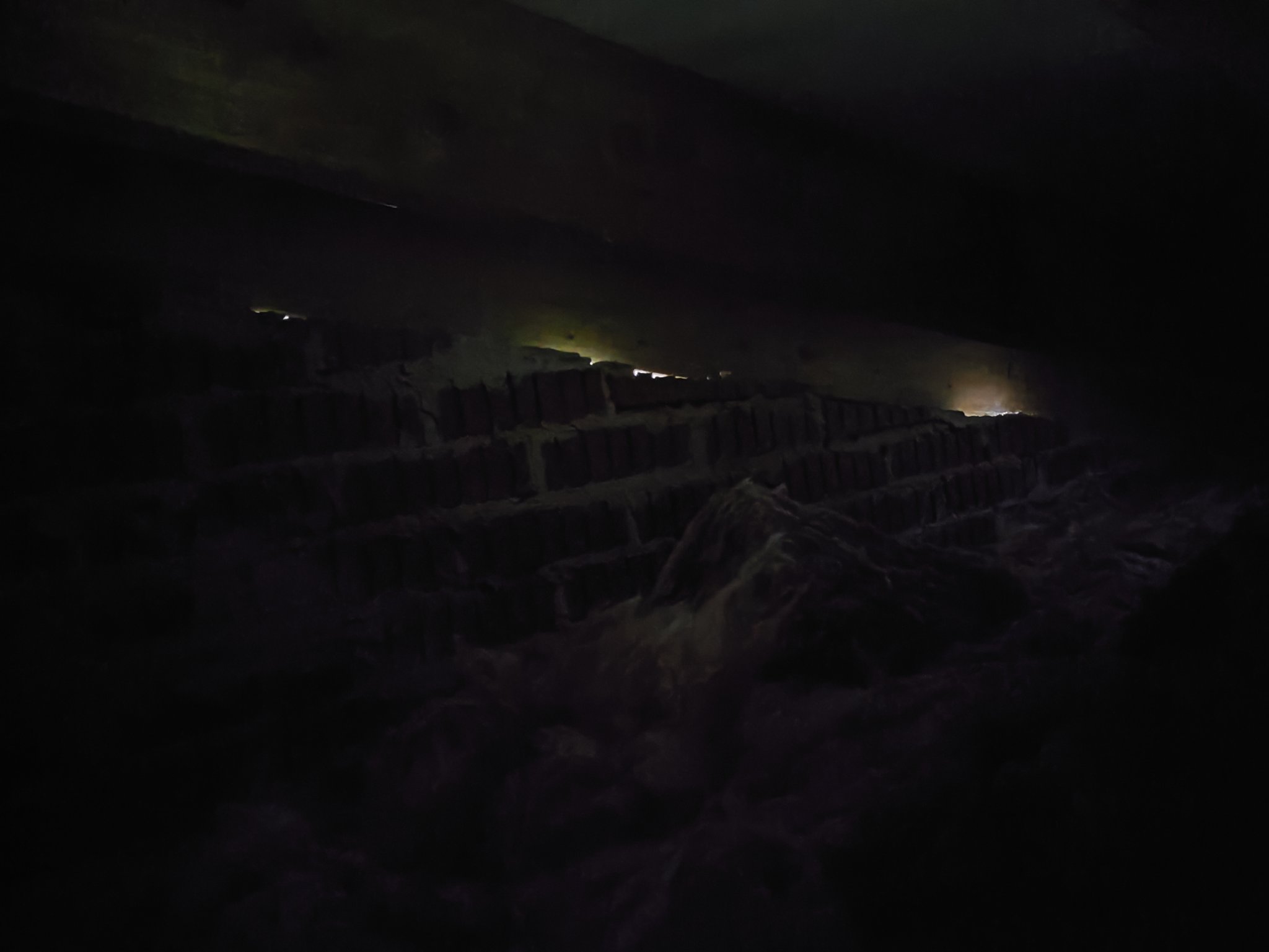

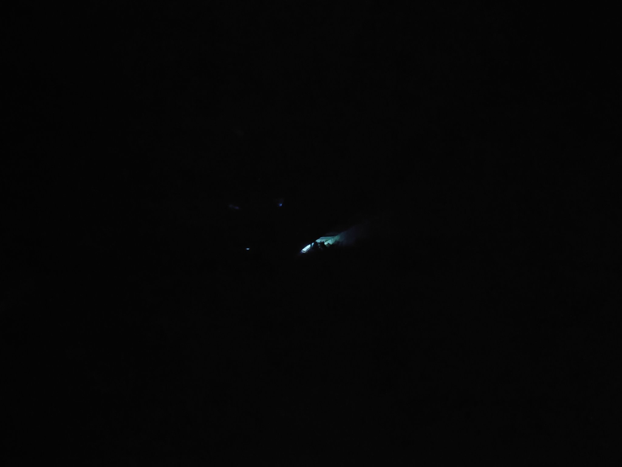

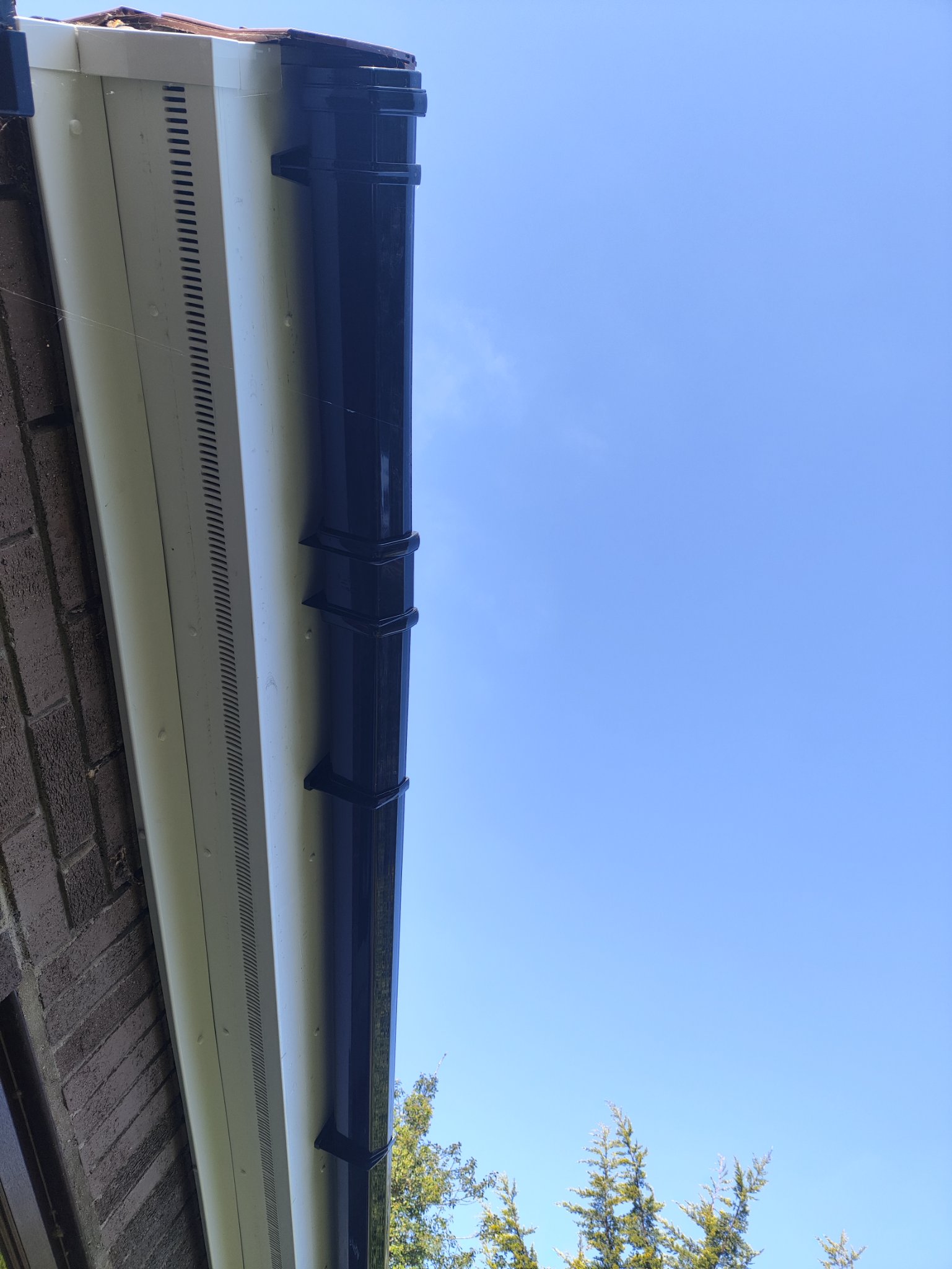

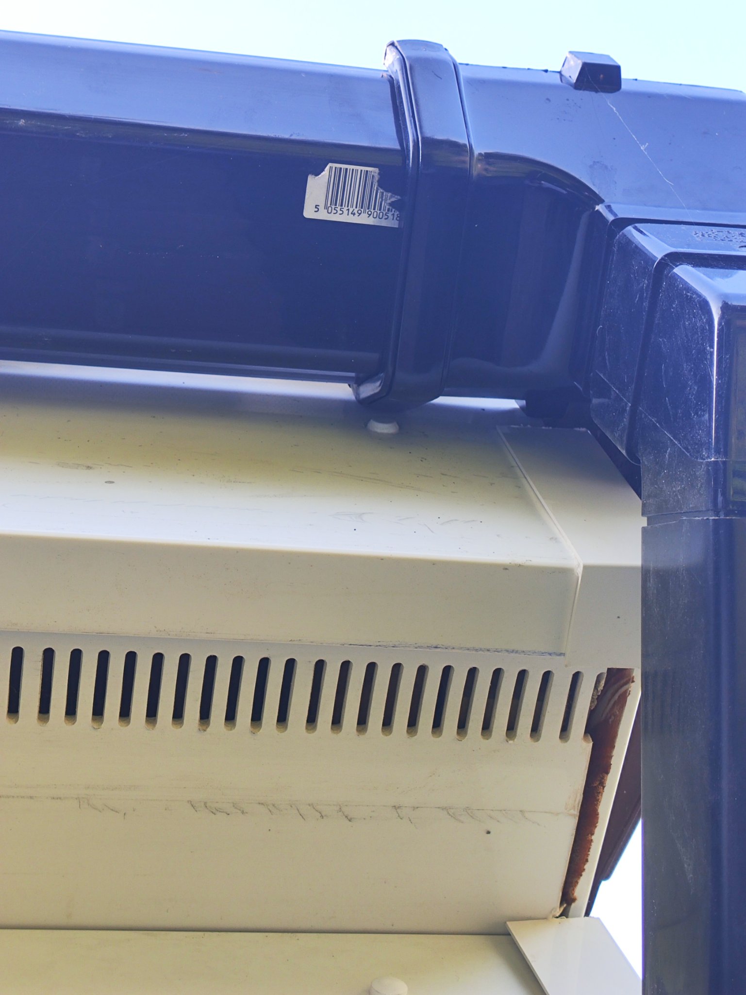

Is it normal to be able to see daylight in my loft space?
The first two pics with brickwork visible are along the pitch. The light seen in the third pic is towards the soffit.

Any areas of light could indicate places where rain could enter.

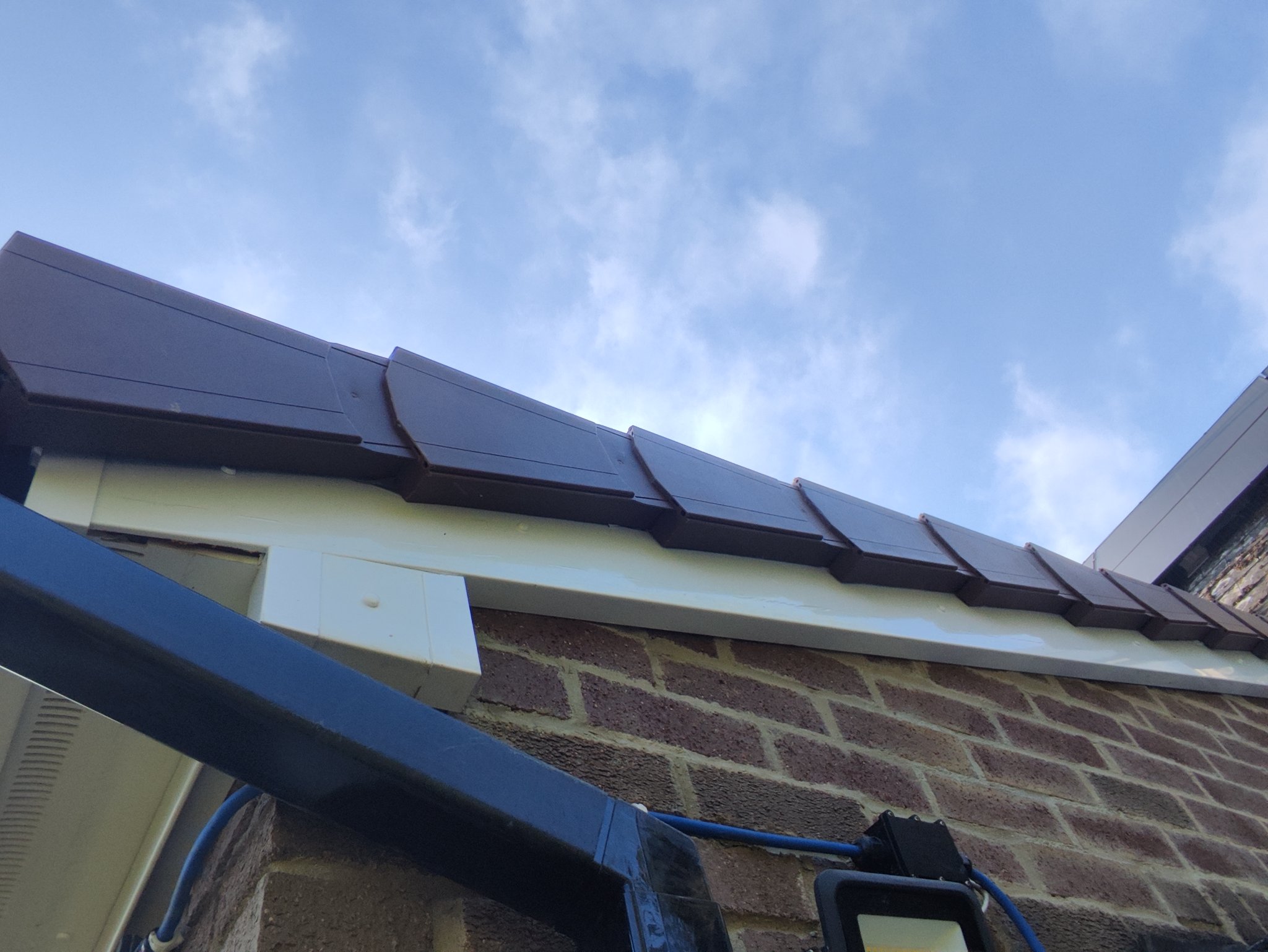

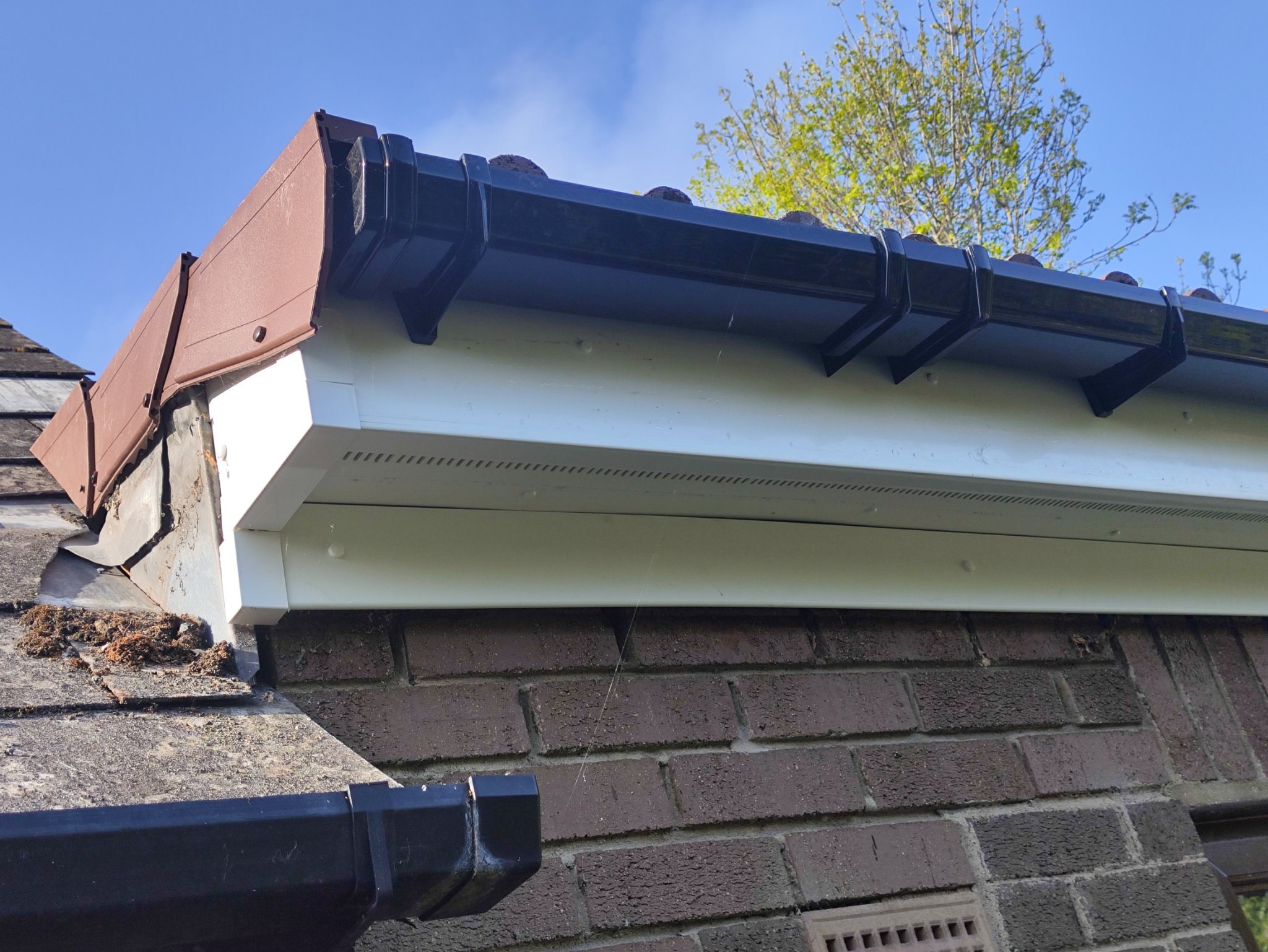

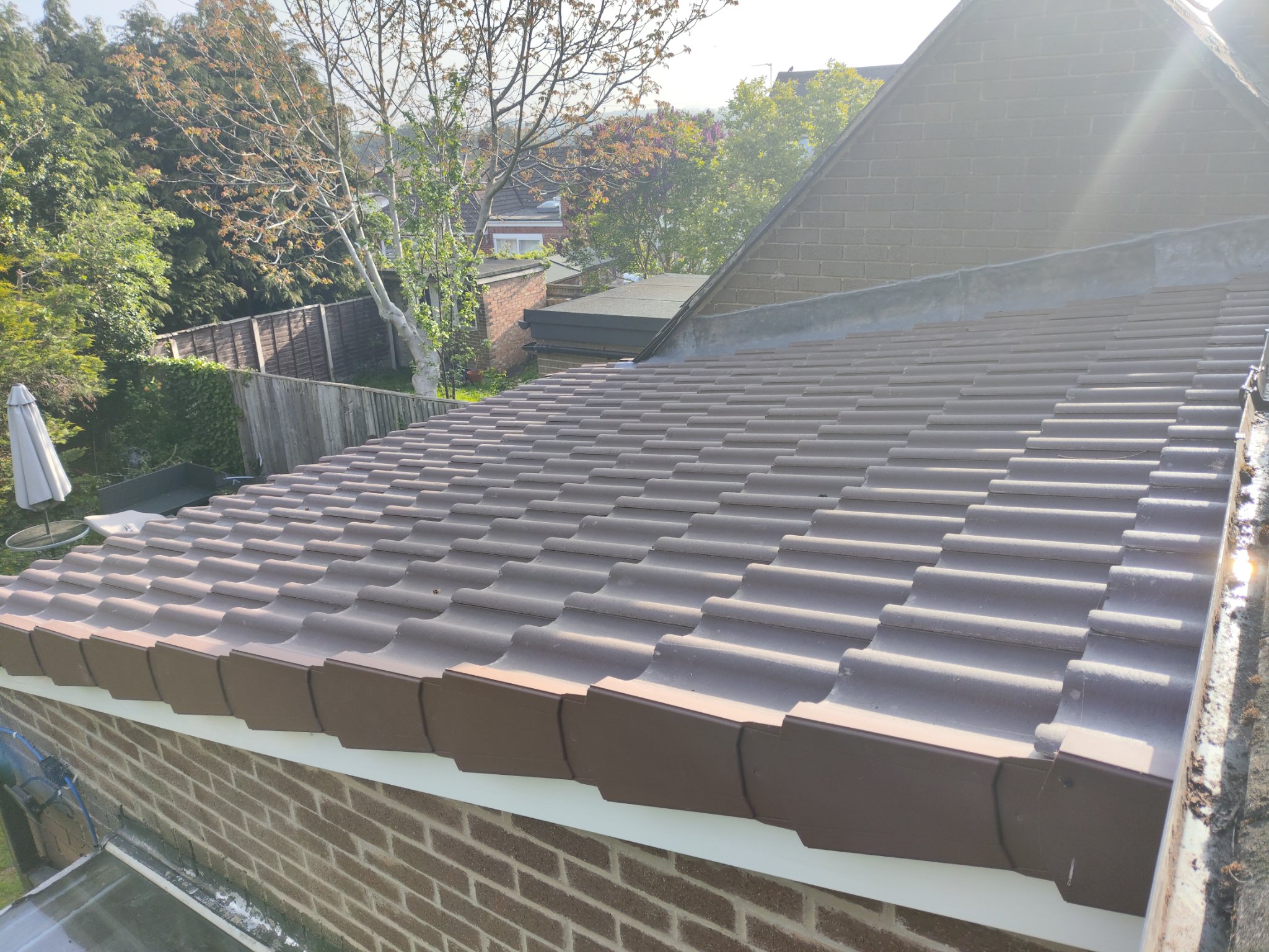

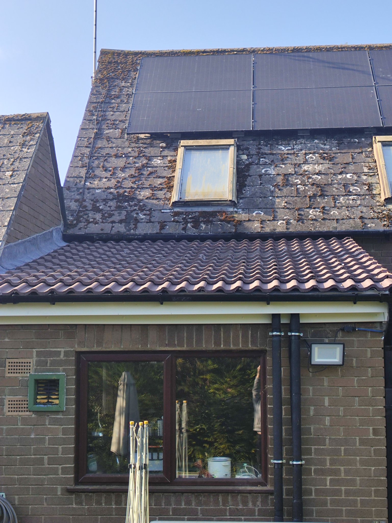

@Sonic70 this is what it looks like on the outside

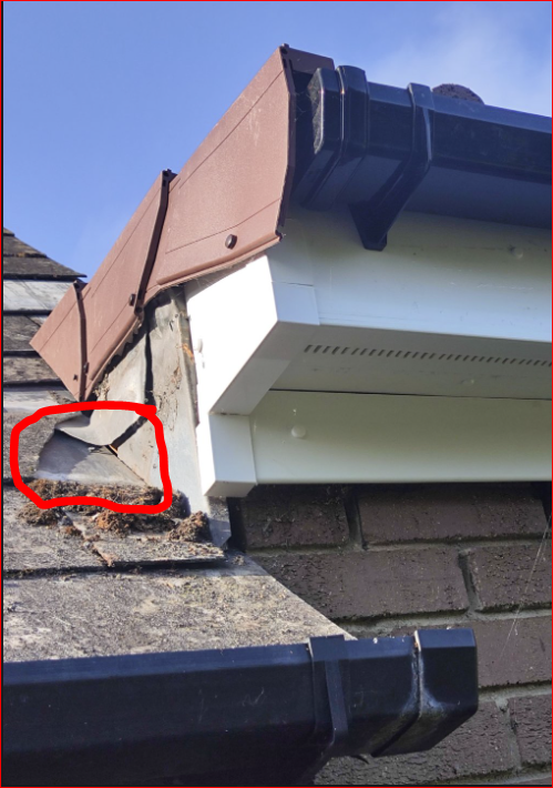

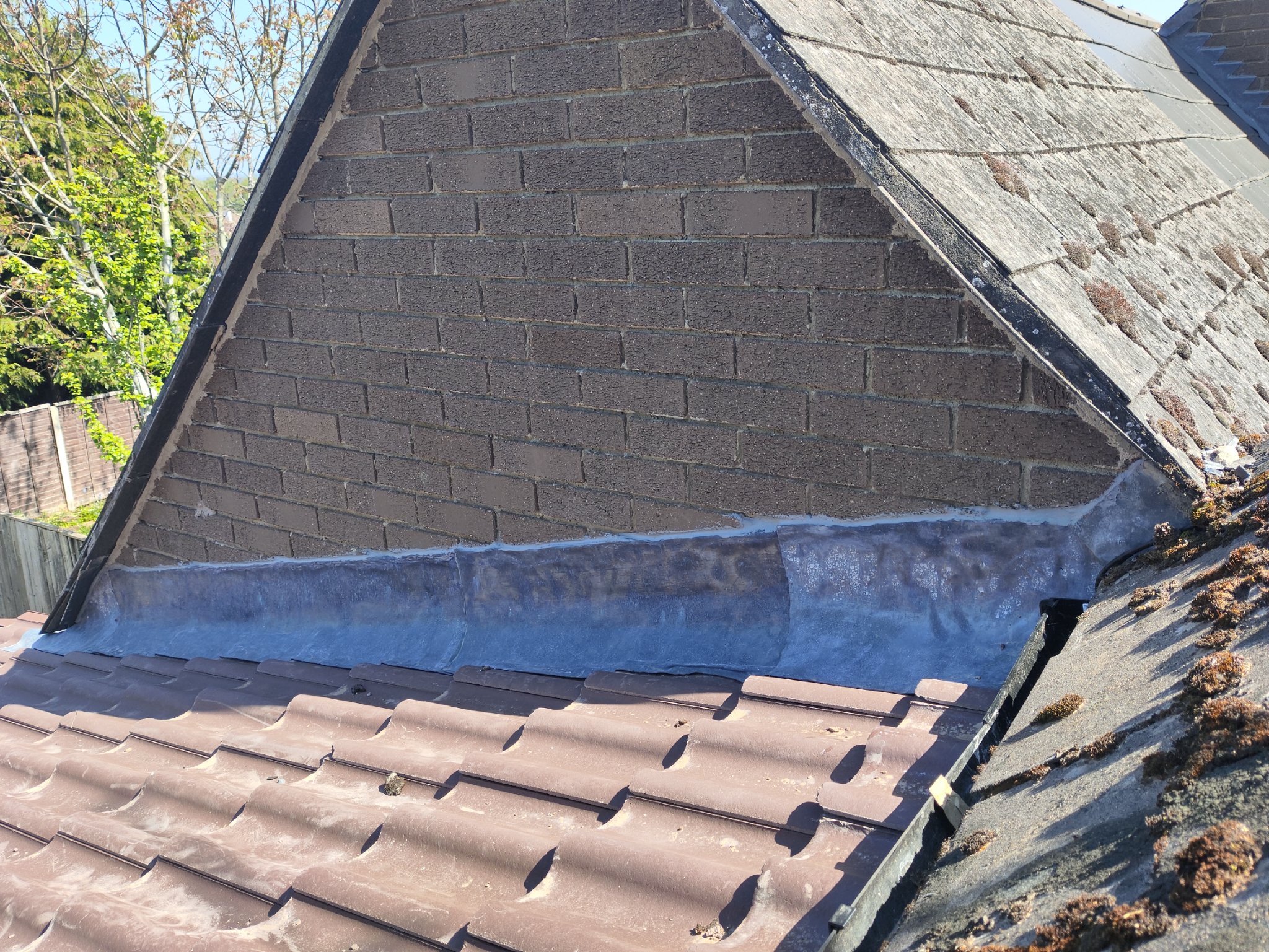

The biggest problem that I can see is here:
Tile broken with half of it missing, poor leadwork, visible timber under the lead flashing. The dry verge isn't great at that location either.
Most of your light in the loft seems to be coming from ventilated eaves which is expected.
Thanks @pcaouolte . Please could you let me know what's wrong with the lead work and dry verge? Are they functional or will likely fail?
Which is the visible timber under the lead flashing you mentioned?
I've attached a few more photos.

What's with the fascia beneath the soffit, is that to cover a large gap they have left between the soffit and wall?
The piece of timber that I can see in the centre of my red shape drawn on your photo, underneath the lead flashing, will get wet when it rains. That will eventually cause it to rot. The water will also run onto whatever lies below that timber.
I can see a shadow between the two pieces of lead around the top right hand corner of my red shape drawn on your photo, when the wind blows water will enter that gap.
The dry verge is a nasty looking wiggly mess but might not be a leak issue. I can't see what happens from a waterproofing perspective where the diagonally cut dry verge meets the tiles above my red shape drawn on your photo.
