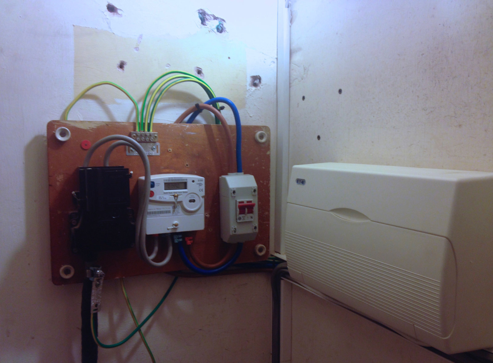

CU in my parents house. Few years old now clearly but see attached label by the MET
Fair enough. Particularly given the existence of the regulation, I suppose it's inevitable that some people will have done it - but how often have you actually seen it?
As I've said, in a situation like that I really don't see the point. Is a complete idiot any more likely to 'remove' that earth block or any of the connections to it than to 'remove', say, one or both of the tails emerging from the isolator?!
Kind Regards, John
