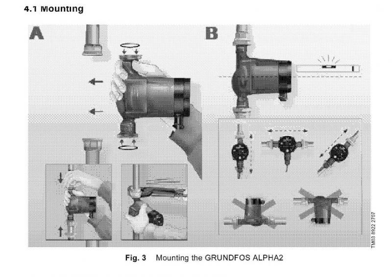

Dead grundfos alpha 2 after a week
If the second picture is the right way up the pump is mounted in the wrong orientation. The Alpha 2 pumps are self venting but not if it is mounted with the head upwards. Have a look at the installation guide.
Thats a floor you are looking at otherwise the pump in the other image is glued too the tiles. :wink:
The pump was mounted with the bleed screw up. The manuals I've looked at have this as a 'don't fit it that way'.
RTFM!!
The installation instructions are quite clear:
2. Install the pump with the motor shaft horizontal. See fig. 3, pos. B.
Your shaft is vertical!
Didn't even notice the tiles. I've spent too long in the trade and can't see anything other than heating components now.
The Grundfoss Alpha 2's are not self venting unless you get the A version that needs to be mounted with vertical pipework, so vent is upwards.
The non A type needs to just have the pump horizontal so bubbles can get back out the exhaust & not fill the pump.
I had found the supplied instructions a bit pictures only so downloaded the more detailed ones from the Grundfoss website & followed them.
I also noticed the Fernox had slightly different instructions with it & on the container.
The fernox does have 'add a bit at a time' but no obvious warnings about adding a bit too much or even lots.
Pump supplier will replace pump so I'm grateful to all.
