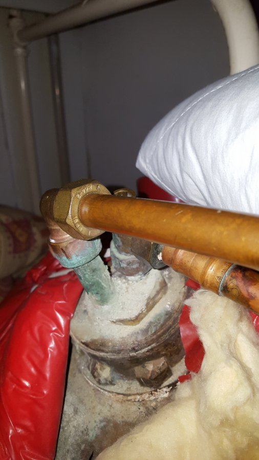

Is that what this is?
15m pipes
Strangely the tank also has an immersion heater fitted.
Steve
Yes, I haven't seen one of those in ages!
I fitted one in the 1970's. That one has been fitted with an Essex Flange leaving an immersion heater in the original boss . New tank time
