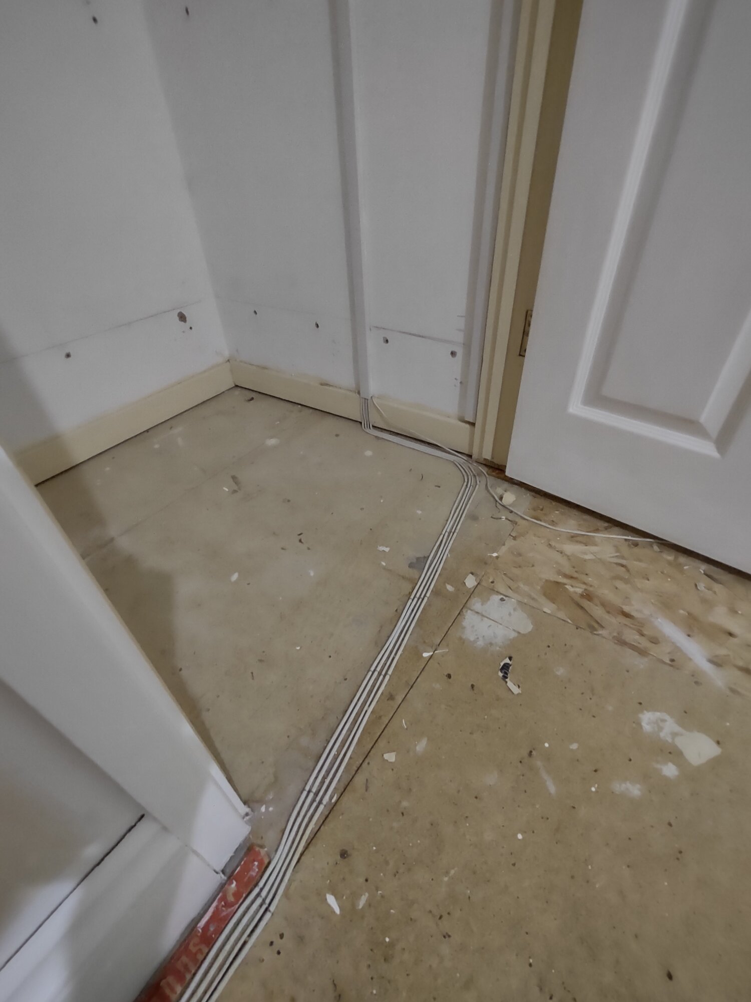

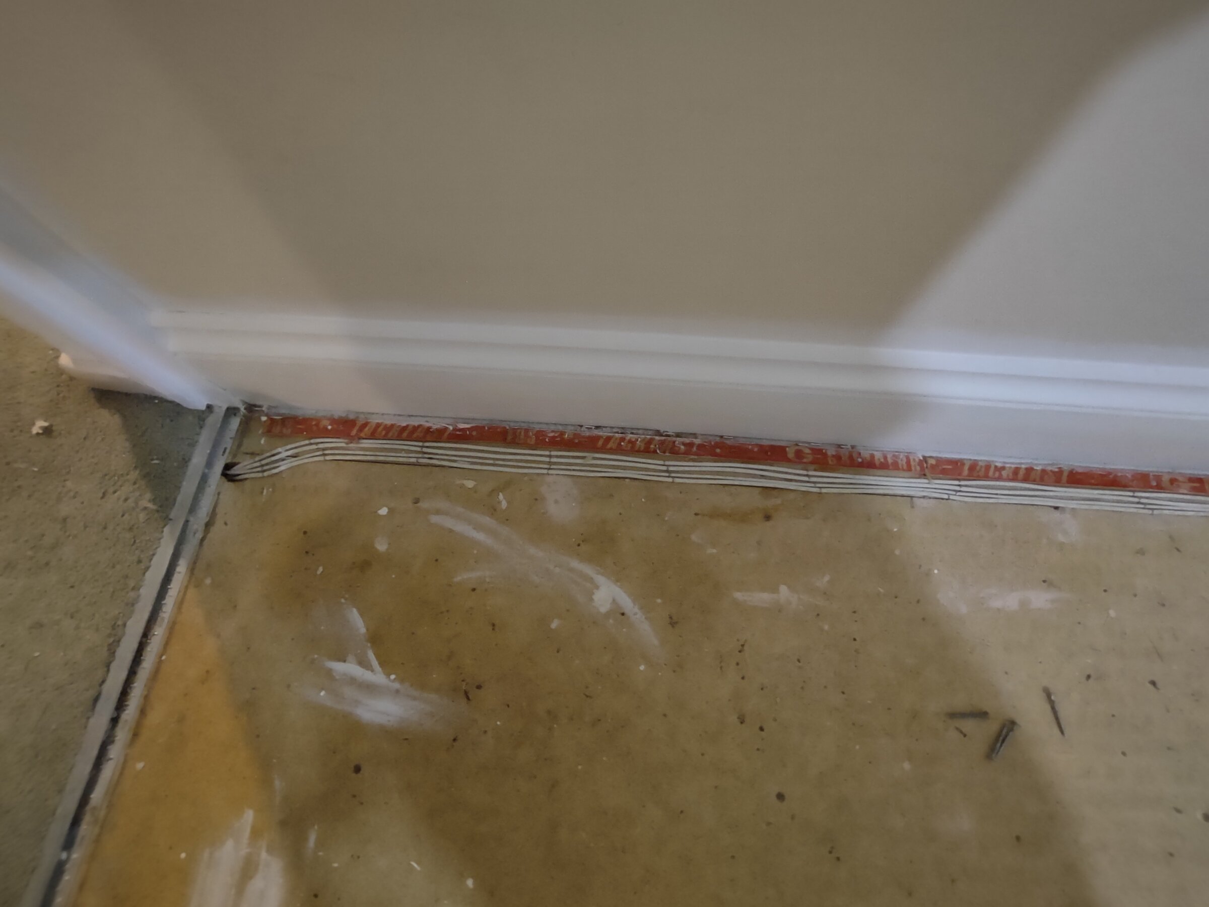

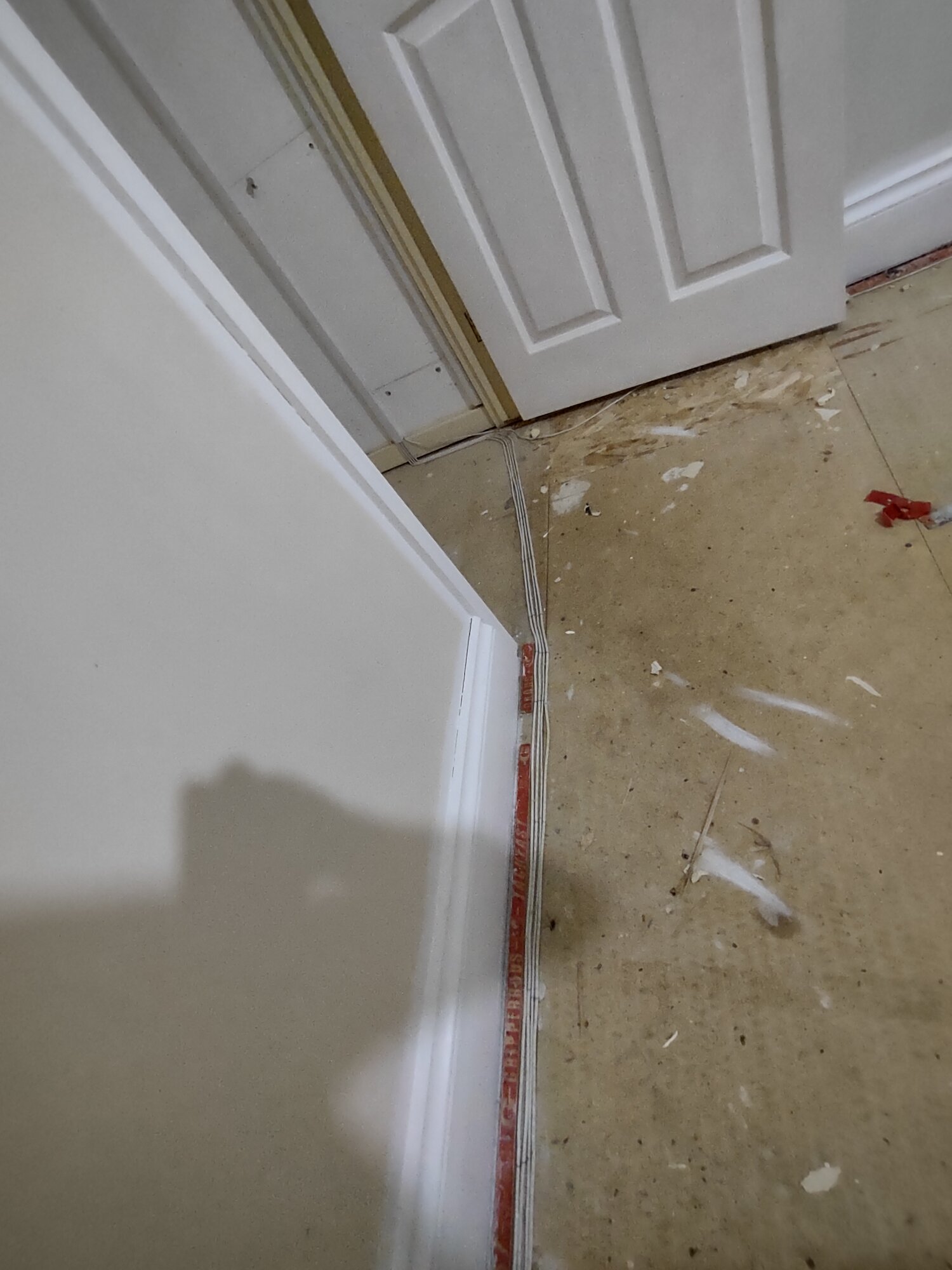

So currently decorating a bedroom in our house, the wiring centre for the intruder alarm is in the built in cupboard in this bedroom and the wiring has all (rather poorly in my opinion) been run under the carpet and then at a hap hazard angle to the alarm control centre. (See pics)
So the bit at the edge of the carpet I'm not to worried about, it can stay under the edge of the new carpet but where it crosses into the cupboard is annoying as I want to put a door bar there, lay a bit of laminate in the cupboard and carpet in the room.

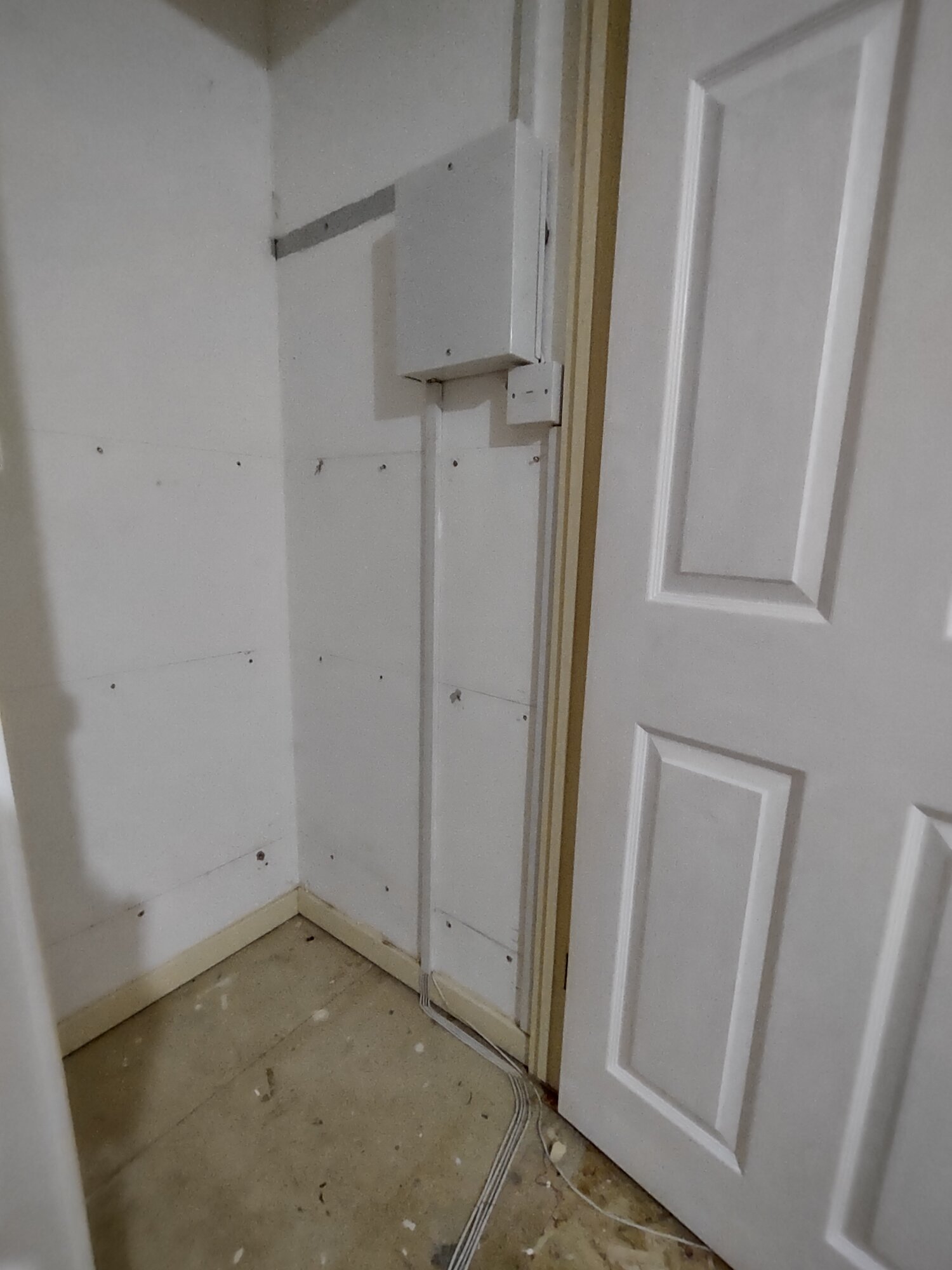

Anyone got any creative suggestions on how I can deal with this myself without disturbing the alarm centre (which I know will have a tamper switch on if I undo it.) We don't actually use the system, but I don't want to turn it all off and strip it out incase we decide we want to in the future.
My only idea is to gouge a trough in the floor where the divide is and carefully reroute the cables through this, but does anyone have any better suggestions, this seems a bit crude? There's not much slack in the cables either and I'm slightly nervous about disturbing things too much and setting the thing off (previous bad experience teaches me this could happen!)
Any suggestions welcome!
Thanks!
Mike
The cables look taut and stapled in very.
I would have look under the conduit going up the wall to see how tight the cable is entering the panel, maybe some slack but wouldn't hold my breath.
easiest option might be to take the carpet into the cupboard full stop but not what you want.
or start the laminate based on the carpet entering the cupboard and going beyond the alarm cables a little, so you still most of the inside of the cupboard laminated and the join isnt on the cables.
Without opening the panel not so sure your going to find enough slack to move the cables significantly or easily.
knowing the alarm system you have we may be able to give you options on joining cables, or disconnecting and re routing the cable under the floor rather than over it.
