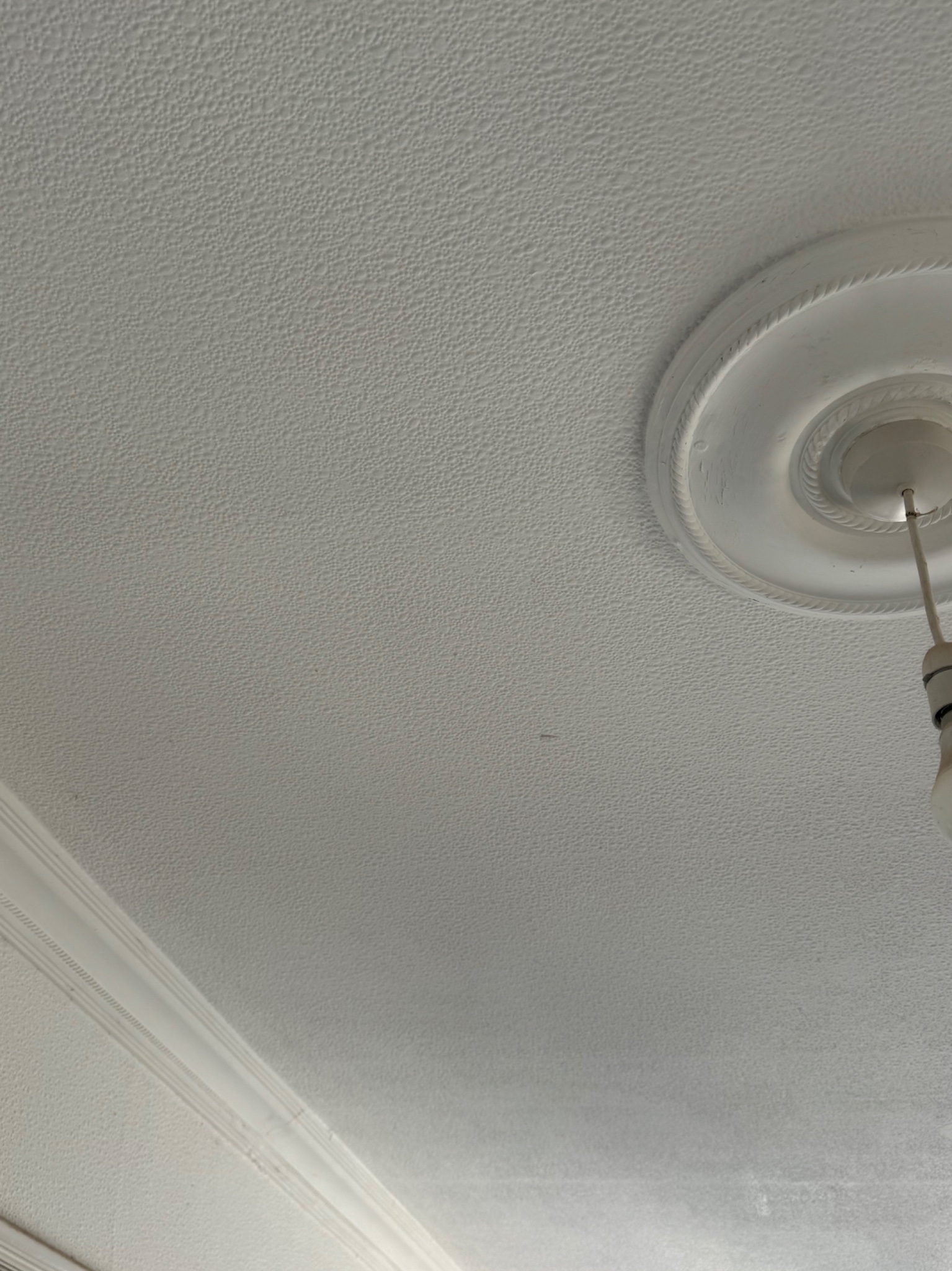

My landing/staircase ceiling is covered with embossed wallpaper (the bubbly stuff) which is also above a picture rail. It’s also got coving.
I’ve managed to removed the paper above the picture rail but the coving has obviously been added after the paper went up as I needed to carefully score it with a Stanley knife. The wall is not too bad, it’s had a few cracks that have already been filled so I plan smooth, Gardz and then put a plain lining paper on.
It’s a 1930s house and the wall is lath and plaster so I assume the ceiling is too.
The embossed paper came off relatively easily but I’m worried about opening a can of worms if the ceiling is in bad condition, especially as it’s a tall ceiling. It’s about 12 sq m and once I start there’ll be no going back.
It’s tempting to leave alone but the rest of the house has smooth walls and this area looks dated.
Anyone had any experience of this and/or advice on the best approach? Thanks
How old is the property? (edit- sorry you said 30's). I recall painting cabinets in Bedford Park (Chiswick). The property was 1830-1850. In conversation the owner told me that the ceilings were reaching end of life. Some fell down of their own accord. He overboarded and skimmed each of them.
If you are careful, you should be able to remove the embossed paper, but, you will probably find that it was used to hide cracks. If you are happy to feather out the cracks- go for it. You may need to use lining paper after. BTW Lining a ceiling on your own is relatively easy. As you concertina the paper on the pasting table, you can put tight creases in the folds (every 12" or so). The creases will disappear once the paper dries. A trestle and boards makes life much easier though. I have done it using a step ladder alone, was a bit of a chore. I used a wide filling knife (approx 16") to support the paper as I gingerly moved the step ladder.

When you do so, take photos and we can advise you further.
Regards.
This is it beforehand. It’s only me that hates it and I wonder if I’m making a rod for my own back!

If you steam off the paper, there is a good chance that the skim will blow off and that paper has been put up to hide cracks anyway.
I'd be inclined to overboard what's there and then get it skimmed. If the coving and the ceiling rose aren't original to the house, you're not really losing anything and then you know you have a good ceiling that won't be at risk of collapse.

I wouldn’t steam, I’d just use soapy water but yes, it’s probably been papered to hide cracks.
Having ripped out several rooms of lath and plaster I’m not sure I want all that aggro again, or even the aggro of removing the coving (which matches other rooms).
I did read about over boarding where you leave the coving and create a shadow gap. That might be the way forward, I’ll have more of a think to see if that would fit. Thanks.

I too would try to avoid a steamer if possible but steamers tend to be ok on lath and plaster (assuming that it hasn't be skimmed with gypsum). Steaming ceilings is never pleasant- hot dripping water- and domestic steamers have very short hoses. I have a steamer (5m hose) which now retails at £480 (when I purchased it many years ago it only cost me £120). I haven't used it for about 5 years.
Had forgotten about the hot dripping water - another reason not to use one!
Personally I'd tackle it because I like making a rod for my own back. The job would be messy and stressful, but immensely satisfying if you end up with a good finish. Conversely, it would be a right royal pain in the butt if you got it wrong and had to look at the bad result every day.
However, looking at it objectively, if the embossed paper is in good condition and there are no obvious indications of major and perhaps developing cracks underneath that might eventually break through the paper, I'd leave it.
