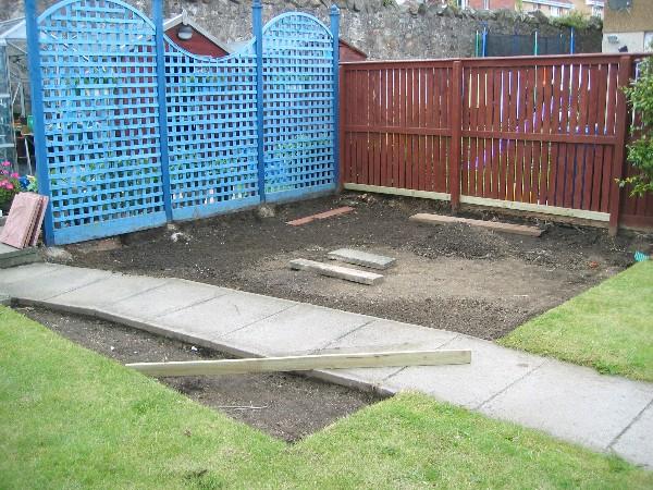

I want to build a 4.8M x 4M freestanding low level deck away from the house. I have removed the lawn in the area and about 100mm of the soil. I intend using support posts in concrete to support the joists. How many posts and at what spacing for a solid deck using 4X2 joists? And if I decide I can go a bit higher how many support posts and spacing for 6X2 joists?

no hard and fast rule really. We start with a post at each corner and then put one roughly every 1-1.50m. After that we do a bounce test and put extra ones in where needed. Obviously less are needed with 6 x 2
Thanks for your quick reply Thermo. So probably about 20 posts? Do I have to relate the spacing to the overall joist spacing, say multiples of 450mm?
This is the area.
Jim
As the man said, put some in, do a bounce test, put more in as required. There are no "rules" as such.
