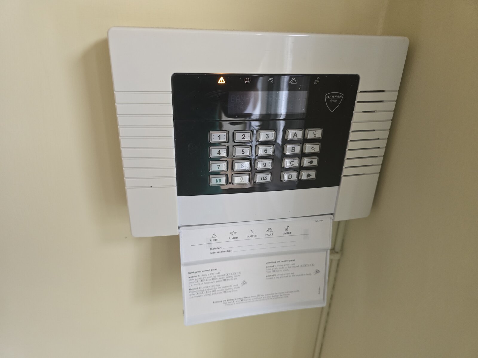

I have a banham alarm that I would like to decom wondered whether it's something I can do, or I should get the professionals in.
Don’t see the fused spur.
Is the bellbox wireless or hard wired?
I can see a cable in the corner but don’t know what it goes to, looks like it goes downward from the enforcer panel.
Ok to just power it down open panel , it will go off internally , unplug the psu connector it just pulls off , open battery compartment on the rear of the control panel , unplug the battery ….the alarm is now dead…go up ladders open bell box and unplug battery packs ….all done until you need to get the 240 supply isolated THEN you can remove the panel
