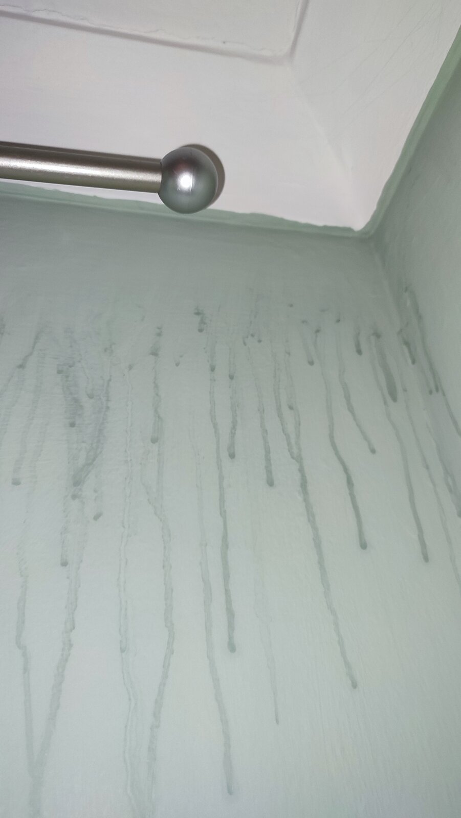

Hi All,
I wonder if someone would be able steer me correct after some advice to took with decorating has gone a bit wrong.
I moved into a 3 bedroom house a few years back. One bedroom and bathroom is in an extension and the other two rooms on opposite sides of the main house. I noticed that the bathroom was starting to get some black mould on the ceiling in the bathroom that at first wiped off, but was beginning to be a problem and there were signs of it in all three bedrooms too (no trickle vents in the new windows when we moved in which I expect doesn't help). On the advice of a local handyman who has done a few general jobs for me, I painted all three rooms in a coat of Zinsser perma-white anti mould paint. I left that on the bathroom ceiling, but in the bedrooms on the external walls I painted the Zinsser and then a general emulsion from homebase over it.

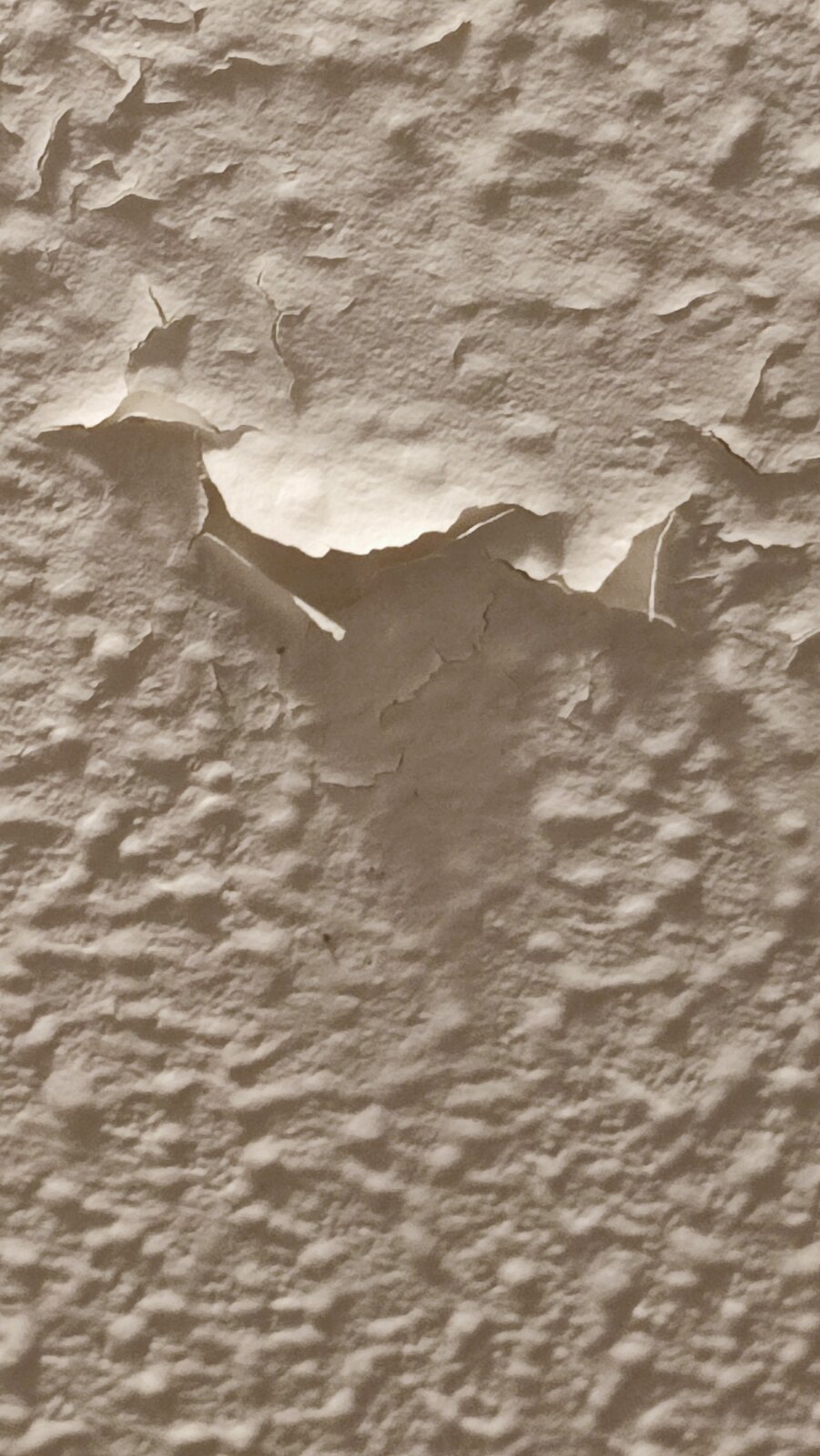

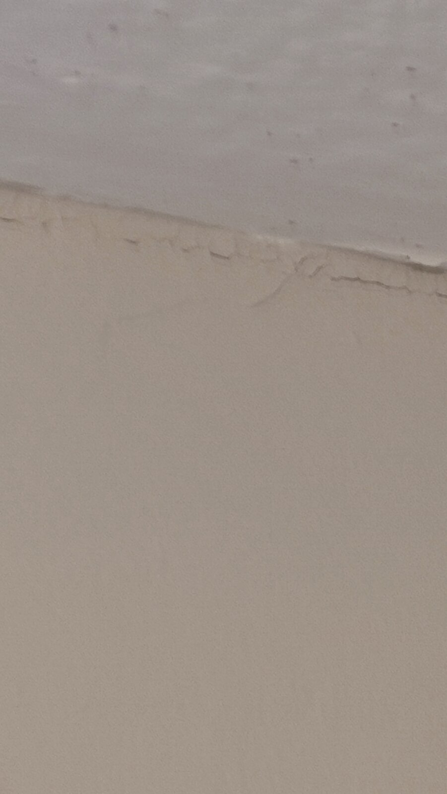

Fast forward a few months and while it looked fine at first its starting to take a terrible turn. The paint on the bathroom ceiling is starting to peel off and some mould is coming through again. This is supposed to be for high humidity so not sure what I've done wrong. The paint at the junction with the wall is starting to have a cracking effect.

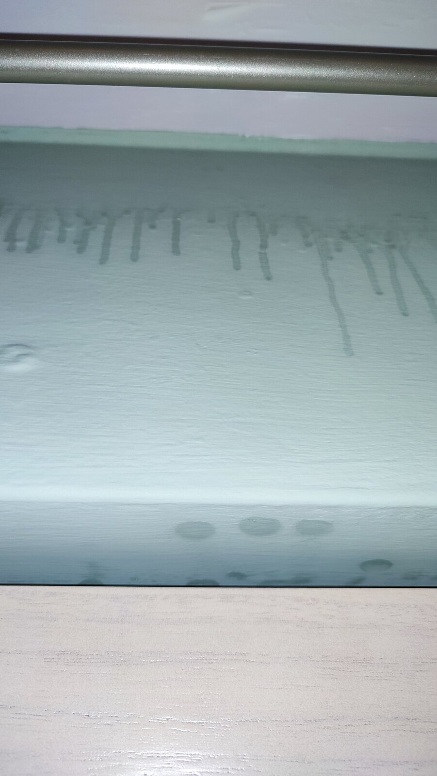

In the bedrooms on the external wall, there is a really odd paint running effect that's appeared about the window and around the lintel area. I can only assume it's the Zinsser, but I don't where were to go from here. I've attached some pictures so if anyone had any advice it would be helpful and make my wife a lot happier with the outcome.
Many thanks!
You have a serious need to address the moisture level issue in that room. Add an automatic extract fan.

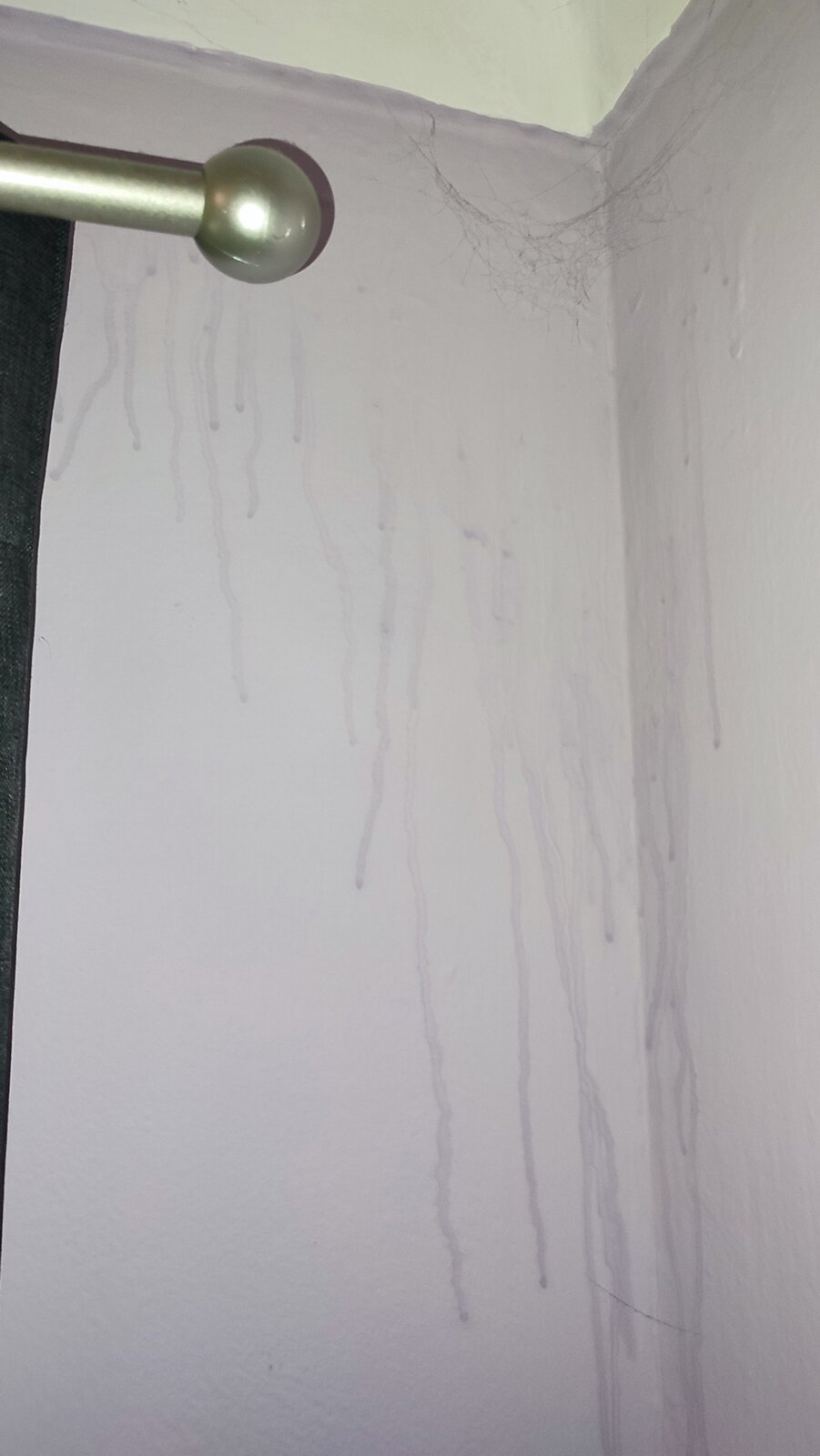

Any thoughts on the odd streaking in the bedroom corners? An insulation problem with cold coming through the walls maybe? Has anyone seen something like that happening and knows how to deal with it? The green and purple walls are both bedrooms, one in the new extension and one in the original house. One bedroom is totally fine, so I'm not sure if I've caused a problem with the Zinsser as a base coat or if it's showing up an under lying problem, but these issues were not there when we moved in and it took me a long time to get round to painting as the colours were nice. I'm unsure why the original paintwork didn't have this issue.

In terms of the decorating of the room it looks to me that it was damp when it was done and not clean
Put those two together and maybe not leaving time for coats to harden off and bobs your uncle ......flaking
Start again , get the room as dry as you can , get the flaking paint off then , in a dry environment .....stick on 2 coats of a good adhesion primer ......zinser cover stain , crown px4 ......let that harden off for a day ......then paint with a specific bathroom emulsion or eggshell

Do you think it was damp that caused the running of the walls in the bedrooms too (green and purple rooms)? I was doing each coat about a day apart, then the streaking effect didn't appear till a few days later. Looked perfect and then my wife called me in as she had noticed it. There the paint isn't flaking there, it just looks like someone has poured water down the wall, but I did give the room a coat of Zinsser while I was at it.

Yes , moisture, damp ......definitely
I would concentrate on getting those walls as dry as possible ....heat , dehumidifier , opening windows etc
Then get a decent adhesive primer on there .....zinser cover stain , crown px4 , zinser bin
then a decent white trade matt from leyland or johnstones x 2 coats to give you an idea of the state of the walls
A day between coats
Then your chosen finish .....again noting drying and recoat times

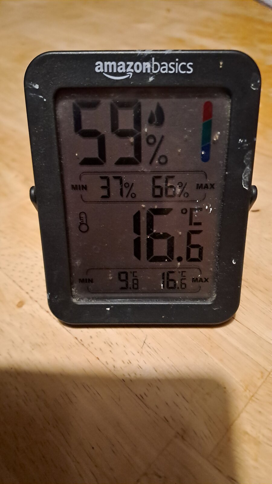

Hi, you need to sort out your damp issues BEFORE decorating. I would suggest getting at least one or maybe 2 good dehumidifiers and put one in the problem rooms. Meaco make good dehumidifiers. If the rooms are heated get a compressor type they are quieter an cheaper to run than a dessicant type (these are best suited to colder places like a garage). Also buy some hydrometers to monitor the moisture levels in the problem rooms. Amazon sell them and don't cost much, get some which show the high and low moisture levels. I would say put the dehumidifiers on a high setting until the walls have dried out then a lower setting to keep moisture levels below 70% any higher the mould will return. Then leave them on, most good dehumidifiers have built in sensors and turn off automatically at the desired humidity levels. I personally regard dehumidifiers as an essential household item for any property with mould issues. I see it in the news about all these properties suffering from mould and they always blame the local authorities or landlords for neglect. The problems isn't always the property but could just be condensation created by breathing, cooking, showering, drying clothes etc.. And dehumidifiers are rarely even mentioned as a possible solution.

I would definitely buy at least one dehumidifier to control humidity levels on an ongoing basis. I guess hiring an industrial dehumidifier to dry things out quickly but if it dries too quickly it might cause cracks in the walls and ceiling so maybe not a good idea? Here a photo of my hydrometer.

I will defiantly get a hydrometer as that looks really helpful to guide when to do the painting. I'm in no rush so I can afford to allow it to dry out and maybe wait for the summer months. It never occurred that the moisture levels would be an issue in the bedrooms so I just went ahead and did the decorating. I do have a dehumidifier for doing the washing (funnily enough in a room that has no issues) so I can get that bringing the humidity down prior to the work. I think I have a number of steps to take care of in the bathroom as you have all mentioned above, but you guys have been very helpful. Fingers crossed I can get it all under control.
