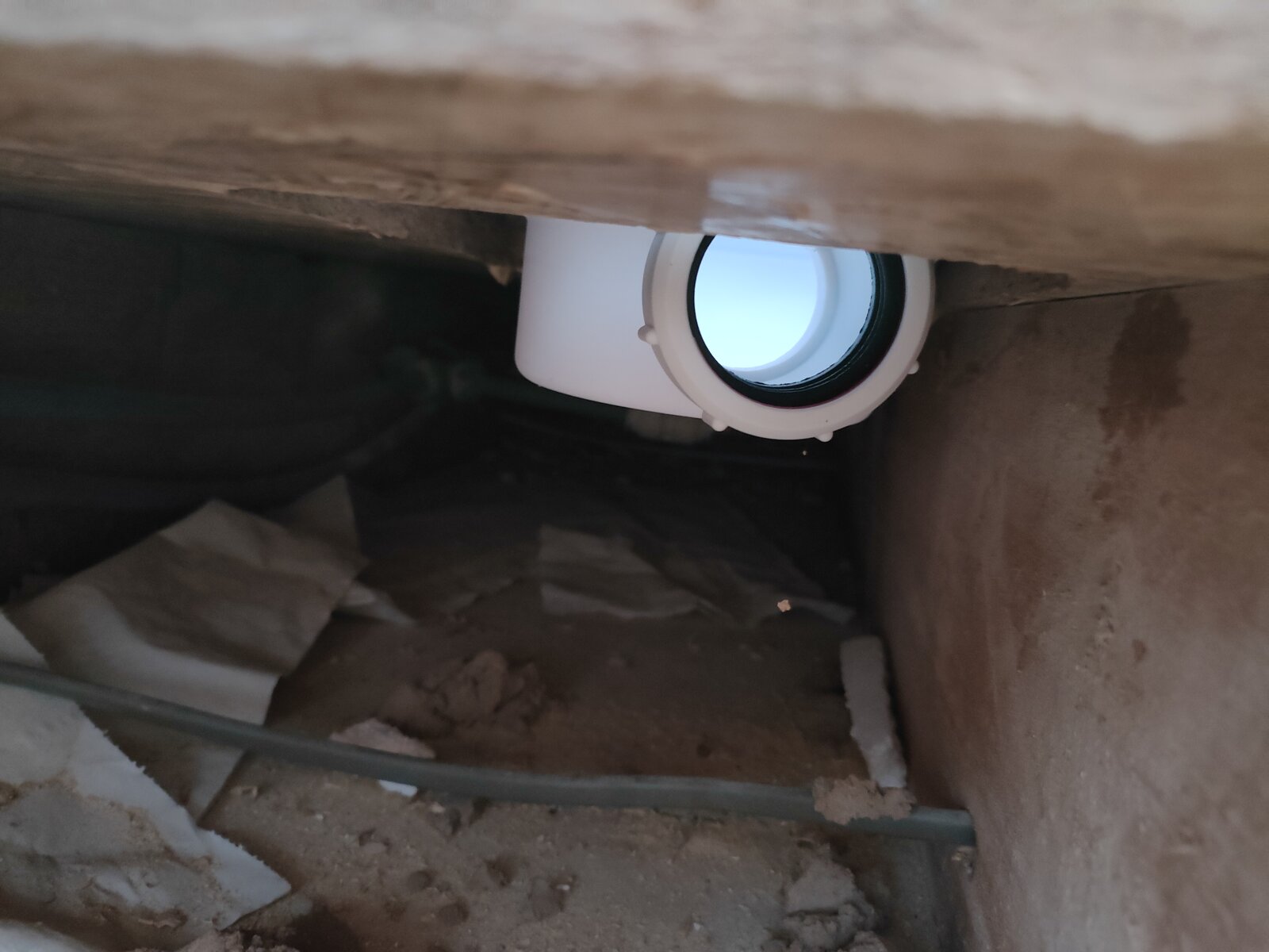

My shower waste trap isn't deep enough as I've had to put the tray on a bed of mortar. Are there traps that are deeper?
Wow, how deep is the mortar? What size is the trap, 90mm?
You might need to use a vertical trap and elbow out the bottom with that setup but the fall on the waste run may be compromised

There as about 10mm of mortar plus 18mm ply. I'll take a look at the vertical trap. Thanks.

The solution is to do what Hugh suggested
Just an update, Not enough access to get the pipe/Spigot so Vertical trap was the correct solution
In my case there simply isn’t enough clearance to get a grip on the locking ring as it’s not clear of the actual flooring which is the issue the original poster had too
If you look at the pic in the OP - there's loads of space cut around the trap on the plinth top, the trouble the OP had was that the trap had a horizontal outlet and the waste pipe would foul on the plinth top if it was connected straight in.
Hence @Hugh Jaleak 's solution to use a 45deg spigot bend out from the trap outlet and then another lower down to flatten out the run. As can be seen in the pic though, no issue getting to the compression nut on the trap to tighten. That is exactly what the trap with a 45deg outlet offers.
If there isn't enough space to get fingers to the nut then a wider hole would need to be cut, either that or if the plinth top is too thick then the trap and waste etc would all need to be made up, connected and tested before it is offered up to the tray and secured.
