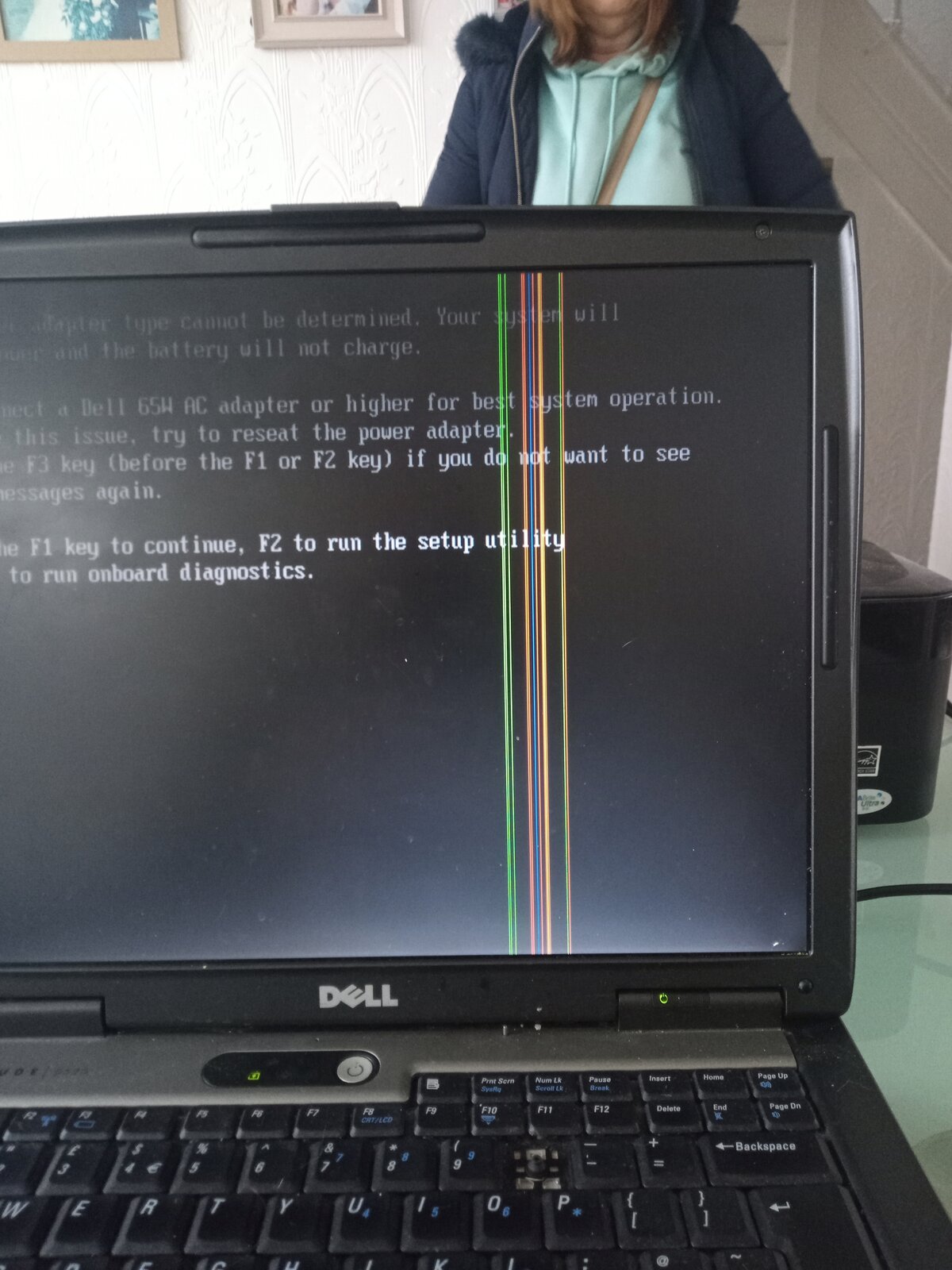

My old Dell laptop has some vertical lines running down the screen. I've got a couple of others for spares. Anybody know what I need to change? Thanks.

Inspect the LVDS cable.
It runs from the board to the screen.
Could be loose or may need a new one.

I'm afraid I can't add much about the screen, check cable connections etc, there are plenty of troubleshooting videos on YouTube.
Although given the laptops age, it may be worth gently checking the ribbon edge connection to the panel. Sometimes a little bit of pressure applied in the right place may get rid of the line, if you're lucky...
