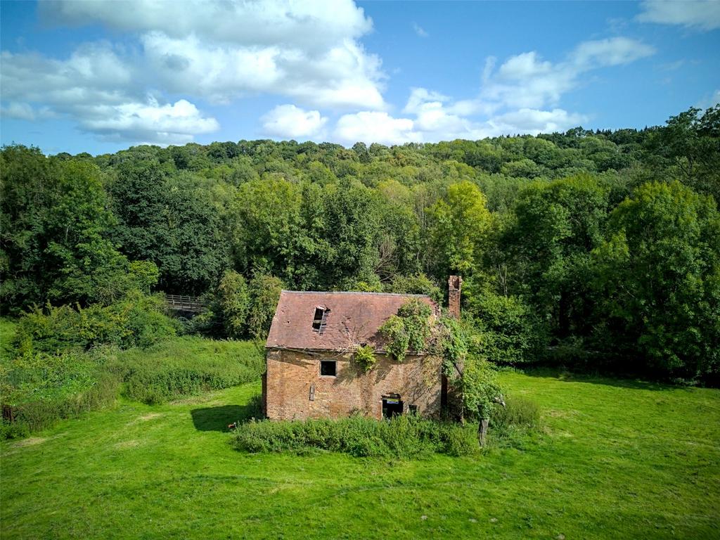

Getting tired of living in an urban environment and want to move away….. well away into the countryside with no neighbours!
In my search for an ideal property, I’ve found a derelict house for sale, with a tree growing inside it, in the middle of a couple of acres surrounded by woods and fields. I’ve had a variety of hearsay advice ranging from “there’s a building there so you can build something similar” to “as it’s been empty for many years, it’s lapsed it’s residential status so it’s now just like applying for planning in a field - no chance”.
It falls in Shropshire council which is a shame - seems like pre planning advice which is a 30 minute video call is gonna be £500. A shame because neighbouring Telford and Wrekin council do a free 15 minute call.
It’s really early stages and I just want a simple - Planning permission is likely to be granted if I’m sympathetic in renovation or new build or I’ve not got a hope in hells chance of getting it…. I can then move on to something less extreme. It may be telling that it does not have planning permission on the particulars.
Any ideas on how to get this basic info without half a grand down the swanny? I’ve been twisting my melon on planning portals and articles and have been trying to make permitted development class ZA fit!

One fundamental question seems to be when was it last occupied?
I had read the post mentioned above. All very interesting but not really what I wanted to hear. Leads me to think of flogging a dead horse. This property I’m interested in has not been lived in for either 50years or since 1950 - my misses can’t remember exactly what was said, but either way it’s over half a century! Plus it has a tree growing in it….. I’m posting the listing here, just so you can see why I’m very taken with this plot and feel I want to “explore till I’m sure”. If I could reinstate/rebuild similar, this is kind of what I’d imagine perfect for me. Don’t all start a bidding war now…. It could be a very pricey field for a horse.

Don't waste your money on pre application advice, you need to first establish if legally the housing use has been abandoned. If there is a tree growing through the roof that seems likely. Do you know when it was last lived in?
Only needs a lick of paint and some weed killer :LOL: although it might not be so idyllic when HS2 comes rolling past!
Either 50 years ago or 1950. My misses can’t remember exactly what the agent told her. But you get the idea, bloody ages ago!
