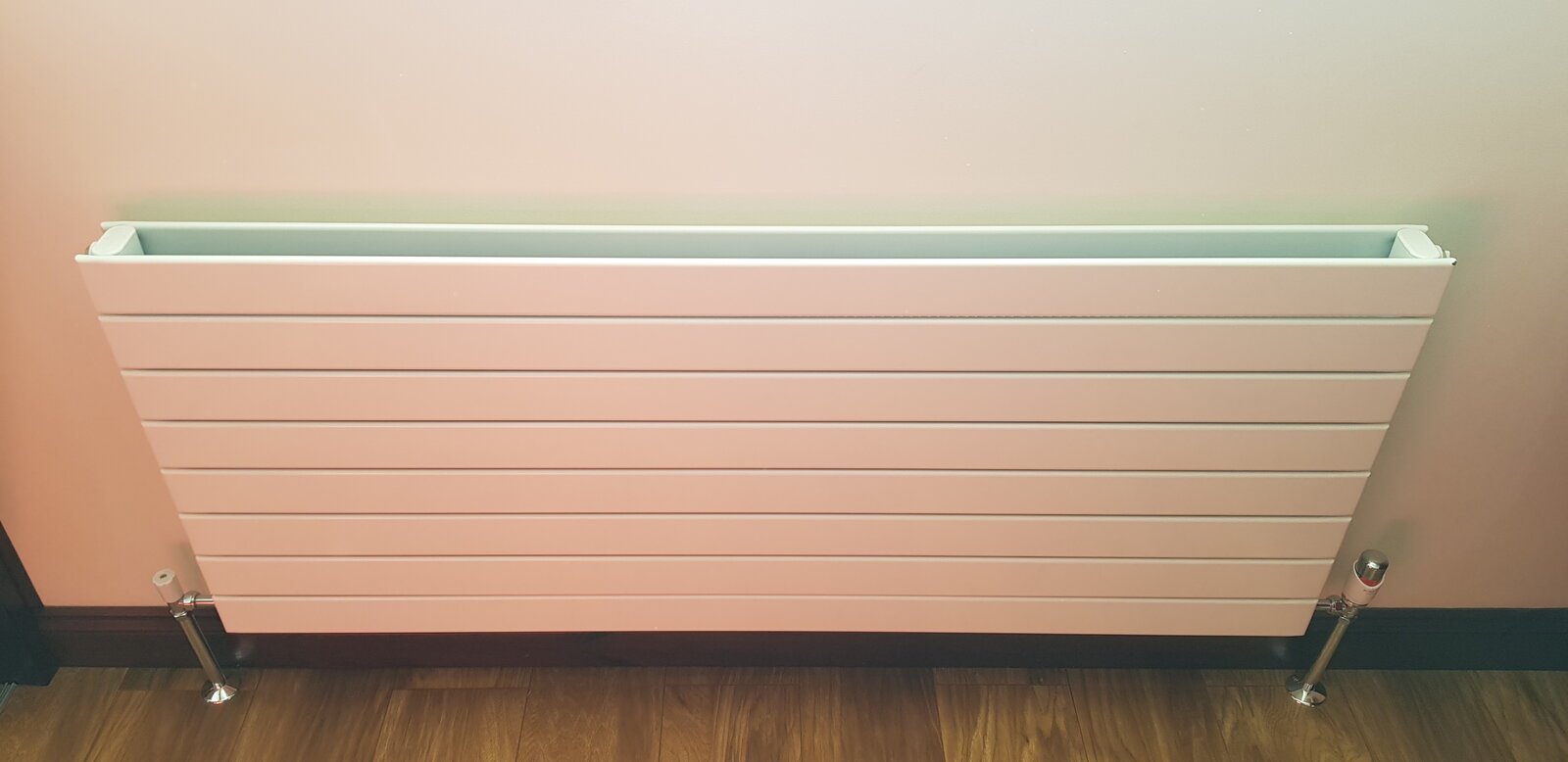

Hi everyone, I have a new horizontal designer radiator (boss asked for it) which is not getting warm at the centre bottom.
It's like hot water enters on the right, rises to the top 3 bars and then drops down to the left leaving a cold semicircle.
Plumber has been and said the diffuser in the radiator creates this problem and there's nothing we can do.

Is it possible that there's air trapped in the middle of the radiator?
It's on the flow.
The plumber even tried swapping pipes around but it's the same.
So he's put it back on the flow.
Sorry for the delay, here is the picture.
Flow on the right, return on the left
The bottom 3 bars are stone cold, the next 2 lukewarm and the rest hot.

As said we tried swapping flow and return and also removing the thermostatic valve.
Pin moves freely.
What do you think?

I have never seen a horizontal designer rad like that, all the ones I have seen have the bleed and blanking plug are on the top of the rad not on the side, are you sure that is not actually a vertical rad ?
Definitely sold as horizontal radiator.
Otherwise the valves would come out from top and bottom, me thinks.
