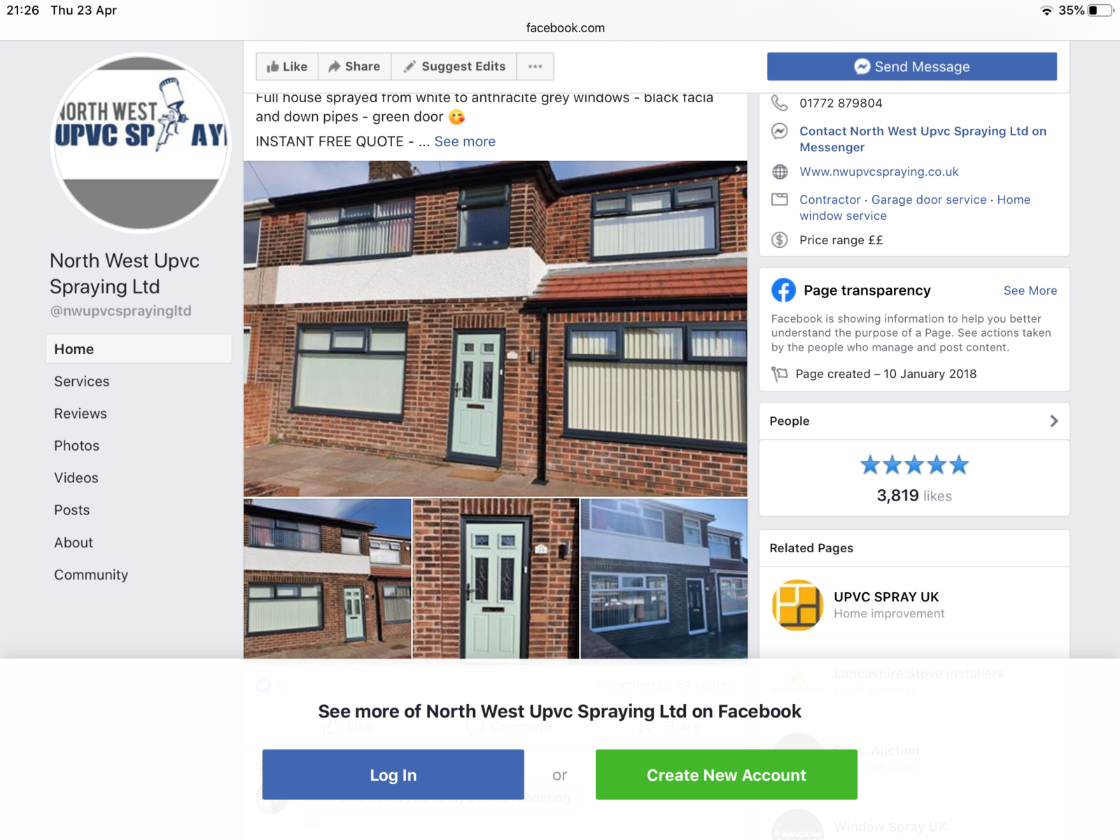

I would look at having them sprayed. Lots of options across the uk and now a quality recognised finish. I will forward a contact I have and check the system out
Hi Boggie, as promised there will be someone near you doing this. Hope this helps.
