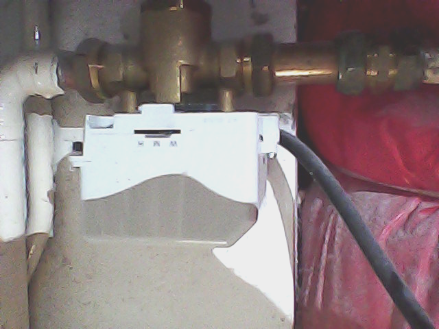

I had a look in the HW tank cupboard at a house today where I'm going to fit a bath tap/shower mixer set. I'd need to isolate the HW at the tank and CW at the main stop.
I presume the red Grundfos device is a HW pump to increase pressure.?
full
I'm mystified by the white plastic body device which has a cable feed. Can someone clue me in please?
full
Central heating pump and motorised mid position valve. You shouldn't have any dealings with either if you're only changing taps.
Are you doing this for a customer or to help a friend out?
Its my nephew's house. The tap set is an easy off with the old and on with the new. So long as I can isolate the HW, the CW off at the main stop.

Unless the photo is upside down, I believe the installation, actuator below valve, is incorrect.
I noticed the valve was upside down, or at least I noticed the letters were. Now I know what the valve does and how it does it.
Does the orientation of the valve effect performance? ....... its downstream from the pump also pictured.
As above. Motorised valves should never be fitted with the head below the valve, in case of leakage. Potential for electrocution in the event of a malfunction.
