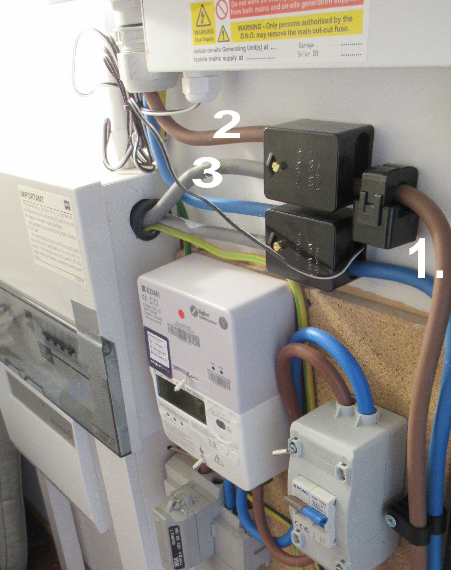

What I am wanting to do;
for the last 25 years I have kept a weekly record of my electric (and gas) use. I just like data (sad really but there we go)
We have just had solar fitted and it would appear that there is a lot of wastage in the generation, and battery storage, and it would appear that this is now presented as my own consumption. For example we typically use 90kWh a week, but in a week where we coulld be exporting 200+kWh in a week, my usage will appear something like 140kWh - all free but it is a false reflection on what we are using
In the picture below; 1 is the Grid, 2 is the connection to the Inverter, and 3 is the connection to the consumer unit
My usage data now comes from the Inverter and is clearly including all the losses - would putting some sort of device on 3 give me my true usage which would be comparable to pre solar ?
I see the installers have put some sort of device on the Grid side that communicates with the inverter - could I do something similar on the meter side?

"True Usage" is the kWh we use to power our house (everything that flows through the consumer unit. In the 25 years up to solar I have just read the meter reading every week.
But since solar panels very little power comes through the supply meter (400Wh last week) and the data I can access from my inverter is considerably higher than my normal use as it accounts for all the waste and inefficiencies.
I am hoping if I attach a meter at position 3 (see image above) then I would get the true figure of the power we are actually using.

Shelley EM will do it. Pretty cheap. Yes, put a CT clamp on (3) to measure your consumption.
You can probably derive this figure from your inverter as it already knows (1) and (2).
IF, as seems to be the case, only the energy representing your total usage goes to the CU, then, yes, a measurement at '3' would give your total usage - which, as above, should be equal to the total inverter output (which I suspect is what is being reported to you) MINUS whatever had been exported.
However, as I've implied above, I'm not really sure how that information/data is going to help you very much.

Indeed. As you proposed, just monitor the energy in the tail entering your CU (your "3") and find out what your true consumption ('obvious sense'!) actually is !
Beware that the clip on sensors can only monitor current, but one needs to also know voltage to calculate kWh. Some of the monitors have a connection to the mains so that they constantly monitor voltage in real time, and hence do the calculations accurately - and that's what you really need. Others (probably the majority, certainly of the cheaper ones) do not/cannot measure voltage but have to be programmed with a 'fixed' figure for voltage by the user - that is obviously less accurate and cannot take into account the variations in voltage which happen all the time.
