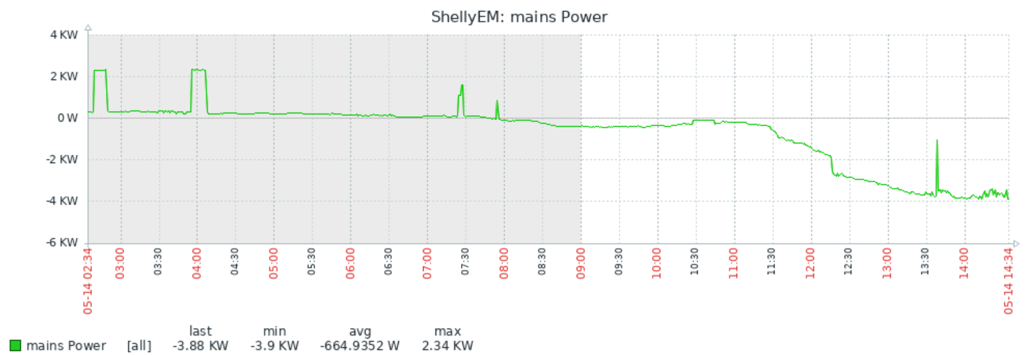

Reality is otherwise. I wouldn't have suggested Shelly EM if it couldn't distinguish which direction.

If that were true then it would have been pretty misleading of me not to mention that I have different clamps on my "import" and "export" cables [whatever those are], wouldn't it? For the avoidance of doubt, I have a [one] clamp around the L after the meter and that's what the graph is showing.

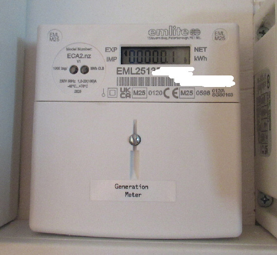

Anyway - back to metering my usage. Sill me I found a new meter amongst all the other new stuff in the cupboard under the stairs

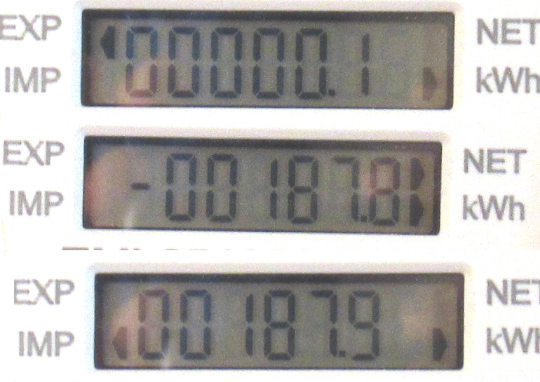

and this I believe ells me what I want to know, the display scrolls through these displays
EXPORTED
Nett Export
HOW MUCH I HAVE USED
Have been watching the bottom figure this past few days and comparing it against the nonsense from the GROWATT dashboard
Main Meter is the Electric Boards meter
Generation meter being the one shown Above
Growatt Meter being the misleading figure
I am very happy the generation meter is showing my true usage
